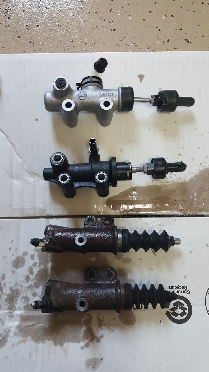

    Before I replaced my master and slave cylinder I had a creak that was solved with a silicone spray. Since I've installed the new setup it has been quiet as a mouse. The new master is solid steel instead of plastic which I thought was a nice upgrade, should have been that way from the get go! 20170904_081733.jpg

    I don’t believe my creaky soundness is internal to the master/slave because I have been able to temporarily remediate it with a dab of grease of the slave cylinder rod to clutch release fork contact point. It’s just rust and binding on that contact point. Grease works, just temporarily.
