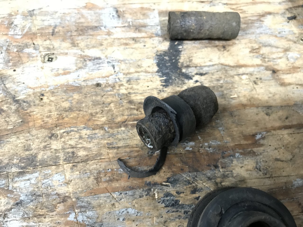

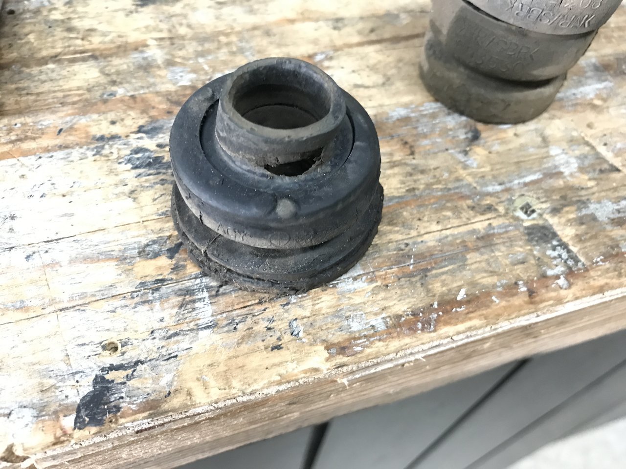

    UPDATE:
    Just returned from the dealer minus my truck. Front body mounts are bad. The tech advised that over the last few months he has replace 8 sets on 2017 2x4's and 4x4's. He believes that a TSB is coming.
    He used the terms "frame horn" or "radiator mounts" are bad.

    That the mount right behind the front tires?
  19. Mar 6, 2018 at 8:53 AM
    #59
    Northern Taco
    Northern Taco Well-Known Member
    Oct 8, 2015
    #166156
    2,816
    2022 Tacoma trd off road premium 2023 tundra trd off road
    Under rad support. In front of tires
