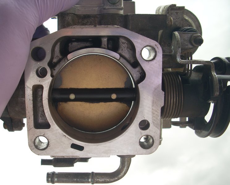

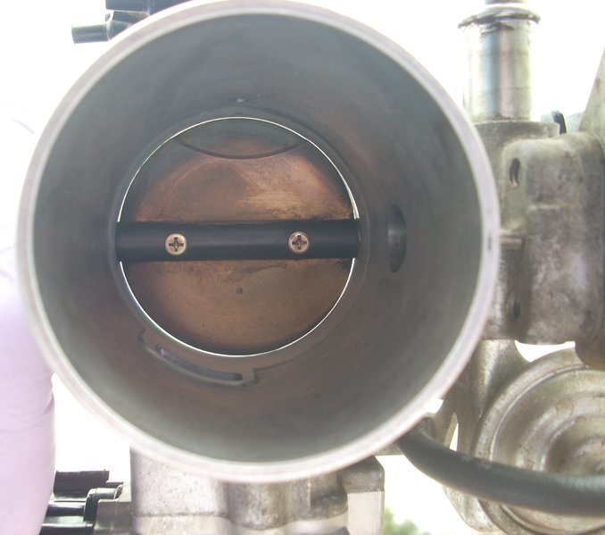

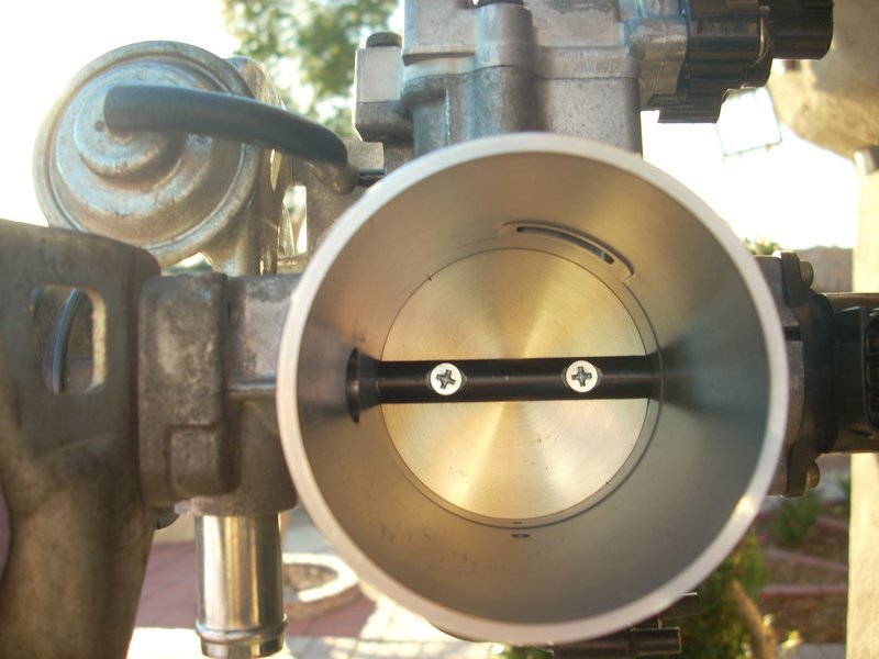

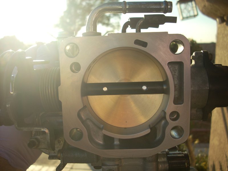

    I got a manual transmission base cab 2001 Tacoma 4 cylinder 2.4L engine that was running bad with a surging idle and also a surge in acceleration between gears. The truck has about 206,000 miles. What I mean by a surging idle is how it would rhythmically idle low at a less than 1,000 rpm and then surge to about 1,500 to 2,000 rpm. When I drove it the truck would surge in acceleration when shifting between gears.
    The first thing I to correct the problem was to thoroughly clean the idle air control (IAC) and the throttle body with carburetor cleaner and a rag. The throttle body was gummed up with a bunch of slimy gooey dark crap. Although I cleaned it pretty well, it did not fix the unsteady and surging idle. In fact, it idled faster. So the next thing I did was buy a new idle air control (IAC), which did not fix the problem. After that I cleaned the mass air flow (MAF) sensor and it did not help so I put in a new one. This was also to no avail, so I also sprayed carburetor cleaner on all of the vacuum hoses to look for a vacuum leak, which I did not find any. I then put the truck in two auto repair shops and multiple professional mechanics could not resolve the problem. The truck was now idling at about 4,000 RPM!
    After all this I was about ready to give up and then I examined the throttle body butterfly and noticed that there was a significant gap around it, which probably explained why it was idling so fast. [Yes I cleaned the TB pretty well, but my cleaning removed a ring of gum around the butterfly that was limiting a lean air/fuel mixture.] I was tehn tempted to buy a whole new (used) throttle body, but a replacement was about $150 and did not look much better than what I already had (dirty & gummy butterfly valve).
    I then discovered a website called Maxbore.com that re-bores throttle body's and fabricates a new butterfly valve for any TB.
    Any way, I shipped my throttle body to this Maxbore guy in Florida and he re-bored my throttle body and made a new butterfly valve for it. I got the TB back today and installed it and the fast idle and idle surge problem is now resolved.
    I'm passing this information on because this whole ordeal was very costly for me because I bought parts that I did not need and paid for mechanics to help try to diagnose the problem, which they failed to do. All I really needed all along was to send my TB to Florida for repair, which took less than a week and cost a total of $125.
    Enclosed is some photos showing the before and after TB butterfly.
