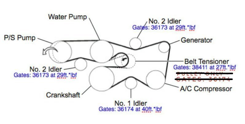

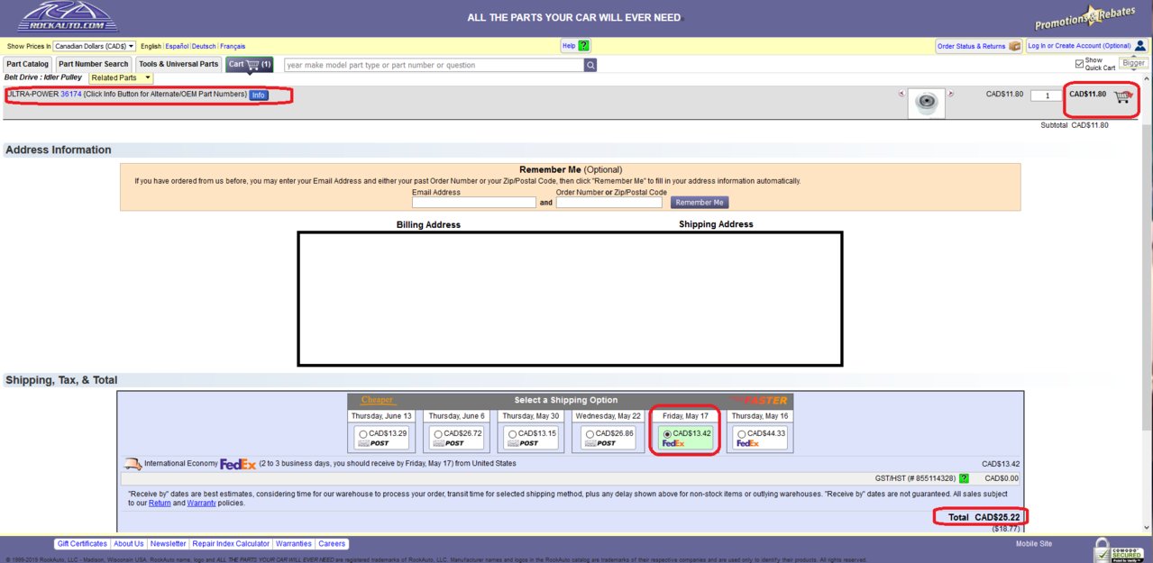

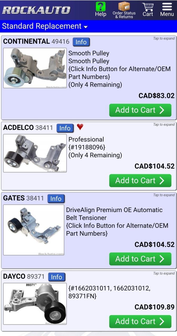

    Also any links to the belt tensioner and just the bearing? I'm not finding anything on rock auto
