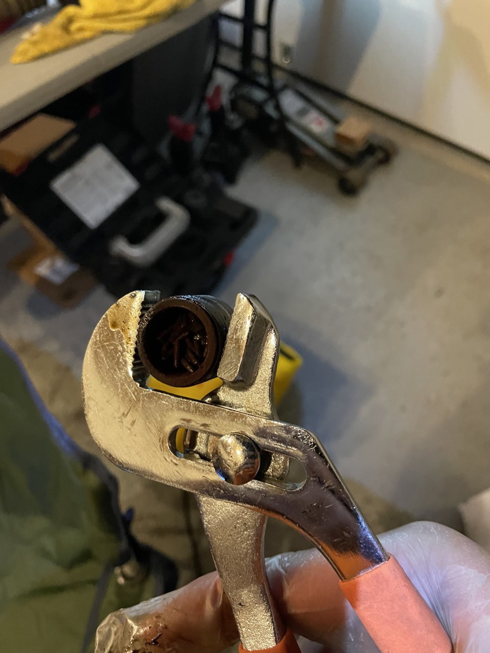

    I am unable to push grease through the rear zerk/u joint. I was able to grease the front and middle of the rear drive shaft no problem. I would assume with this many miles, it may be wise to just replace all the U joints while I replace the carrier bearing. Or am I missing something - I pushed the ball bearing at the zerk fitting, and it does go in just fine, but the grease will not pump through.

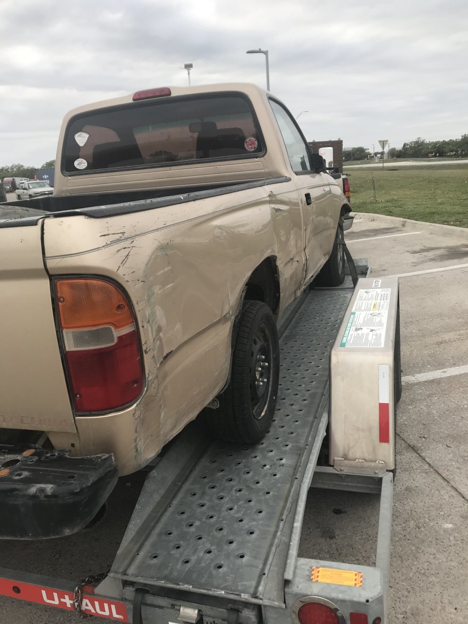

    EC5EB885-B097-49F9-B85F-517E6500D521.jpg:Clapped out. I wouldn’t be too hard on the original owner..your truck is far from clapped out! Pretty much standard maintenance items for a 150000 mile truck.

    For my future reference: mark all yokes, splines, driveshaft alignment. I went to turn the driveshaft to get an angle on the nut, and nearly lost the alignment.
    Insert the u joints prior to tapping in the bearings. Youtube videos show tapping in a bearing slightly, then the u joint. I actually had to bang one back out to make the u joint fit. That wasn’t good.
    Crows feet aren’t necessary, wobble extensions did not work for me. Short socket 14mm and an elbow joint to the torque wrench worked perfectly.
