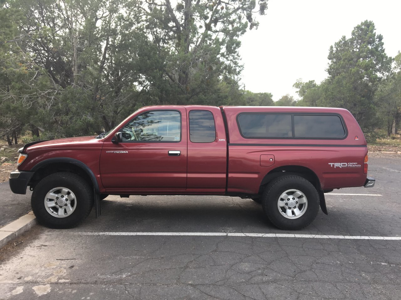

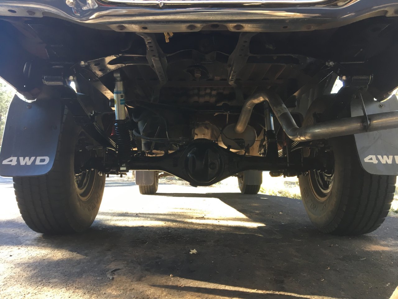

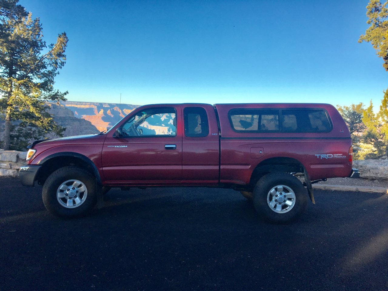

    Another successful General Springs HD install with all new GS hardware.
    Before
    After
    Install was easy. The u bolts from general were too long for my liking so I trimmed about 3/4” off. These u bolts and nuts look to be better quality over stock. The shackles, bushings and bolts all worked great. I also installed billy 5100s with the springs. Stock springs frowned. New springs smile. So far only a 10 mile test ride. I sense a little vibration at low speeds. I’m sure this will settle as the springs do.

    Looks great!:cheers: It's crazy how you get used to the saggy rear end look, and then when you finally replace the leafs it's like "whoa, it looks like a truck again."
