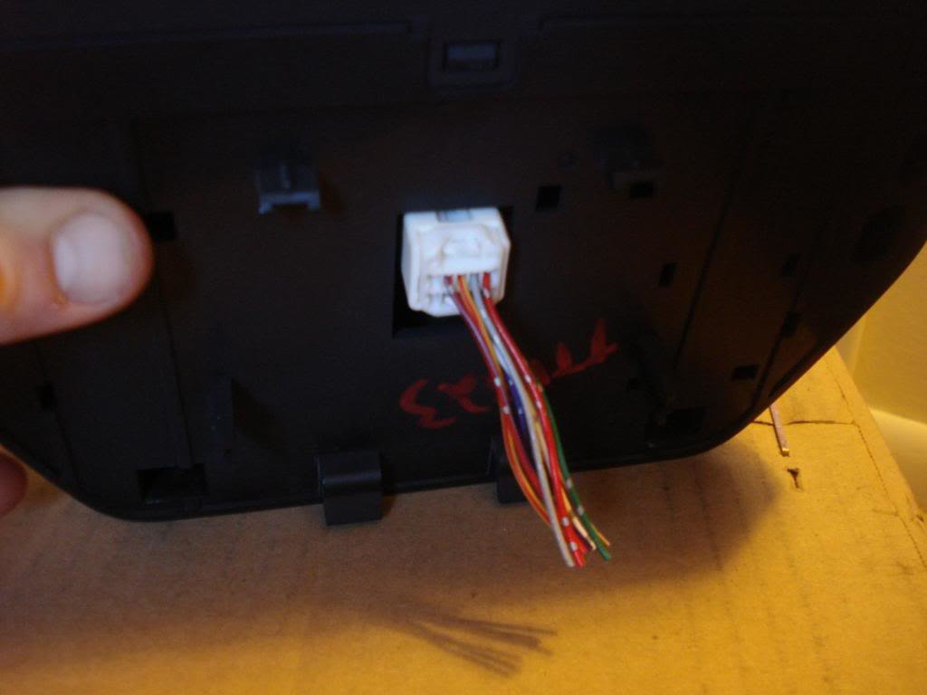

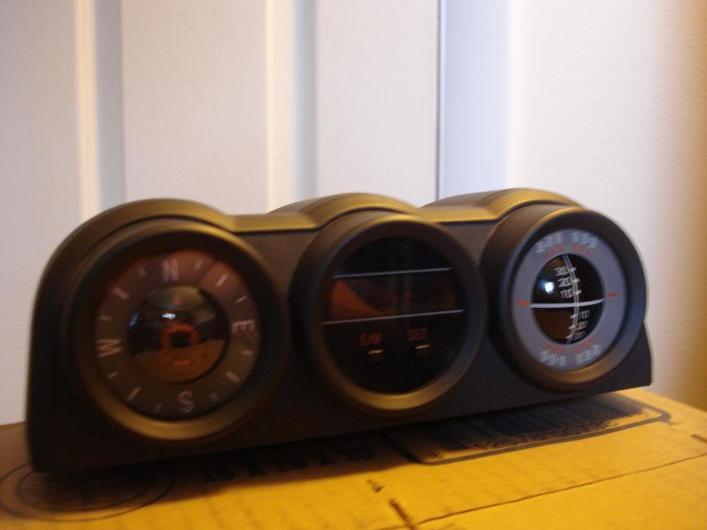

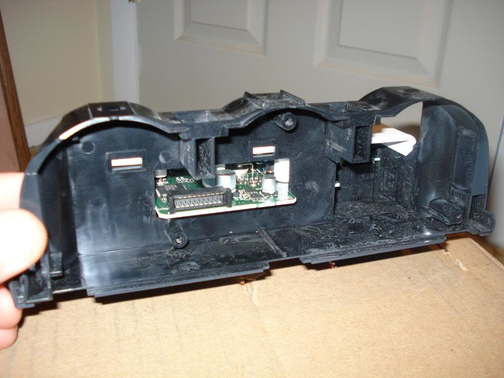

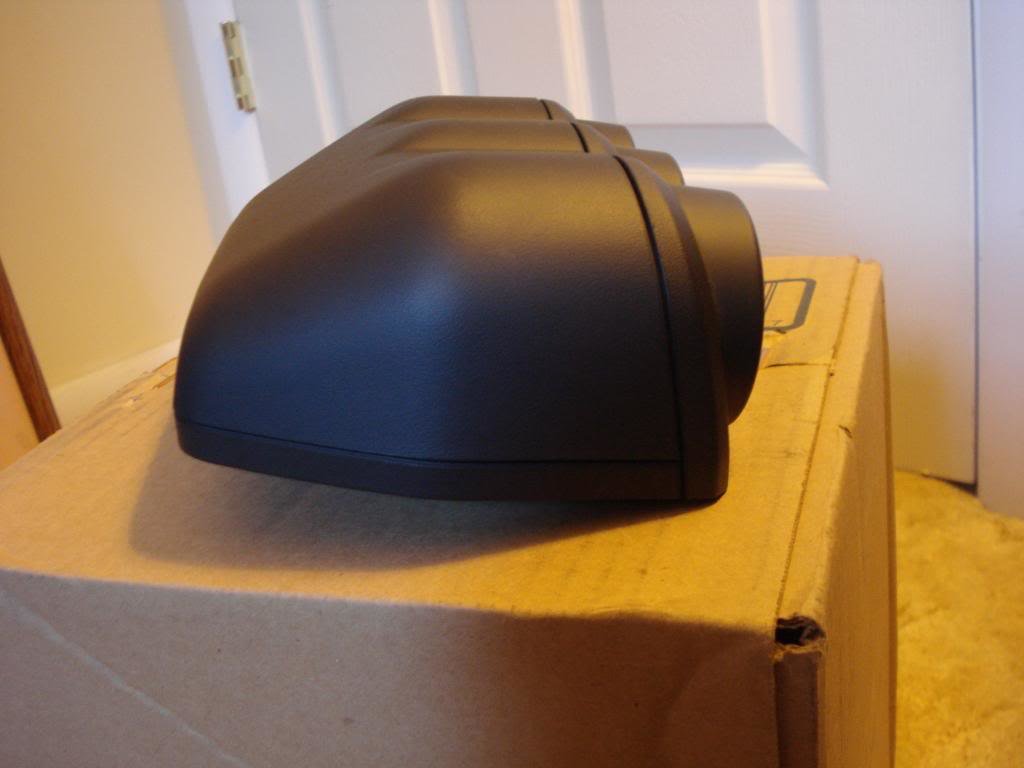

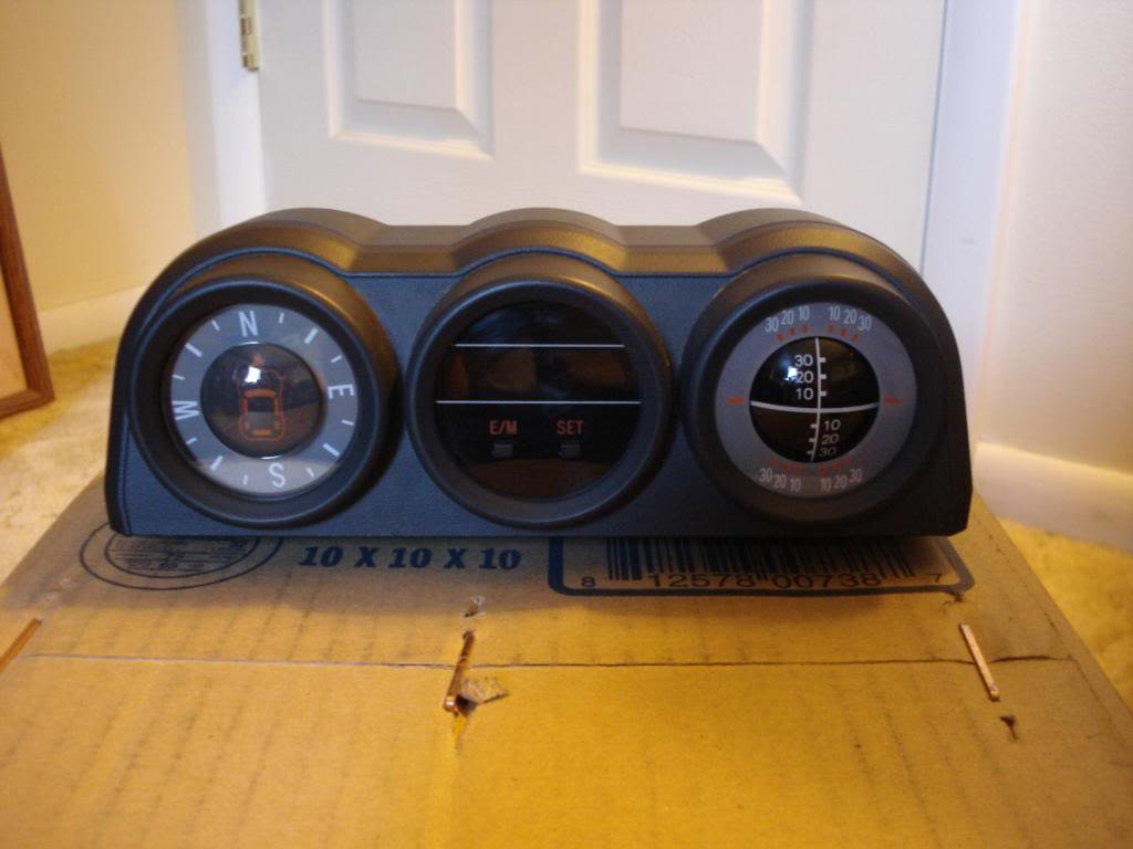

    So, 6shooter (TN member. Don't know if he was ever on here) put one of these in his truck... back when he had his truck. I've been wanting to put one in my truck ever since I saw the idea. Why you ask.... just because I think it's cool. I need to figure out the wiring schematics for it and I'm gonna try and get ahold of 6shooter and see if he's willing to give me some information. I was gonna try and modify the pod and replace the center thermometer gauge with something custom... but after taking it apart, that may not be possible. Here's some pics for you guys so you can check it out.
    [​IMG]This image has been resized. Click this bar to view the full image.DSC02450_4e1fa5754a825e49e40f781a3e7acfa25dfc6d84.jpg
    [​IMG]This image has been resized. Click this bar to view the full image.DSC02453_5d897ea9de9a5f33a6f356fdcc80309c8547bf65.jpg
    [​IMG]This image has been resized. Click this bar to view the full image.DSC02454_63ae3884d453b86f9387b64a26c3aee43e78650b.jpg
    [​IMG]This image has been resized. Click this bar to view the full image.DSC02455_bc0707f2d86b07b8723855d863856d3901937e0b.jpg
    [​IMG]This image has been resized. Click this bar to view the full image.DSC02459_1af5bbe5ccc74c07b365b14092954f4b0bdcc460.jpg
    [​IMG]This image has been resized. Click this bar to view the full image.DSC02460_b182984bf768d2fdfb20ce933bfe0a46b0e7cb10.jpg

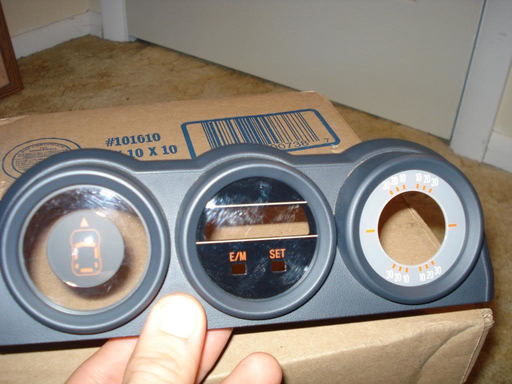

    [​IMG]This image has been resized. Click this bar to view the full image.DSC02461_f45e070f904a336f94d00baf22011a8e6e510efb.jpg
    [​IMG]This image has been resized. Click this bar to view the full image.DSC02457_c6212f512de88507e88e41ccb91a0568d25c8726.jpg

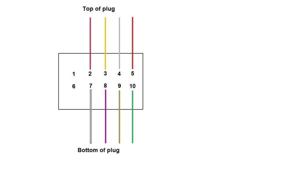

    here's a pic I made of the plug:
    [​IMG]This image has been resized. Click this bar to view the full image.FJInclinometerPlug_e94ca56db4c96440229b56578fd454610f5129e2.jpg
    top row of wires: red w/blue tracer, yellow w/red tracer, solid gray, solid red.
    bottom row of wires: white w/black tracer, purple w/red tracer, brown w/white tracer, solid green.
    not sure when I'll get this in or if I'll keep it stock or mod it, but wanted you guys to maybe give some input and thoughts.

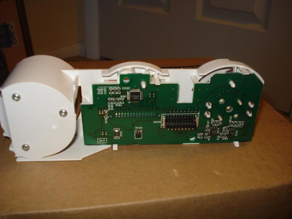

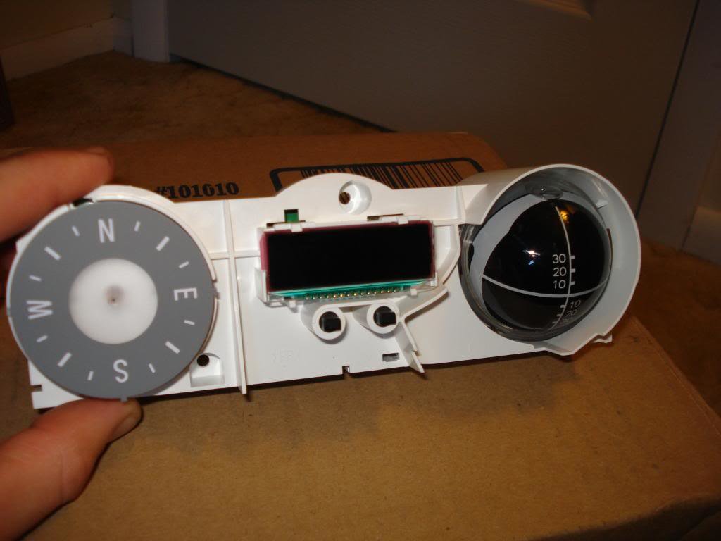

    ya, i know 6 was having quite the time with it. the inclinometer is "freestanding". it acts just like a plain level. the wiring is all for the illumination of the gauges, the thermometer, and the compass. the compass doesn't just work by a magnet. there is wiring and a circuit board involved.

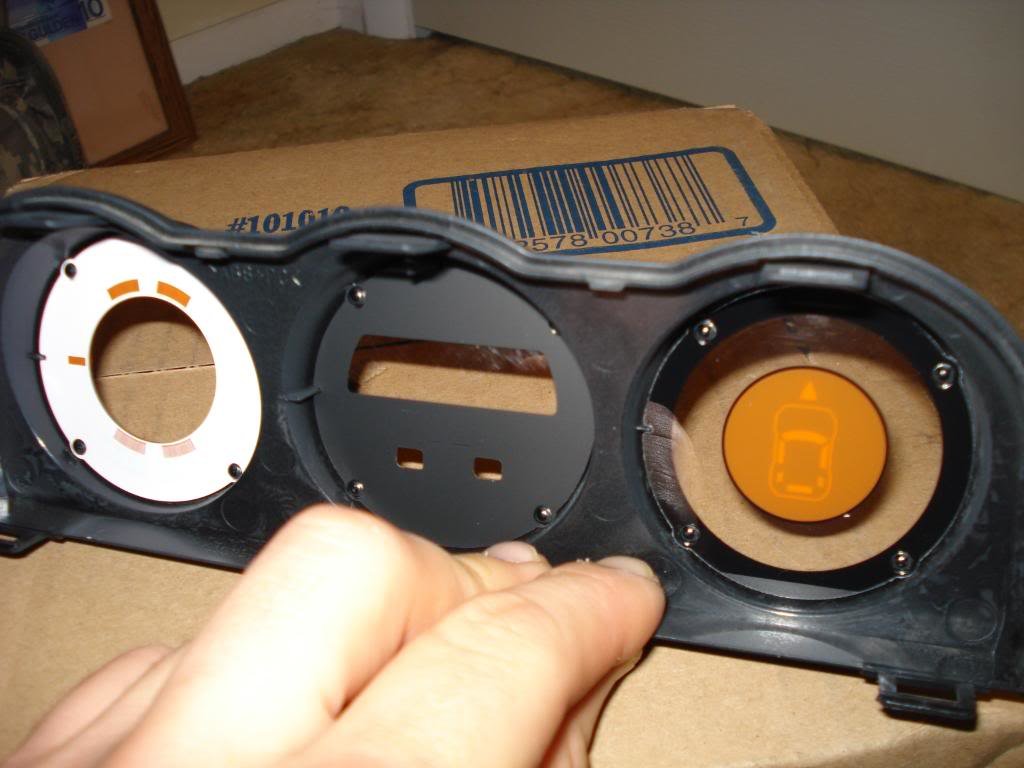

    here's pics of the face plate that ppl want to see.
    as you can see.... if you want to replace or mod any of the gauges some modding would have to be done to the plastic faces. the gauge sizes are about 1-15/16" to 2". if anyone was to replace these gauges a 2-1/16" gauge could possibly work, but definitely not a 60mm.
    the only problem 6 had was getting the thermometer to work. he said the compass and illumination were no problem.
