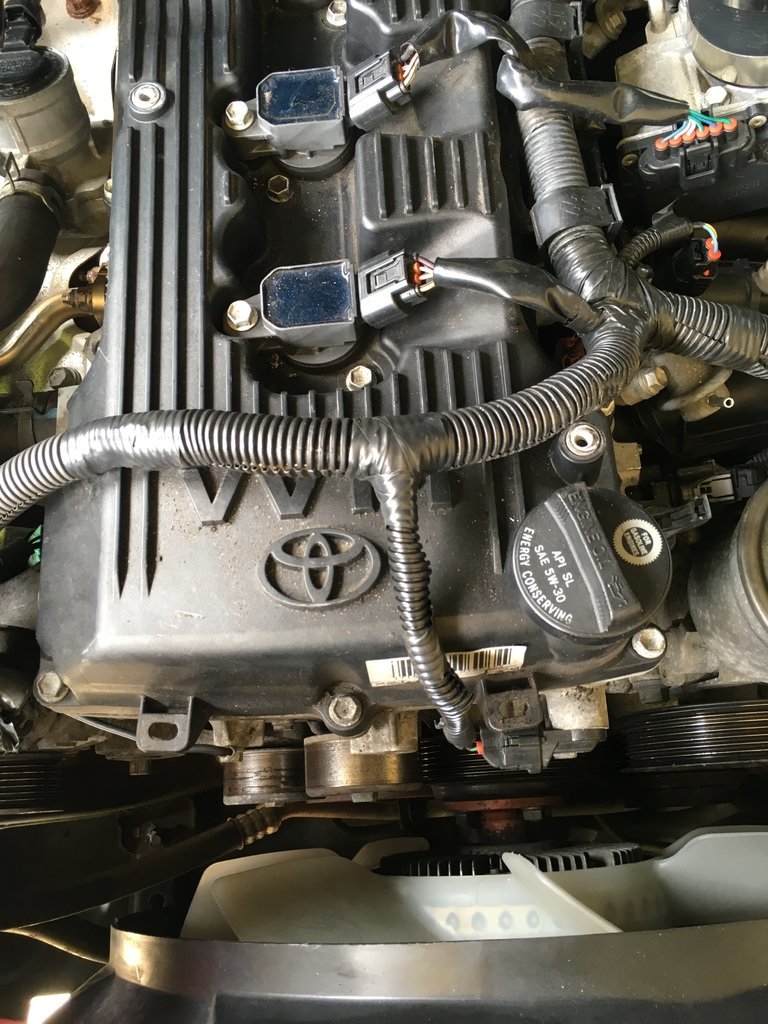

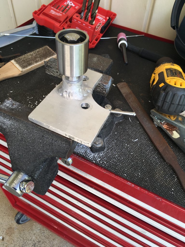

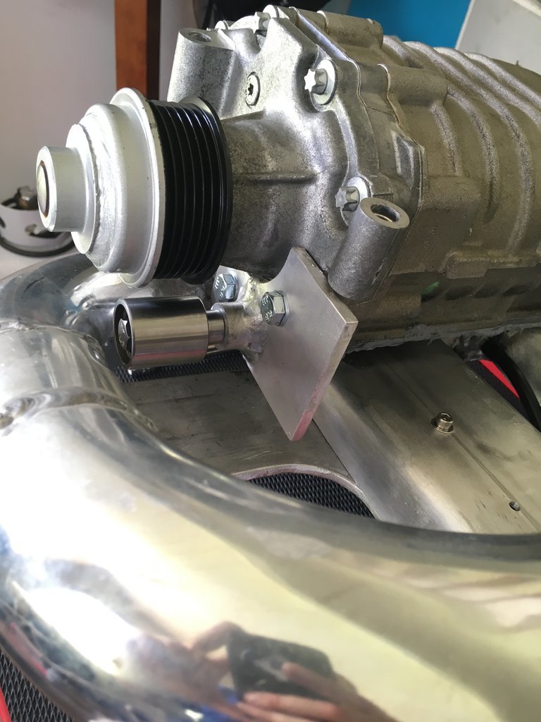

  9. Oct 21, 2017 at 10:15 PM
    #29
    05Taco4x4
    05Taco4x4 [OP] ToyotaHubs
    Jun 29, 2011
    #59085
    6,244
    2TR-FE Enthusiast
    FJ Tcase, Manual Hubs, 2017 Head unit, Mirror Riser

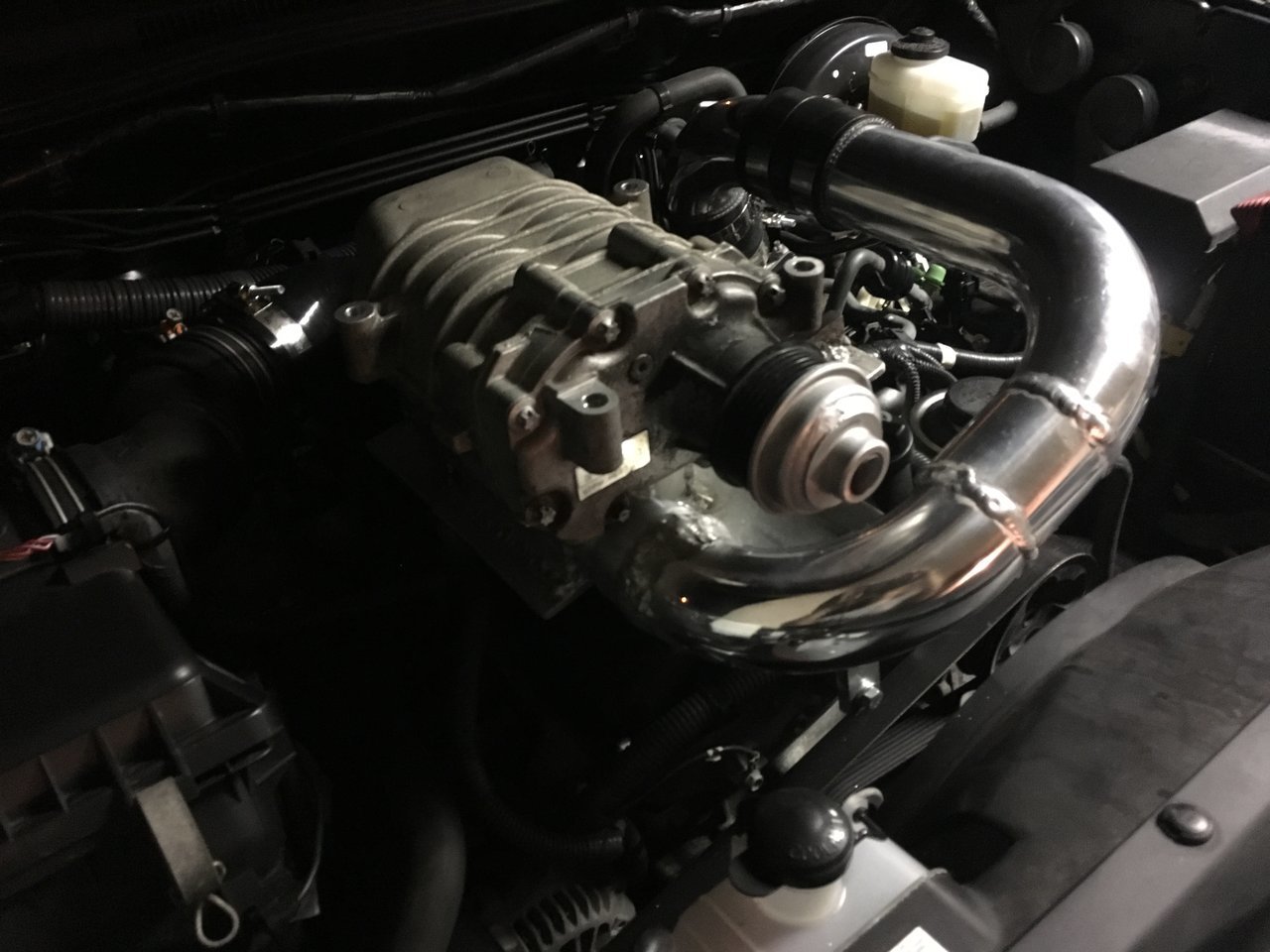

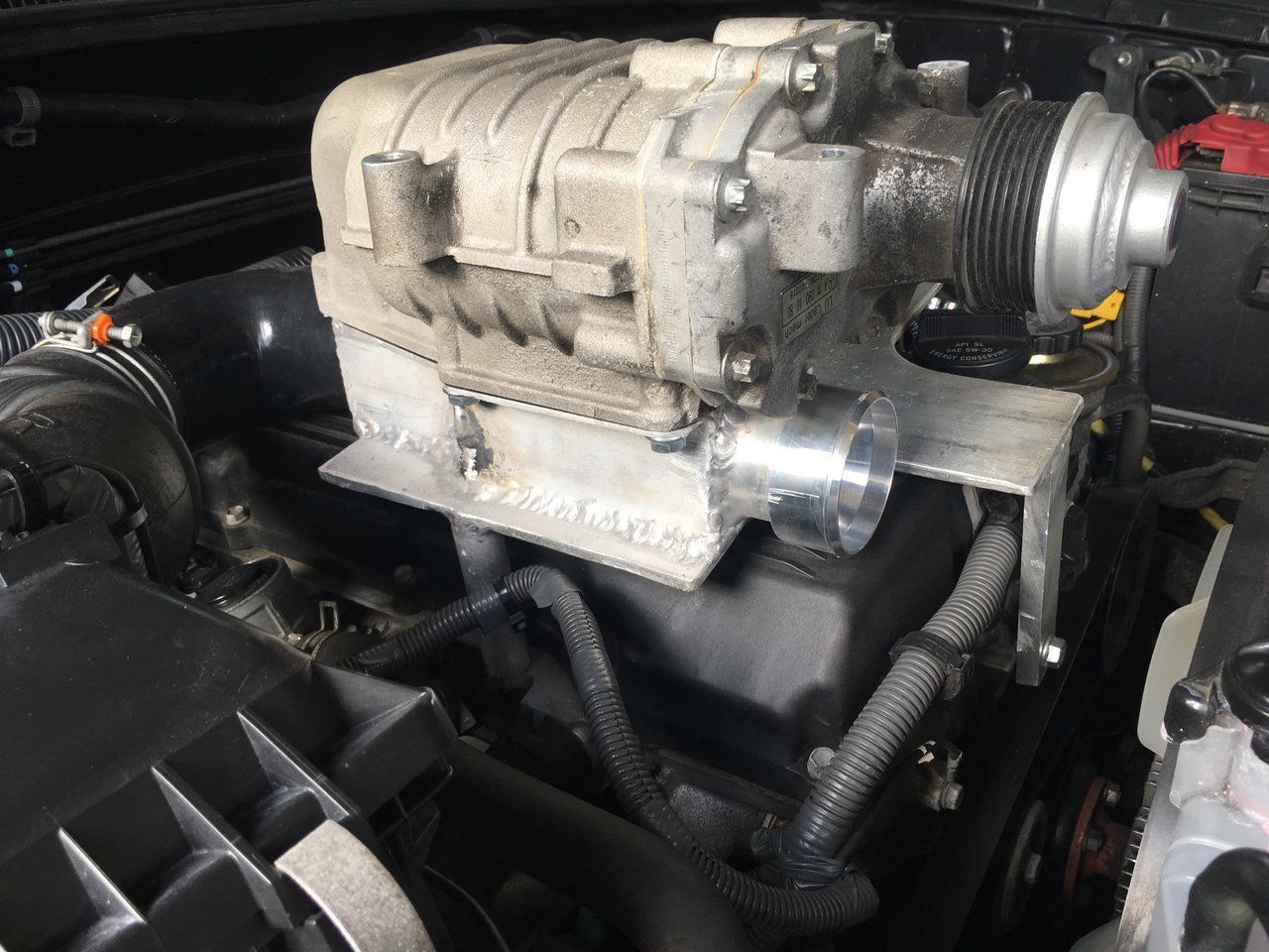

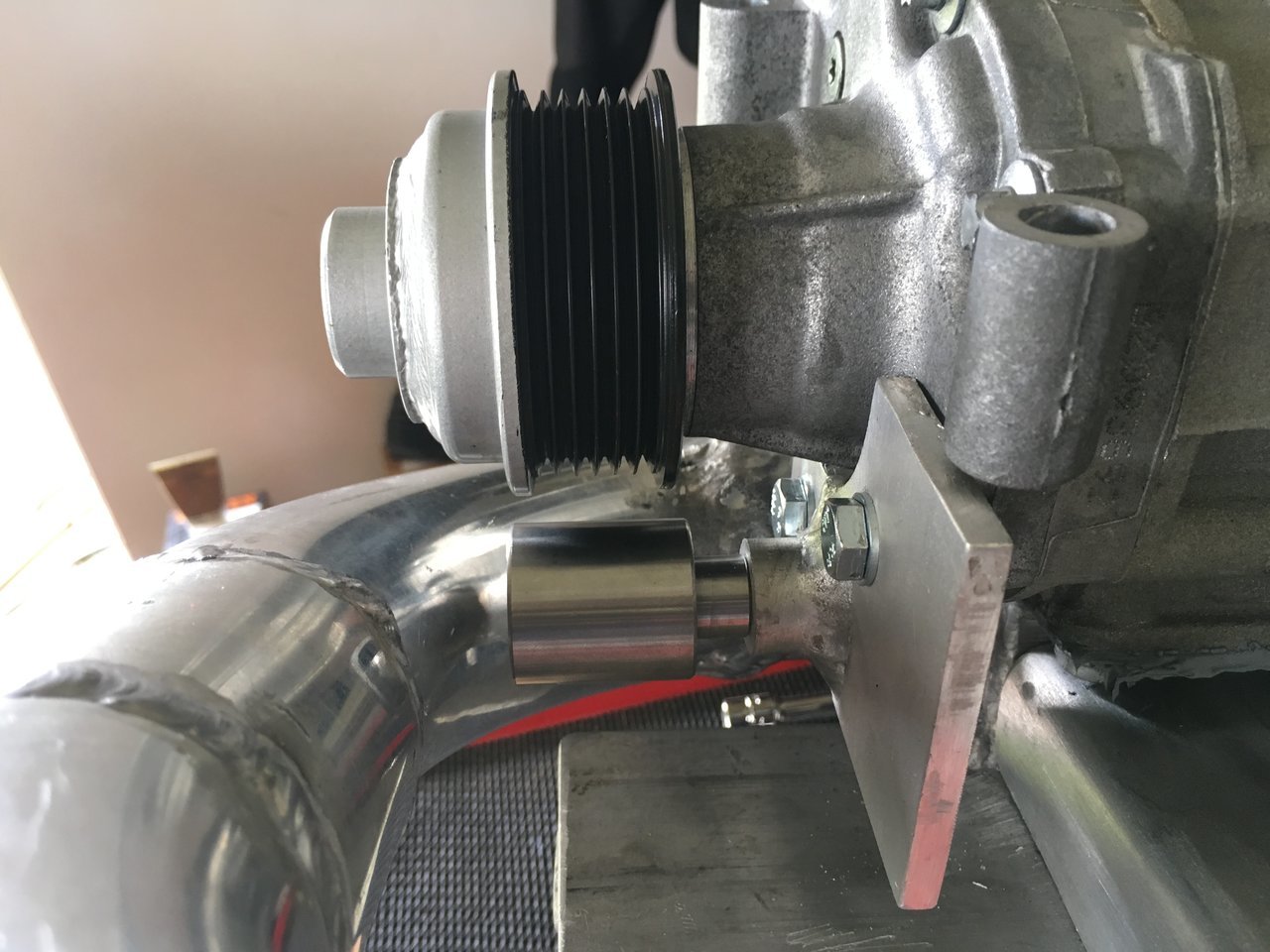

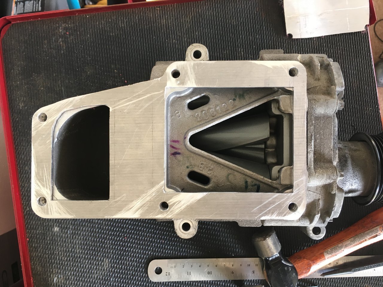

    I had belt slip, so I added a pulley.
    The new belt route made it necessary to move the harness under the SC.
    Sae68 and ChadsPride like this.

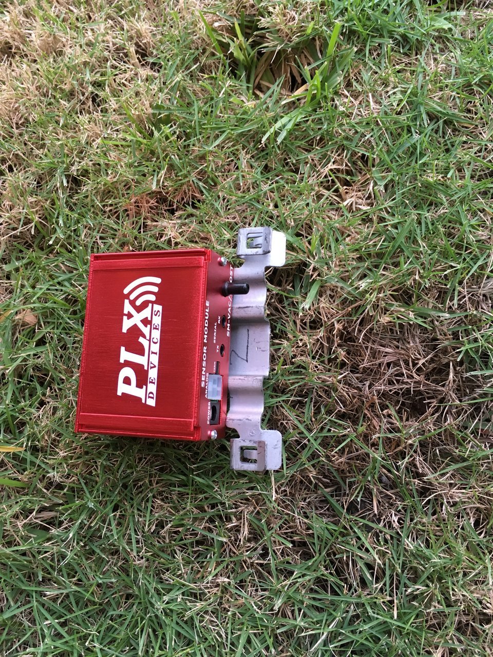

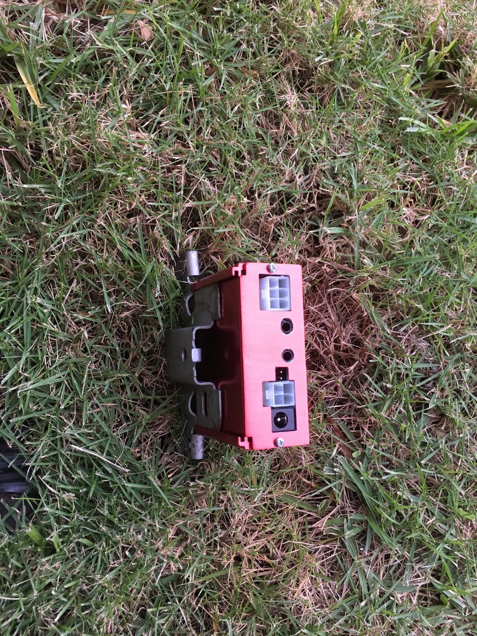

  10. Oct 26, 2017 at 7:04 AM
    #30
    05Taco4x4
    Jun 29, 2011
    #59085
    6,244
    2TR-FE Enthusiast
    I installed PLX AFR and VAC/Boost sensors. It’s displayed via Bluetooth to their MultiGauge app. I combined the two into one- the VAC/Boost backplate became the AFR faceplate with the help of a coping saw and file.

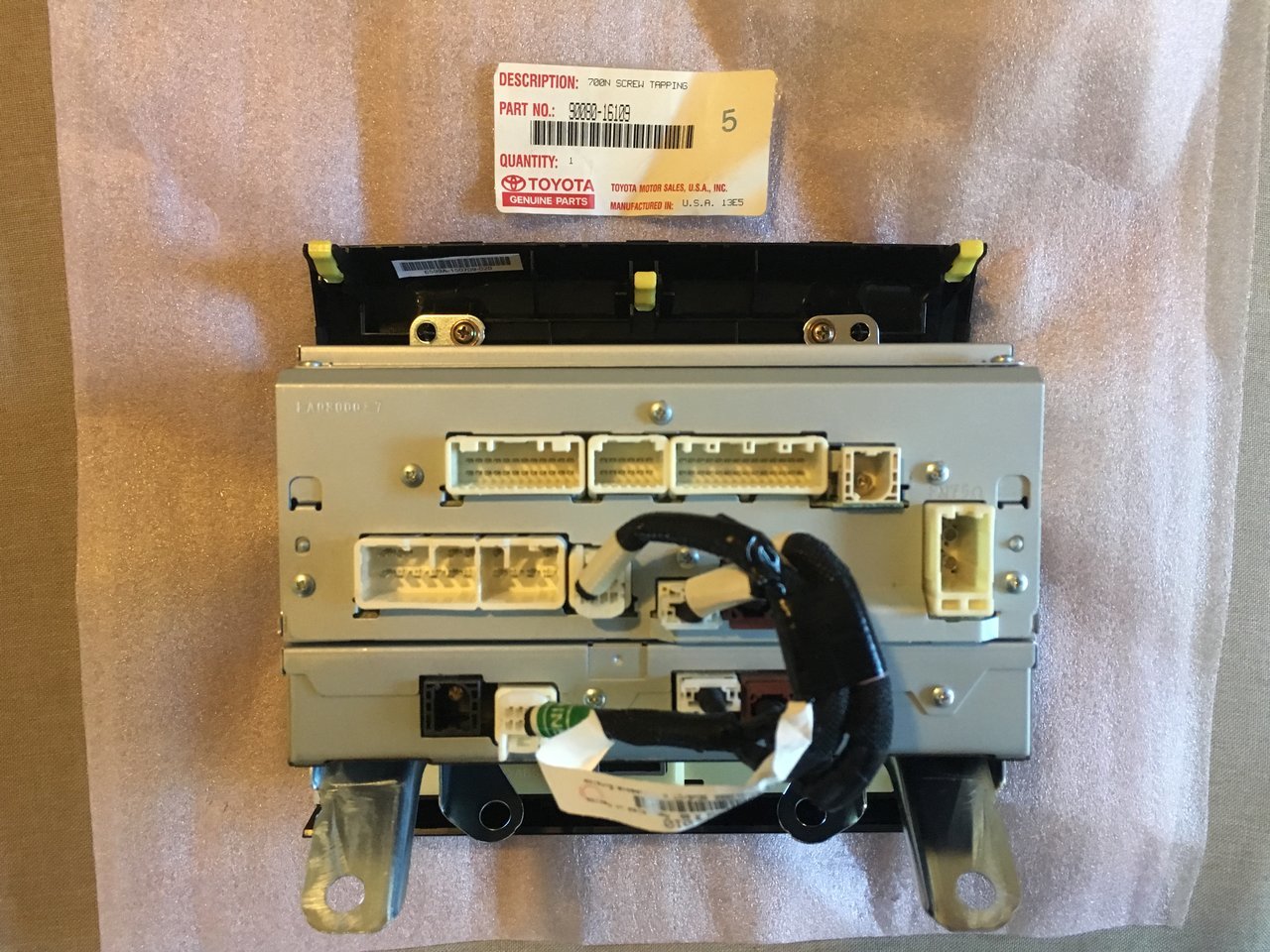

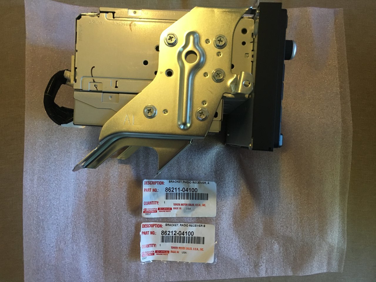

  15. Dec 30, 2017 at 6:09 PM
    #35
    05Taco4x4
    Jun 29, 2011
    #59085
    6,244
    2TR-FE Enthusiast

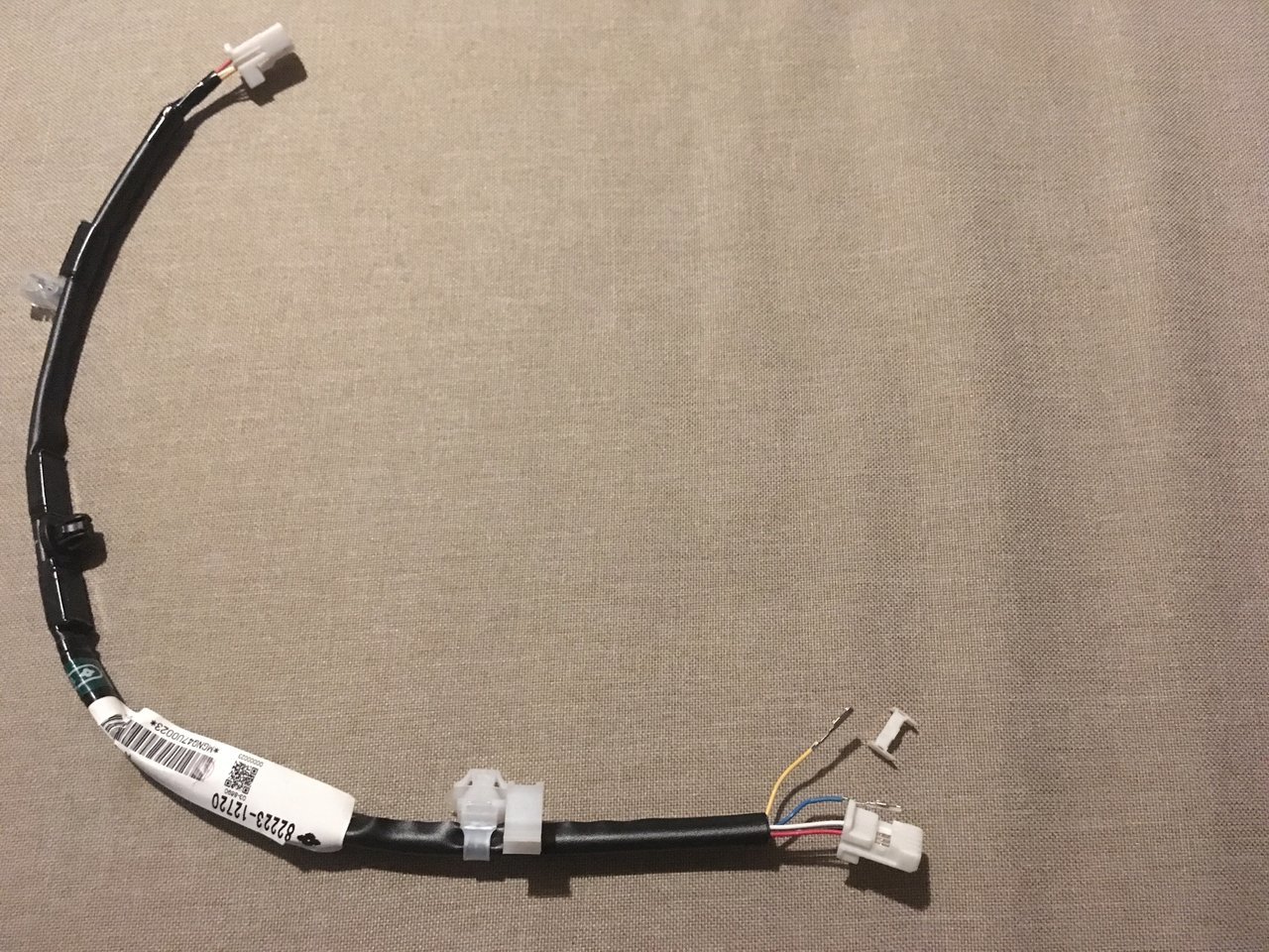

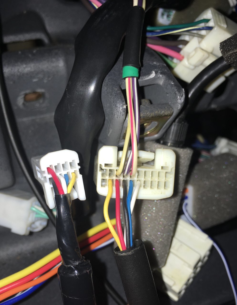

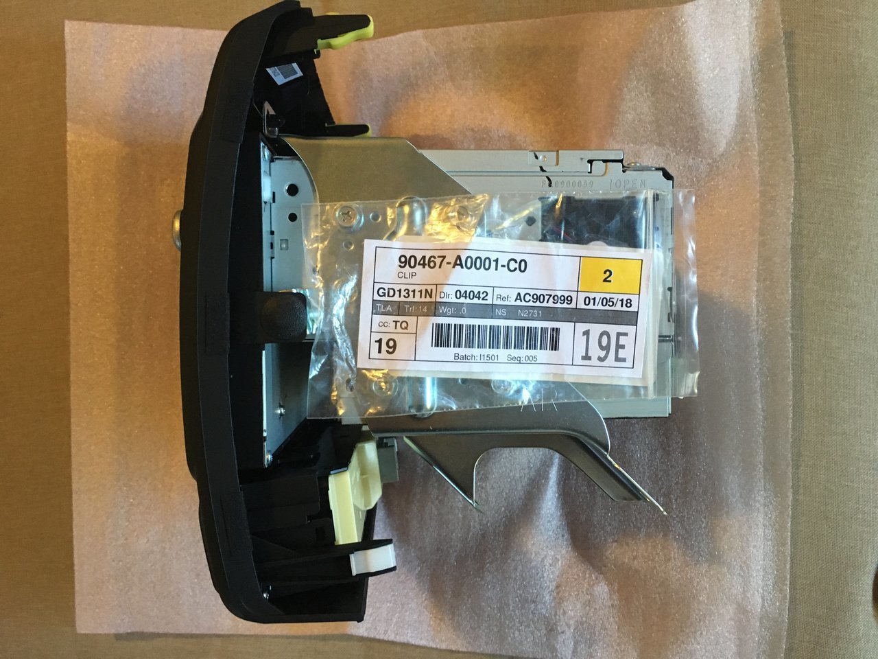

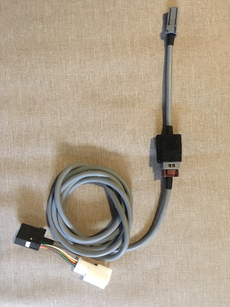

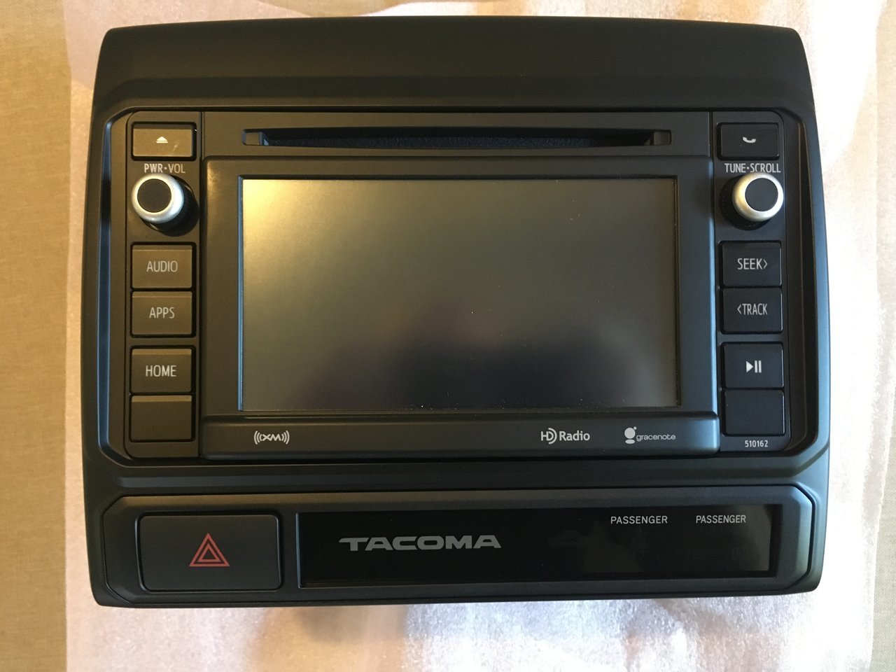

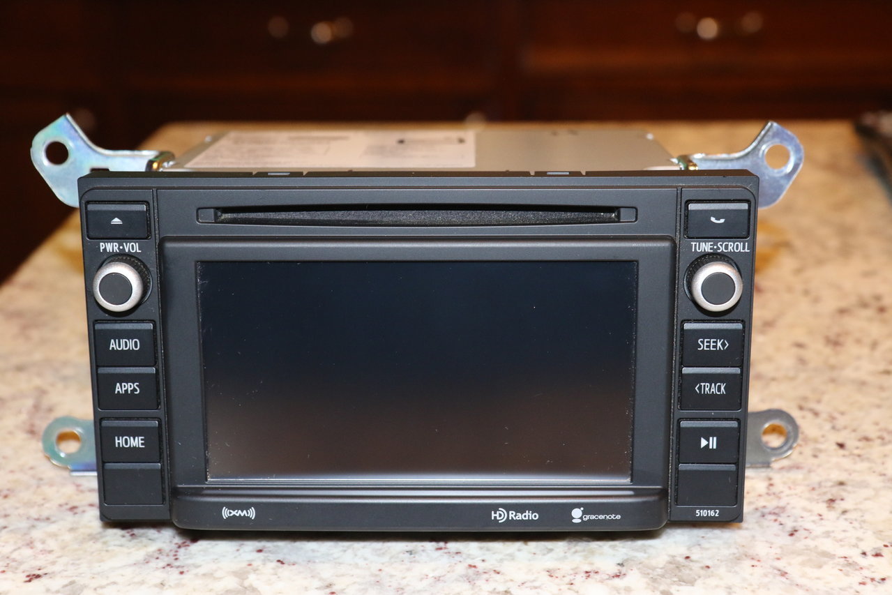

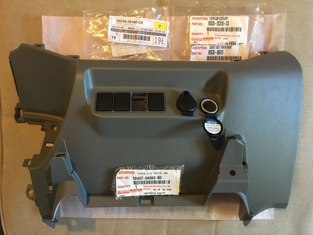

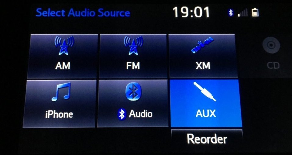

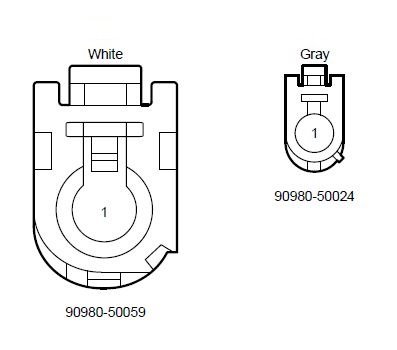

    Audio and Dash Update
    2017 Entune Radio
    XM and Scout Nav
    Audio Wire Harness Kit
    PT546-00142
    Antenna Converter
    PT546-00120-AD
    Harness Converter
    PT546-00120-CH
    USB Conversion
    PT546-00120-US
    Microphone
    PT546-NU160
    Navigation
    Antenna
    PT545-00100-AT
    Antenna Adapter
    86808-02070
    Sirius XM
    Antenna
    PT546-21110-AK​

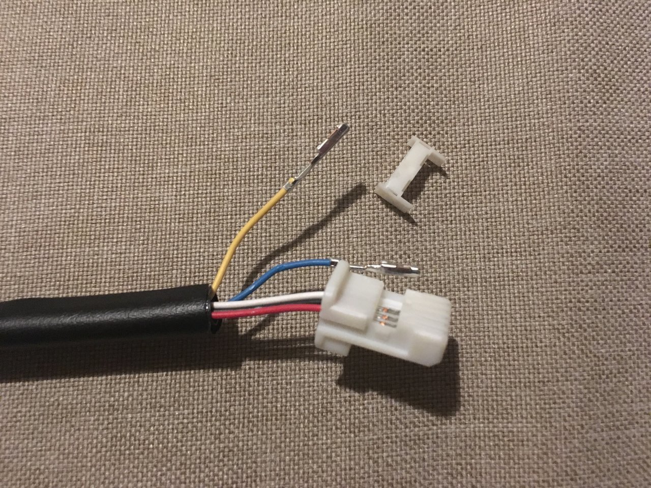

    USB / AUX
    USB Harness
    PT233-47100-WH
    Auxiliary/USB Jack
    AUX Harness
    82223-12720
    Transfer terminals to 20-pin connector​
    The USB lightening cable recognizes my 5 SE as an iPhone and AUX work perfectly

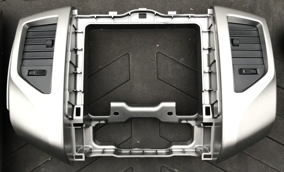

    Climate Control
    55900-04090
    2005-08 to 2012-15 Adapter
    Center Panel
    55405-04070
    Lower Panel
