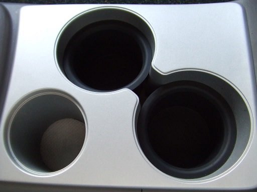

    FJ cup holders.

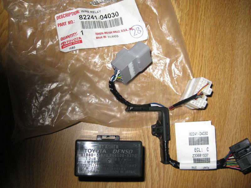

    DTRL harness and relay. Thanks @earnesje

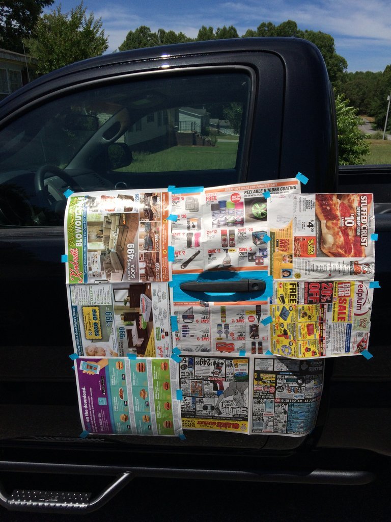

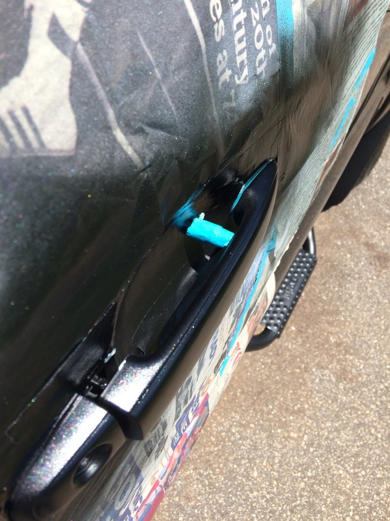

    The sun did a number on the plastic handles, so I painted those. Added a tube step too.

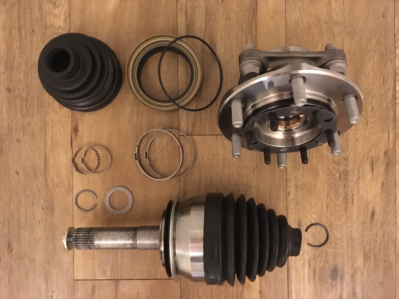

    While reading how others did the 4x4 convert, I kept running across 1st Gens with manual hubs.
    The forum had already figured out the hub/bearing assembly, all I needed was a CV joint.
    After making a few purchases and taking measurements, I designed a manual hub CV Joint that would accept the 2nd Gen shaft.
    Manual Hub CVs were in production!

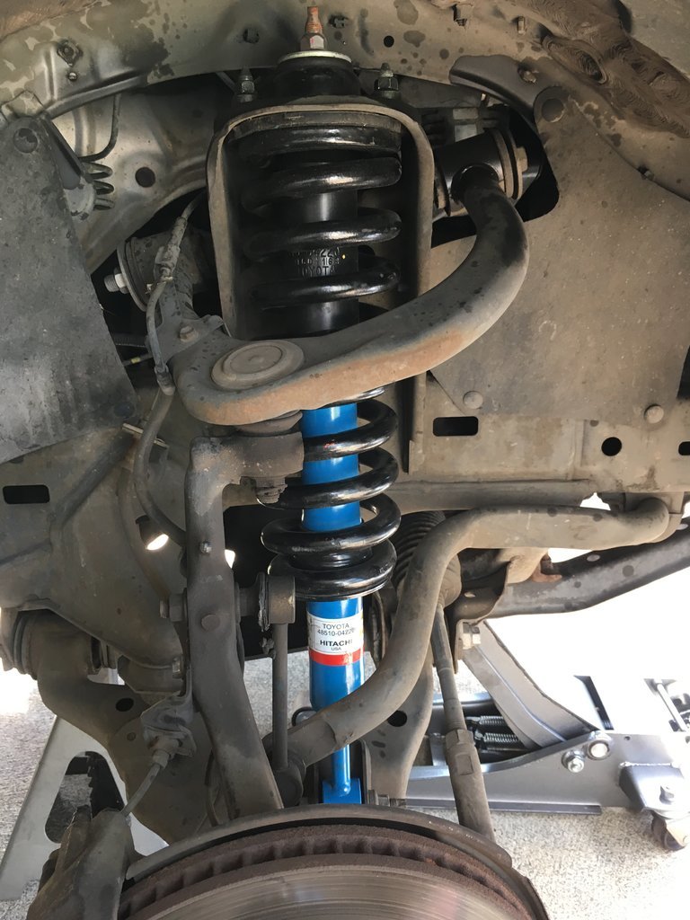

    The PreRunner's shocks/struts are quite stiff, so I picked up a 3rd Gen Sport's shocks/struts for a softer ride and a 1" lift/level. Thanks @crispy77

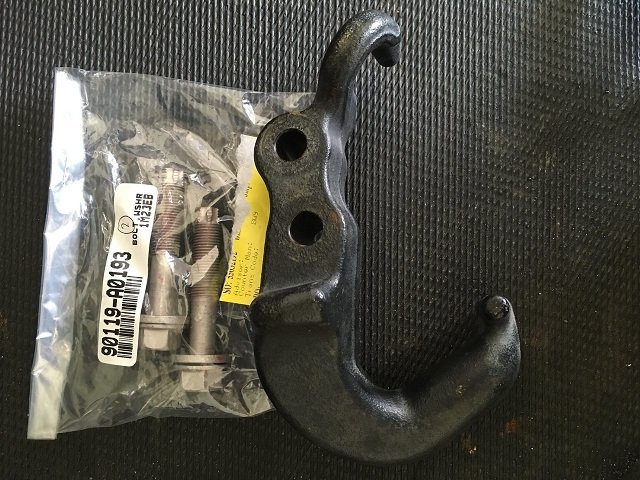

    Recovery Hook
    Thanks @3pooches

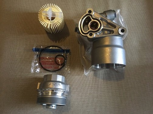

    Cartridge Oil Filter Conversion

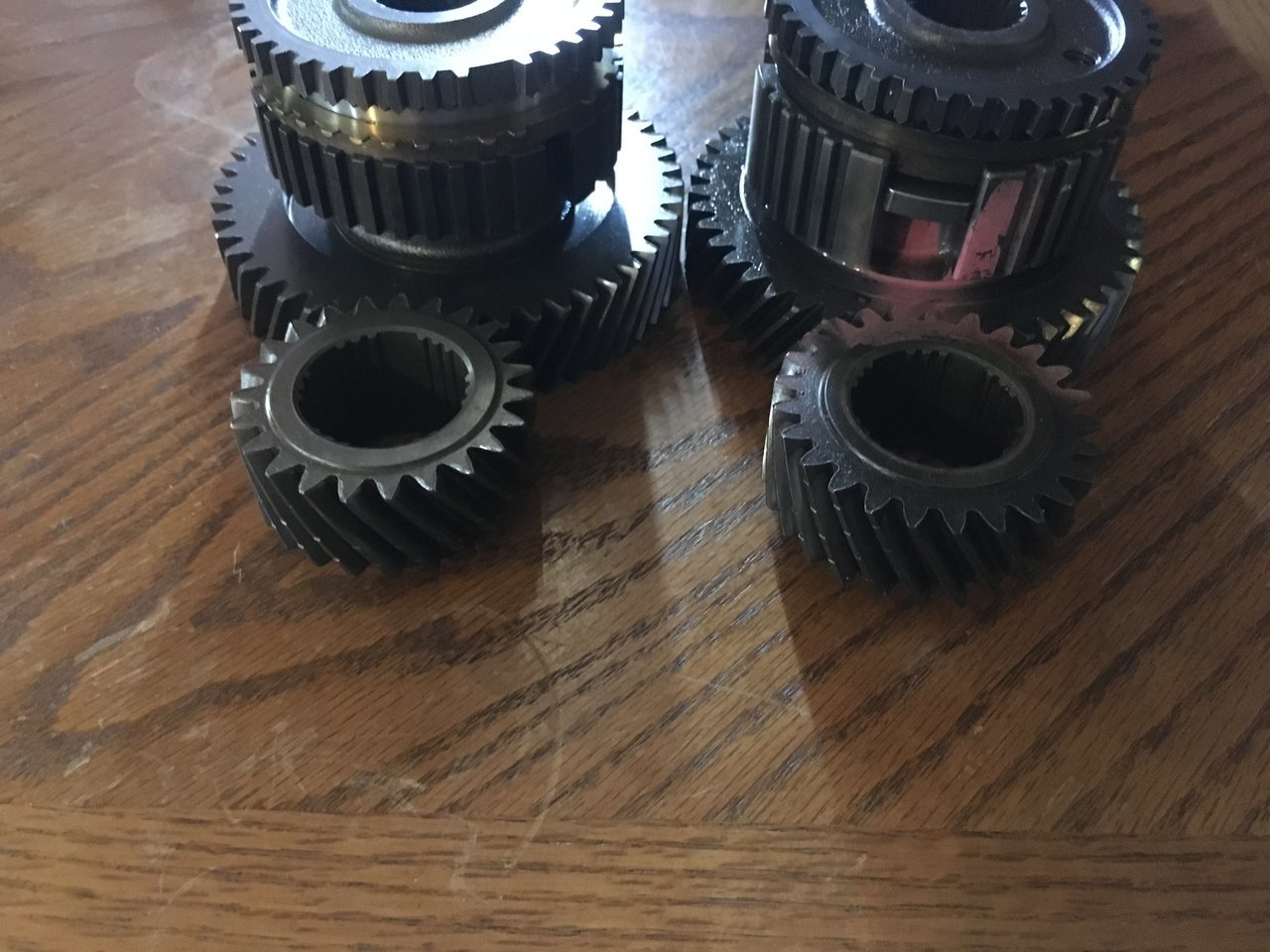

    How are you going to improve 5th OD? Interested in this :D

    Got a hot lead on replacing the 5th gear set with one from a dump truck in Australia lol.
    But run into an issue with the trans actually being different than the ones with sold in Australia, then though they are called the same model number. However, I think I have it figured out, I've got a few parts in the mail from Japan that I think will work. I probably won't swap these in until the supercharger is complete, though.
    MarX and ChadsPride like this.

    MPG. I got the supercharger because my 2TR doesn't handle hills too well. I don't feel right in 4th on the interstate.
    If I feel the truck will have the power after I install it, then I'll install the new 5th gear. I should have waited to purchase that but curiosity got the better of me lol

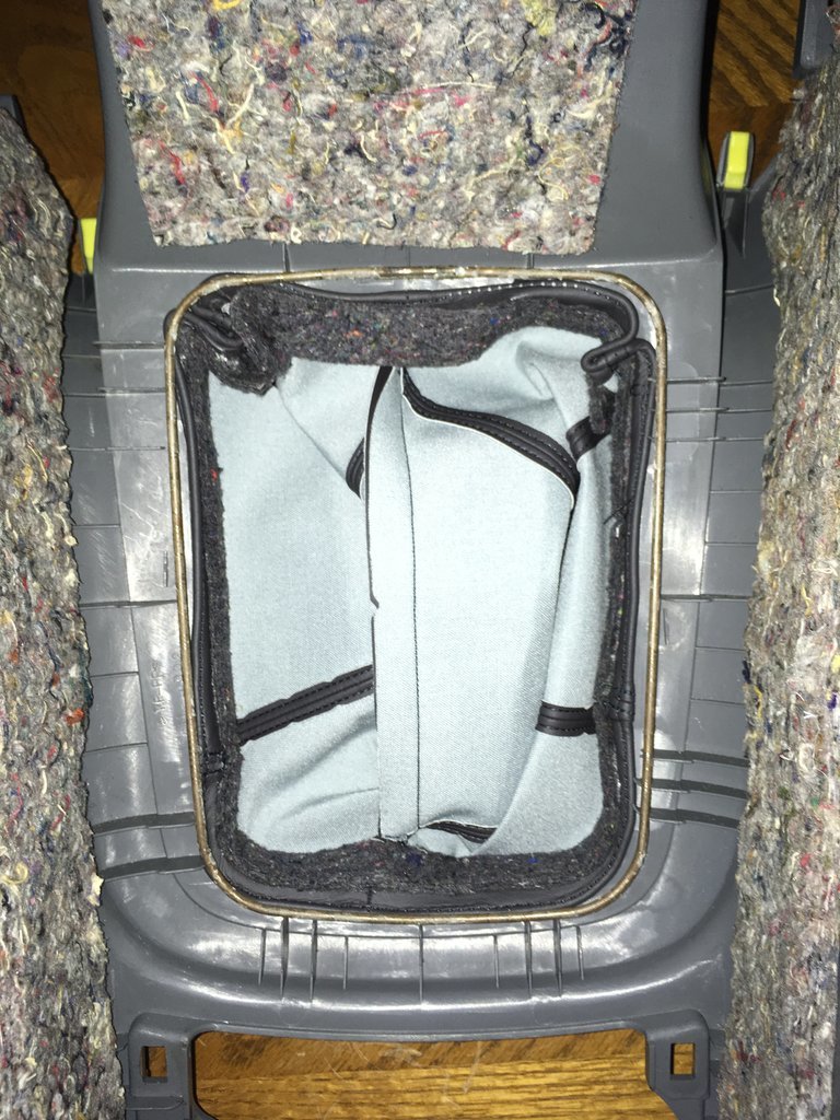

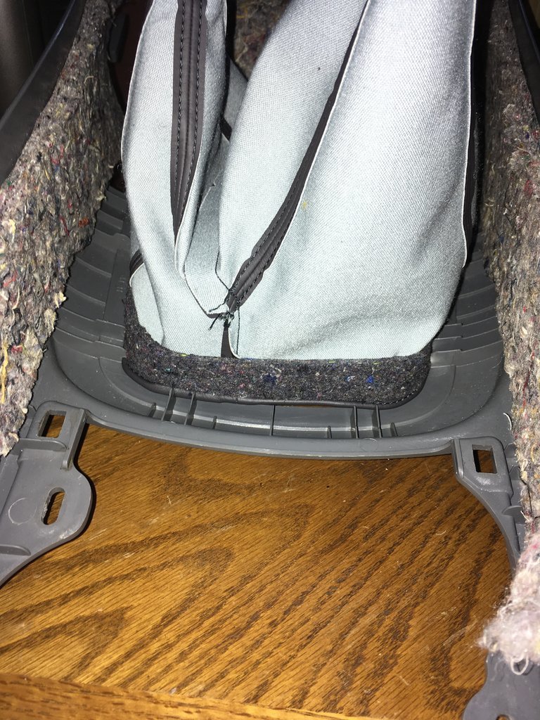

    Hey @05Taco4x4, I like your truck! I did a 4x4 conversion this summer on a 5 speed manual 2nd gen as well. All the other 4x4 conversions I have seen are for V6/auto trucks. On your fj cruiser shift boot, was there any modification required, or did it just pop in where the stock shift boot goes in the plastic console?
    tacoburrito and 05Taco4x4[OP] like this.

    The FJ boot doesn’t just snap in, I actually spent a lot of time on that thing.
    The metal wire within it isn’t as ridgid as the Tacoma’s, so I reshaped it to fit.
    I cut the wire from the Tacoma’s boot and put it in the picture for comparison. Notice how I folded the corners at the top.
    I pulled the boot inside out, like this:
    I placed the old wire on top of the felt, then sprayed 3m industrial glue on the felt, wire and an inch up the boot backing. I let it tack, then folded the boot backing over the wire and felt. I let it dry in this position for a day. The next day I removed the boot from the plastic, pulled it right side out, then reinstalled. The wire gives the felt ridgidity. It’s working great. I imagine it would be very easy for an auto interior shop to cut the FJ wire out and sew the Tacoma wire in- this would be the cleanest IMHO.
    The FJ boot doesn’t have the felt on the backing like the Tacoma boot does. I haven’t transferred that over yet, but I will.

    Okay I see what you did. I just cut a hole in my original shift boot and then had my mom sew up a miniature boot for the t case:D
