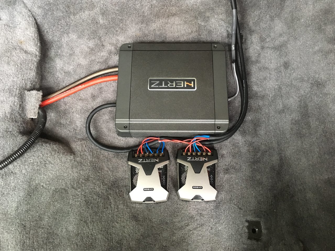

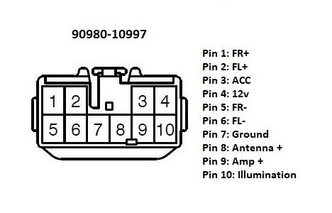

    Speaker Upgrade
    Amplifier
    2-Way Component
    Mount Adapter
    Harness/Speaker Wire
    Monster Cable S16-4 XLN
    Power/Ground Cable
    Circuit Protection
    Bussmann CB185-50
    Sound Deadening
    82998-12340
    JPN
    Cable Loss Estimator

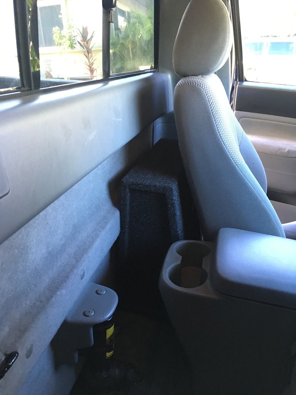

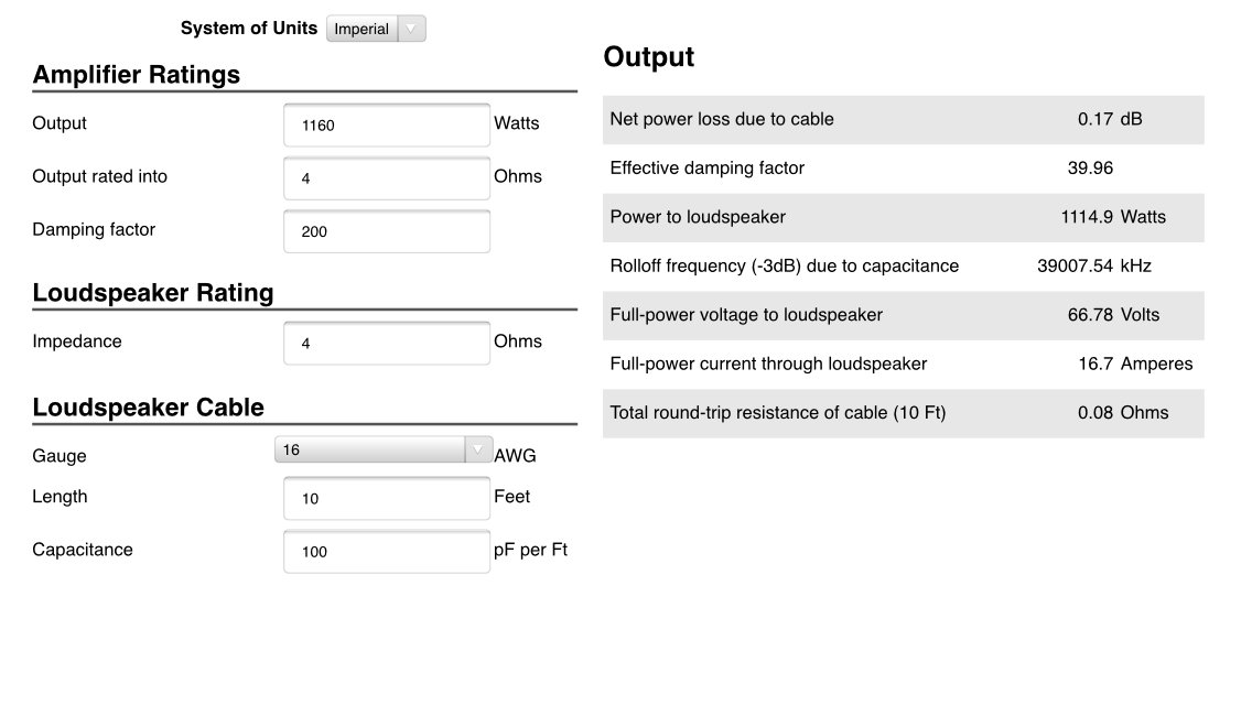

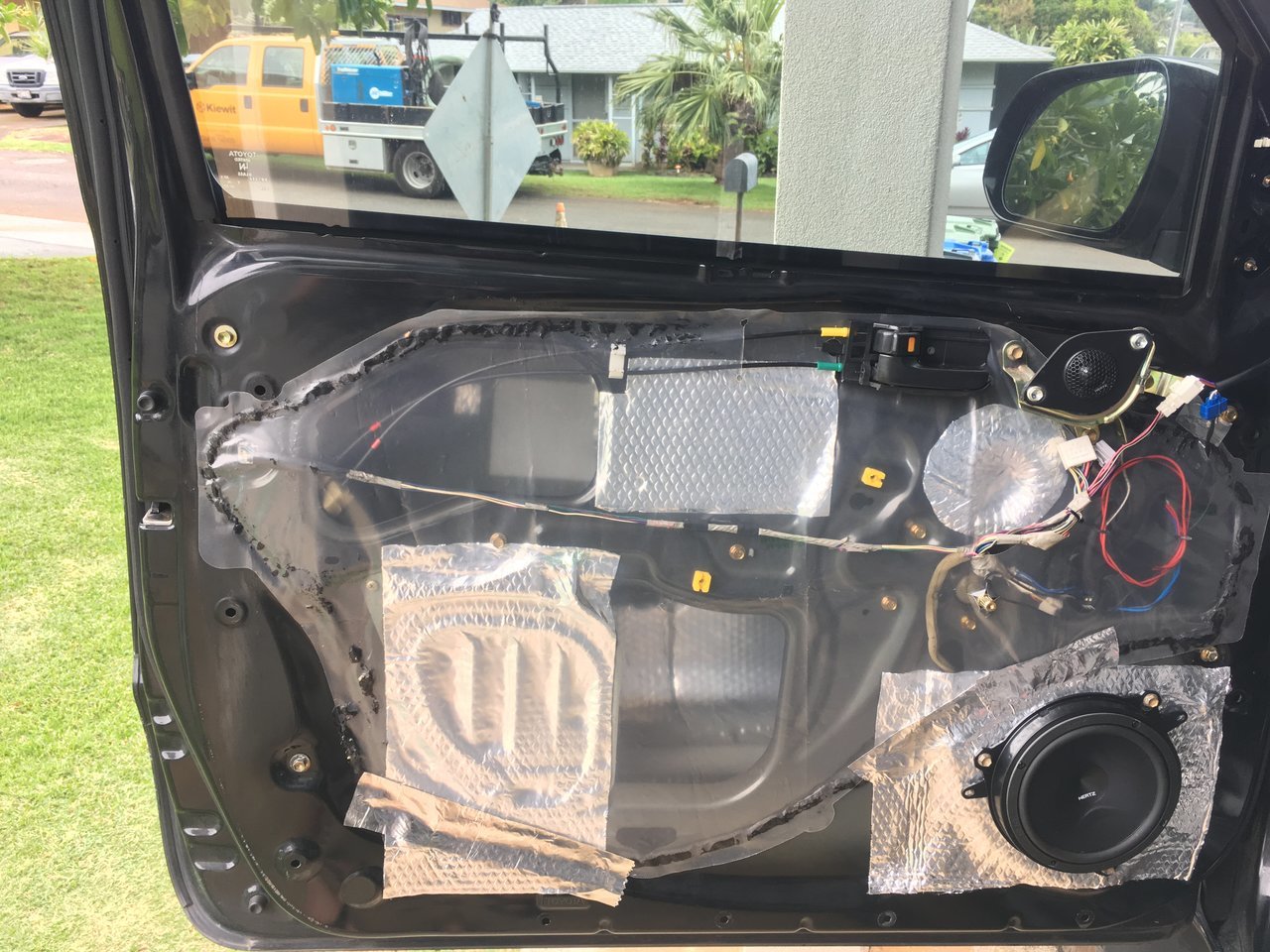

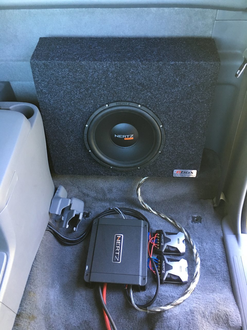

    I planned to use the shielded 16/4 Monster Cable from the head unit to amp, but with only .17dB loss @ 10 ft I was able to use it for speaker wire too (30 ft in total).
    The Kolossus Fleks Kable is really high quality; 8 ft is enough to route from battery to driver’s seat.

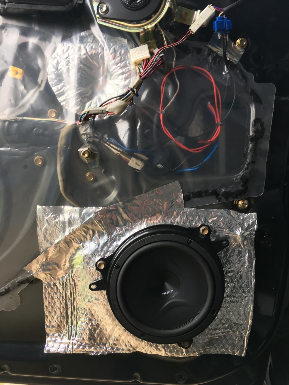

    The Noico sound deadener works well. I used 12 sq ft to nearly cover the entire outer skin and half coverage on the inboard panel of both doors.
    Note:
    DEI 050330 Boom Mat Speaker Baffles DON’T FIT- window hits when rolled down

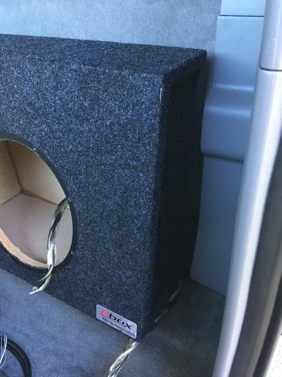

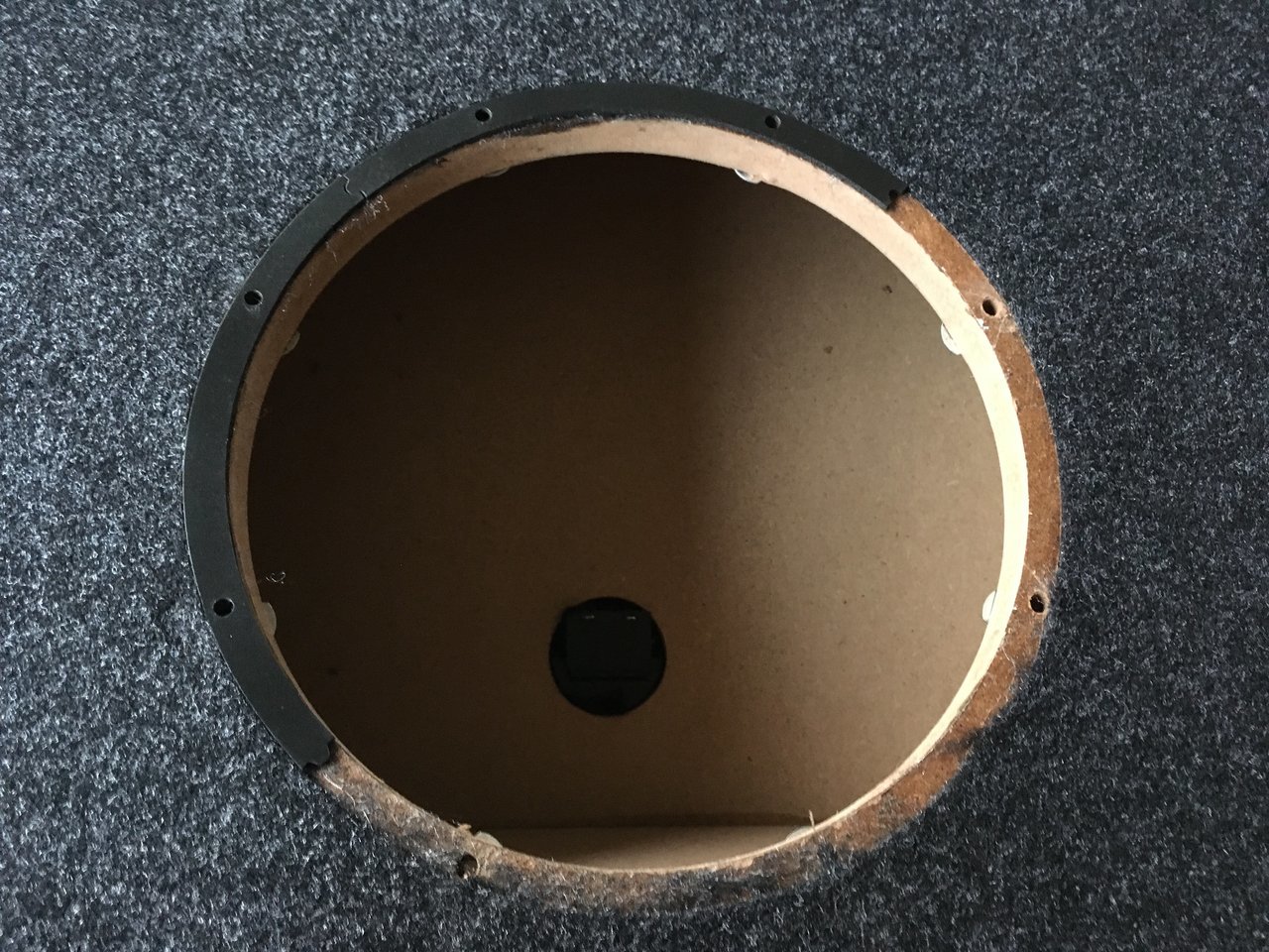

    Subwoofer
    Sub
    Hertz ES F25.5 10”
    Enclosure
    Bbox E10ST
    Binding Post
    Pixnor 45mm
    Speaker Wire
    KnuKonceptz Karma SS 10ga
    The binding post will not accept 10ga so I upgraded that.

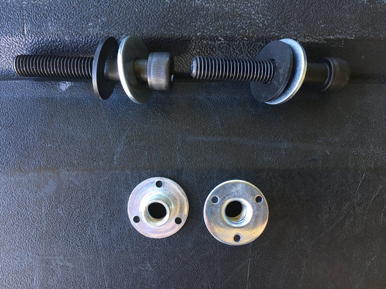

    I used tee nuts/socket head bolts to secure the woofer to the enclosure. Hertz supplied a seal, so I traced around the woofer with a razor and removed the carpet to get a good seal.

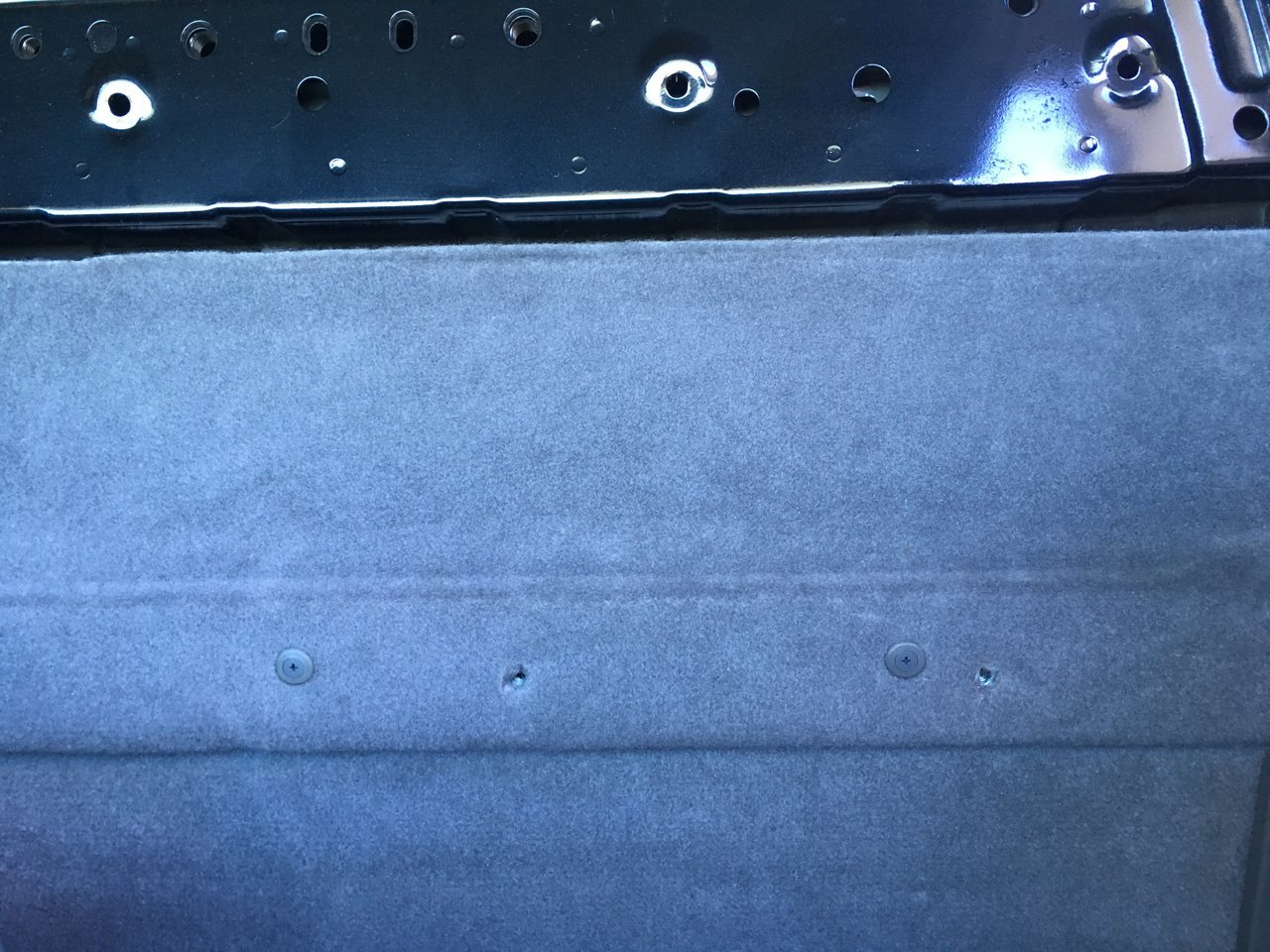

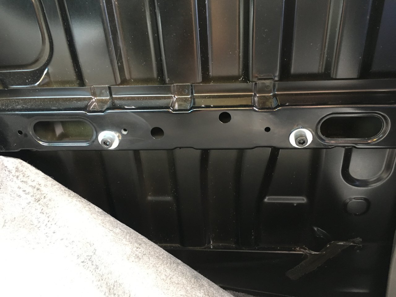

    Mount to back wall
    I epoxied two bindings to the back side of two holes which were already in the support; I bolted them in place.
    I positioned the enclosure over the bolt heads and pressed it against the bolt heads, making indentations in the enclosure carpet- I then drilled holes at the indentations (did the same for the wall carpet).
    I epoxied inserts in the enclosure holes, to keep the bolts from damaging the MDF over time. After the epoxy set 24hrs, I removed the bolts and installed the enclosure; I put neoprene washers between the flat washer and MDF.
    The enclosure almost looks like it was custom made for the truck, it fits between the plastic perfectly.

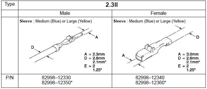

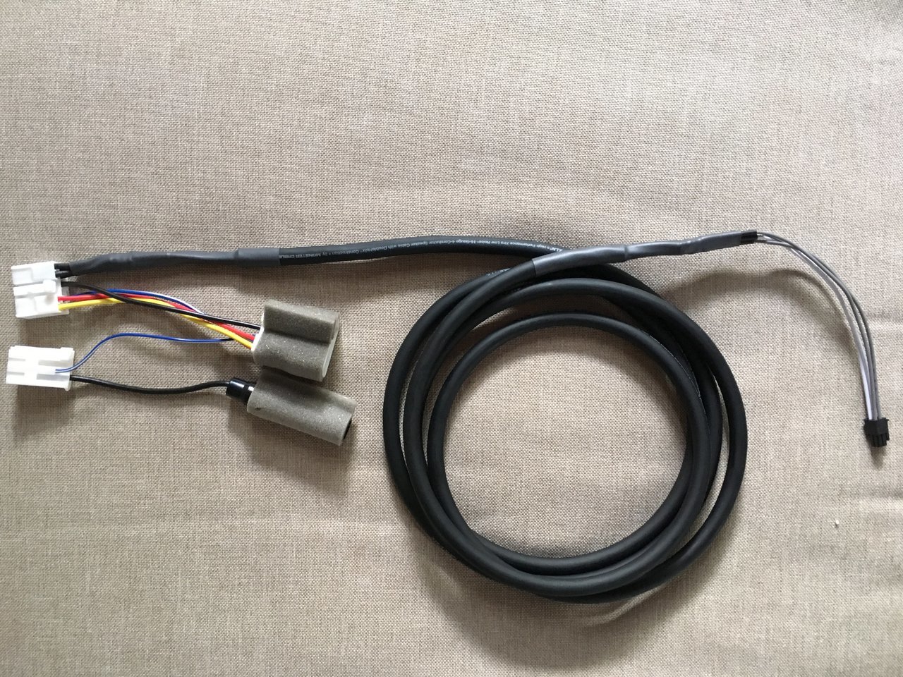

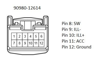

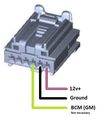

    Future MOD
    Mobile Wireless Charger
    Charger
    861C0-04010
    Charger Connector
    90980-12368​
    Charger Connector Repair Terminal
    82998-24290 JPN
    Switch
    861C6-06011
    Switch Connector
    90980-12614​
    Switch Connector Repair Terminal
    82998-12870 JPN
    GM alternative
    Charger
    Harness
    23124536
    Connector
    Terminal
