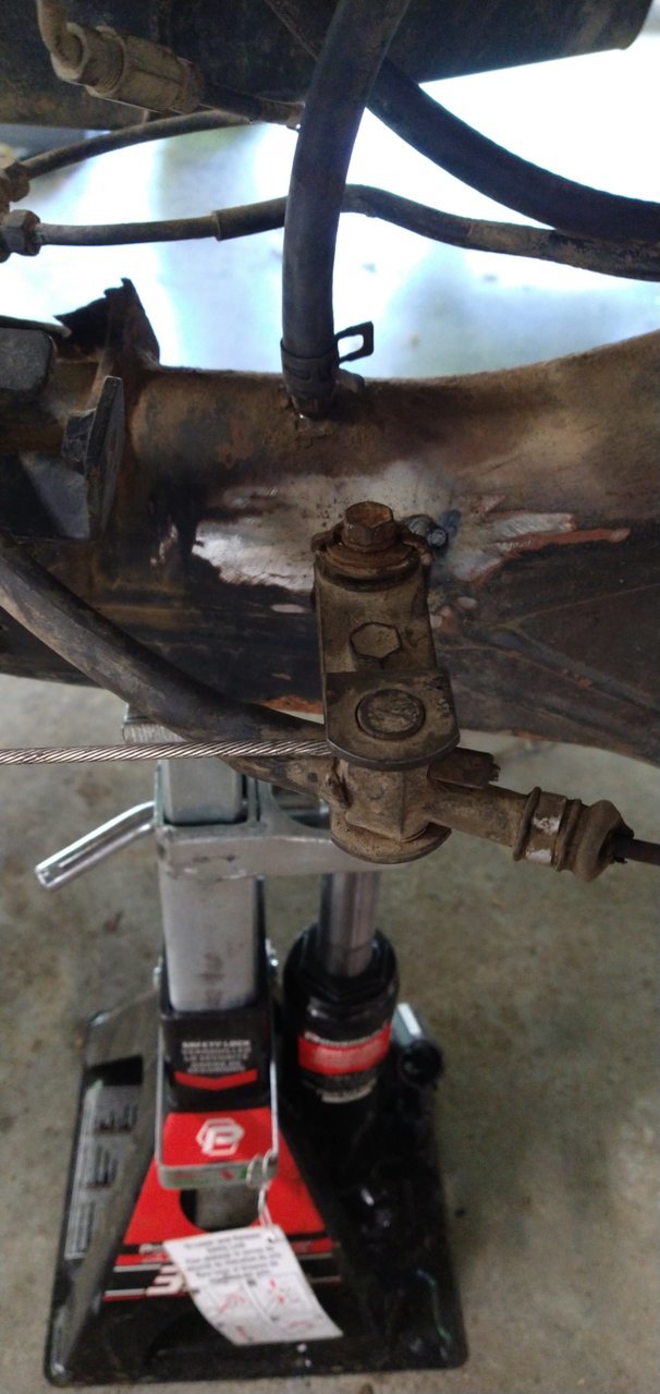

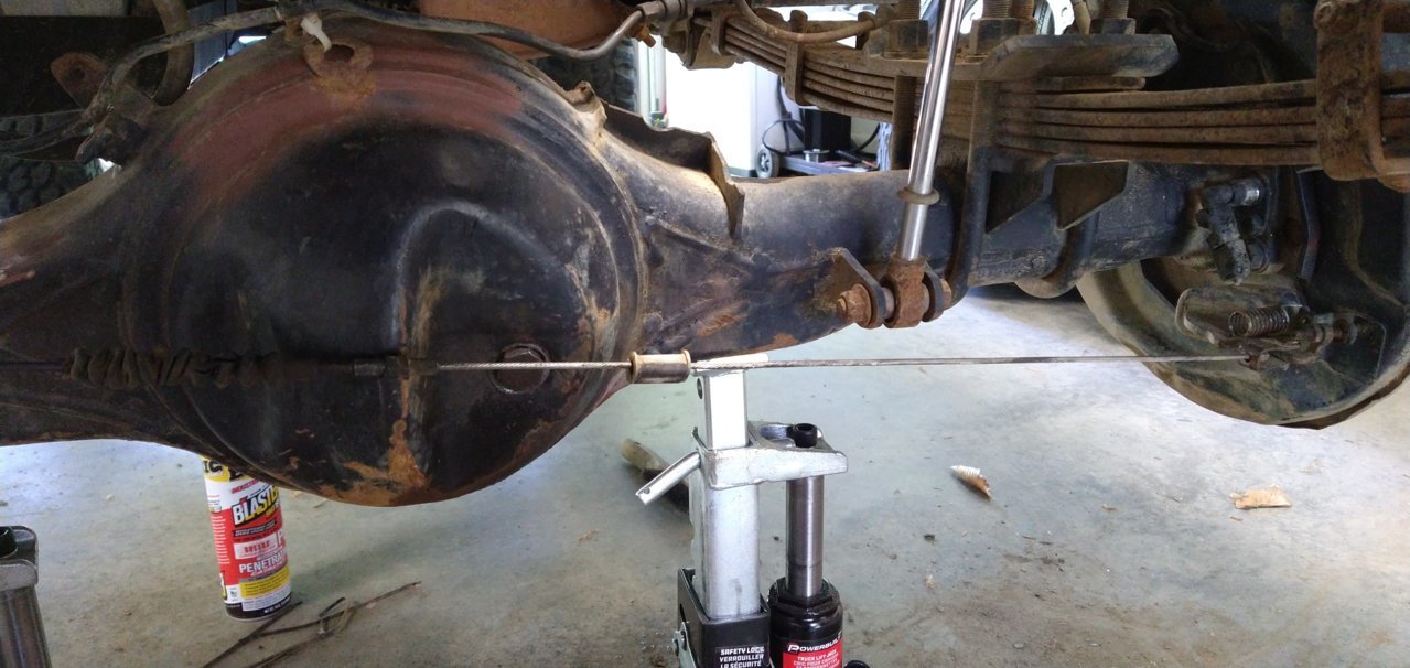

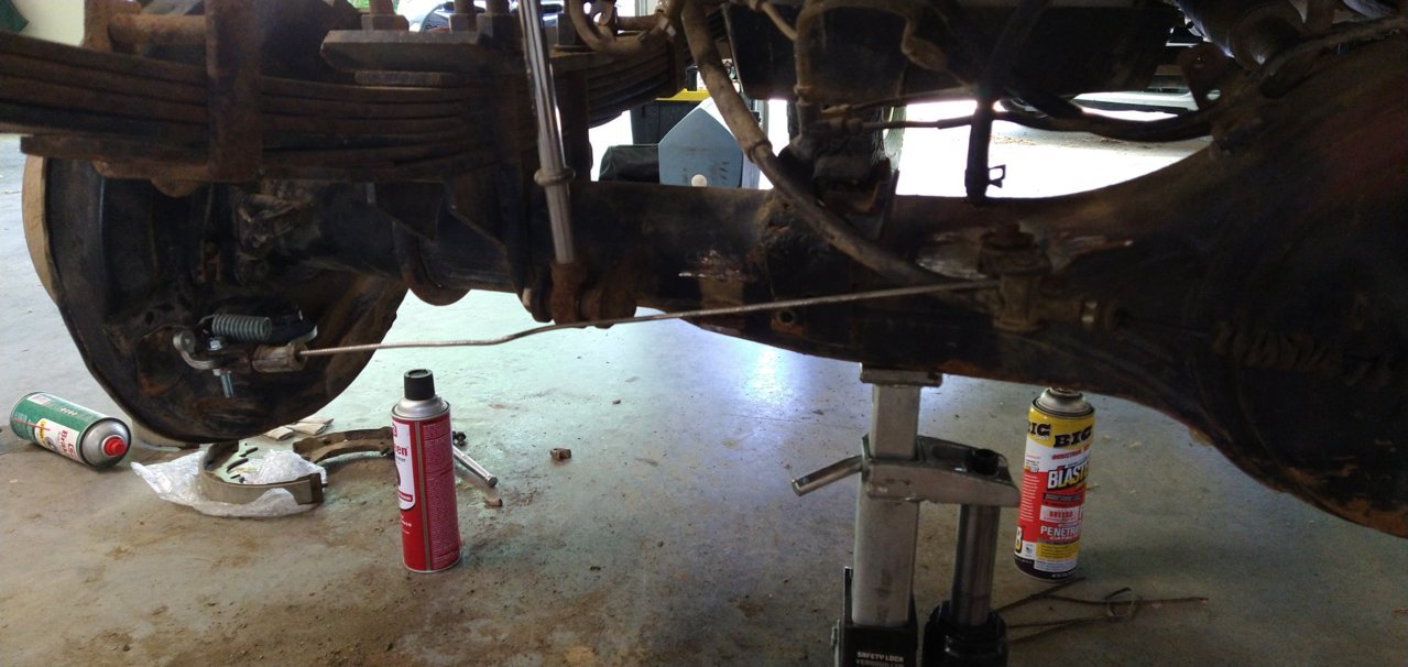

    Finished this up, big disclaimer here, this may or may not be a "it needs to work one time a year to pass an inspection" type setup, so this probably won't work for daily use. However I did manage to get the factory Tacoma cable to reach the fj80 bell cranks. The brake works great, holds on my inclined driveway and will stall the truck in 1st.
    Anyway here are the pics:
    I did have to unthread this all the way out, took forever, 20years of crap on the threads and I couldn't even use heat as my battery cable is right there and there are fuel lines.
    I will also say adjusting the parking brake sucks. You are blindly fiddling with the adjust through a tiny hole and you can see anything.
