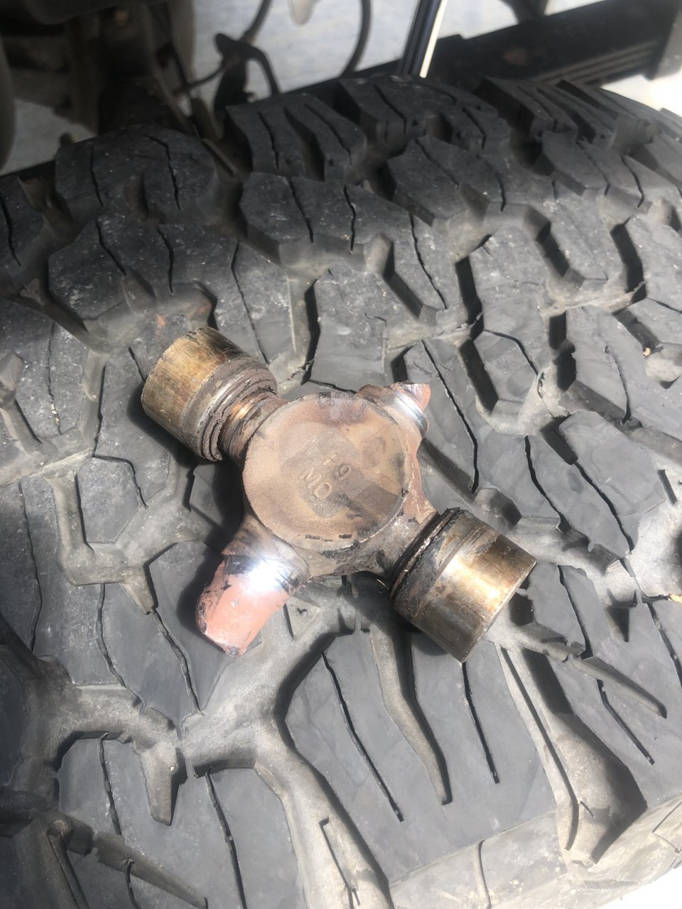

    Hey guys, reviving an old thread here. My flange yoke and u joint decided to crap out going 70 on the interstate...on a cross country trip from Utah to Florida...currently broken down in the middle of nowhere Kansas. Dreams do come true.
    Heard a loud BANG, swerved as the rear axle lost all power, and came to an emergency stop. Got out of the car and, lo and behold, the rear drive shaft was hanging about a foot off the trans in the air. At that moment I knew, yep I'm f*ed.
    Managed to push the car to the nearest exit. I've called all the auto parts shops, junk yards, and Toyota dealers in a 3 hour radius and nobody carries the flange yoke. As others have mentioned, Toyota can special order the entire driveshaft for a mere $1028.
    The crazy thing is, the entire driveshaft, including these parts, was replaced 2 years ago at the Toyota dealer under the driveshaft "warranty enhancement" program...a fancy name for a recall that they'll fix.
    I decided to order the flange and u joint online and have it overnighted. My question is, does anybody know if other vehicles use the same 1330 flange and u joint (tundra, 4runner, FJ, etc)???

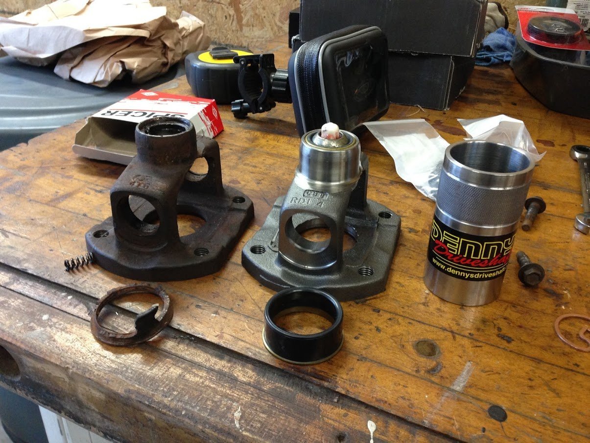

    Not sure if they have dana/spicer parts for toyota size stuff but I'm sure they could source them. I've used them for my ford and they've always been great prices and fast shipping. They had all the parts to rebuild the double cardan driveshaft.
    https://www.dennysdriveshaft.com/
    rbWkEtFYYKeHxSZjXr5_YO2JZf0jGXHC4w3t3BlN_53551081253632509cbfb25b5011aa3629f4b5f2.jpg

    Thanks!I checked em out but they only have domestic GM parts
