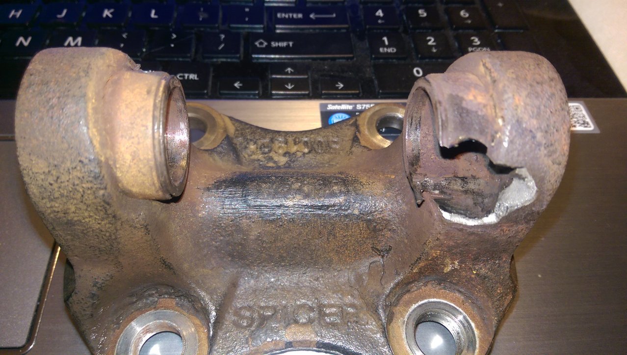

    Hi, I'm new to the thread. I have a 2012 Tacoma and my Flange Yoke is came apart on one end. I know its SPICER but I can't read the numbers clearly to get one ordered. I've looked around the threads but can't seem to find something definite. If its not available hopefully there is one that fits!20170728_221211.jpg

    Wow that thing has never seen any grease.

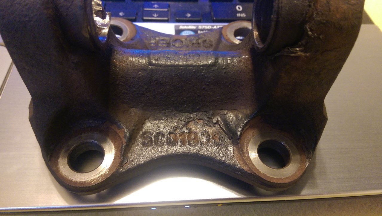

    correct me if I am wrong but isnt the number opposite of where the spicer logo is, not on the upper raised part?

    Yes, you're correct but the corrosion is the problem. I'm20170729_174225.jpg contacting drive drivetrainamerica.com Monday since they have them and hopefully have mine.

    eBay, Spicer 3-2-119 flange yoke 30$

    Wow, I take it you already knew. I don't know how you got those numbers but I'm gonna get it. Thank you

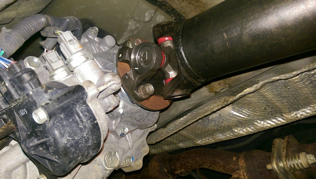

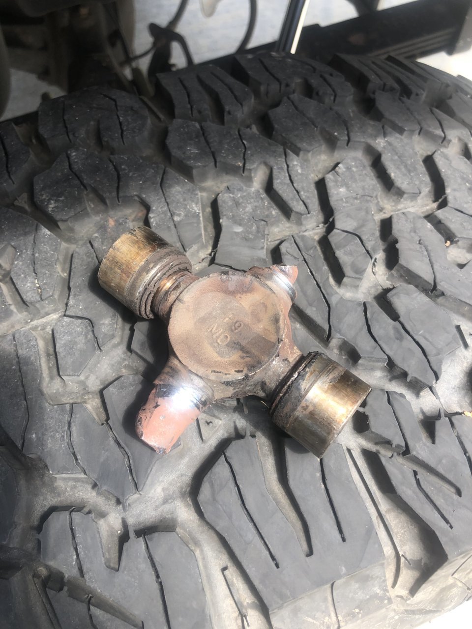

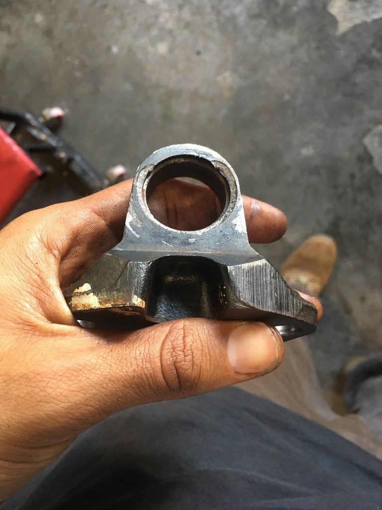

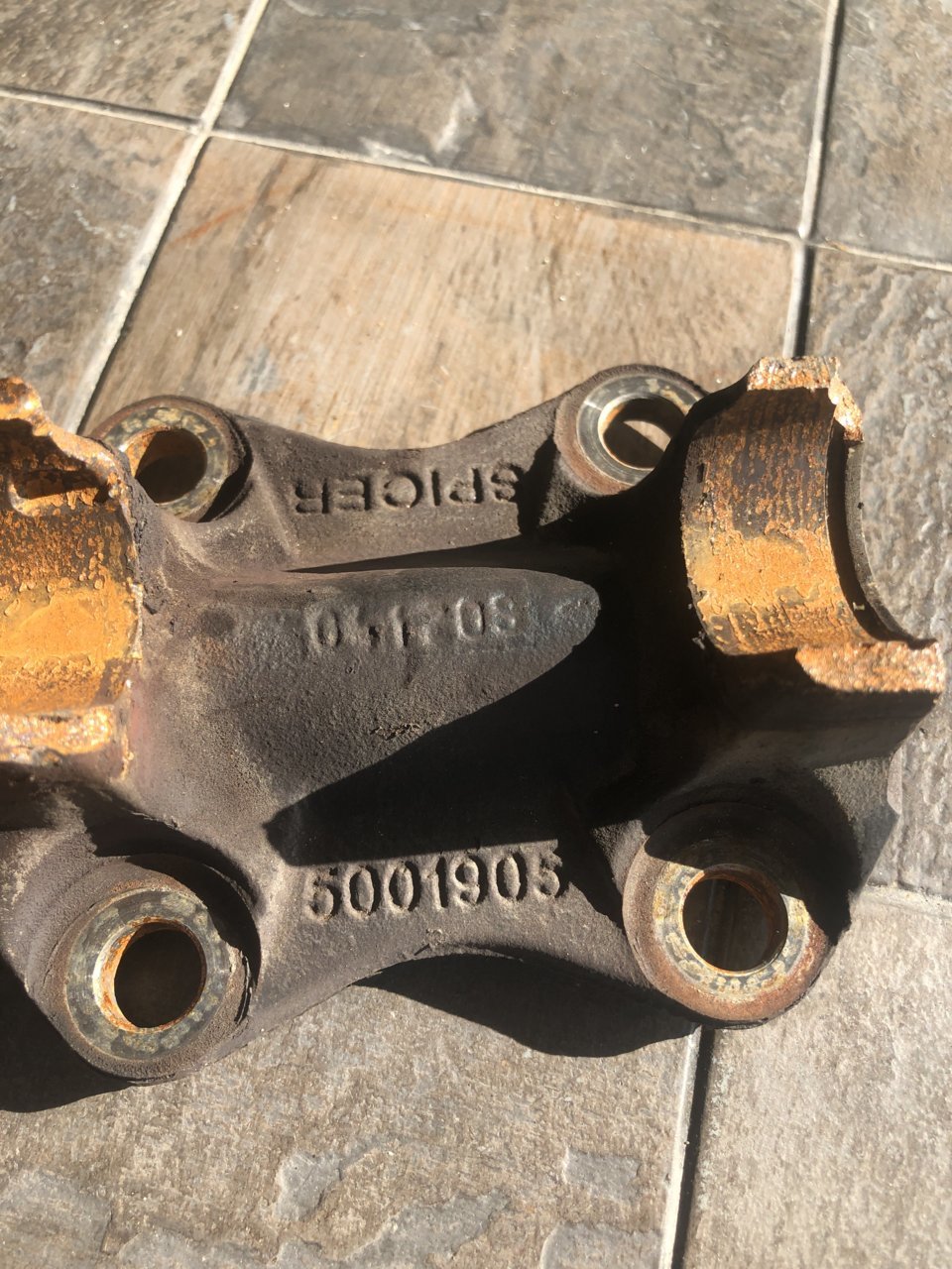

    Hey guys, reviving an old thread here. My flange yoke and u joint decided to crap out going 70 on the interstate...on a cross country trip from Utah to Florida...currently broken down in the middle ofnowhere Kansas. Dreams do come true.
    Heard a loud BANG, swerved as the rear axle lost all power, and came to an emergency stop. Got out of the car and, lo and behold, the rear drive shaft was hanging about a foot off the trans in the air. At thatmoment I knew, yep I'm f*ed.
    Managed to push the car to the nearest exit. I've called all the auto parts shops, junk yards, and Toyota dealers in a 3 hour radius andnobody carries the flange yoke. As others have mentioned, Toyota can special order the entire driveshaft for a mere $1028.
    The crazy thing is, the entire driveshaft, including these parts, was replaced 2 years ago at the Toyota dealer under the driveshaft "warranty enhancement" program...a fancy name for a recall that they'll fix.
    I decided to order the flange and u joint online and have it overnighted. My question is, does anybody know if other vehicles use the same 1330 flange and u joint (tundra, 4runner, FJ, etc)???
