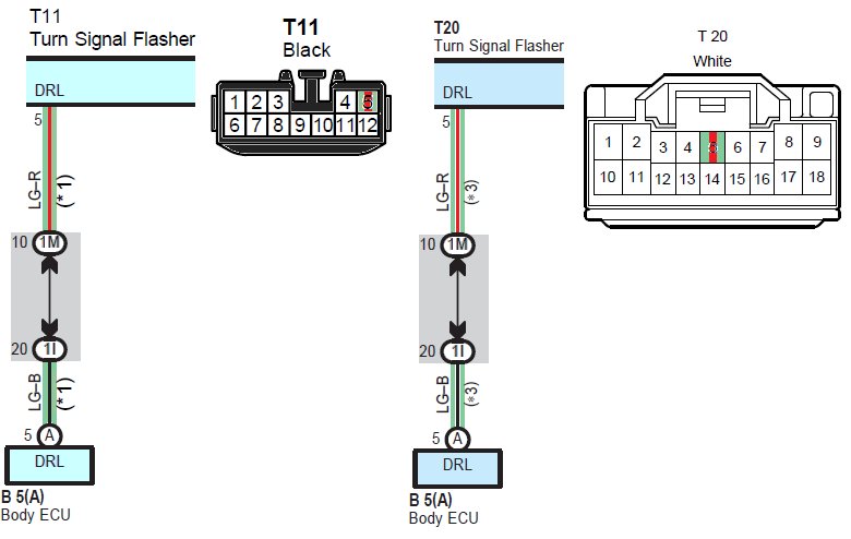

    In the first part of this thread there is a Toyota part mentioned, a jumper block needed to delete the DRLs.
    I was looking at my truck last night, do you know what 3 wires combo are jumped in this jumper block? Just curious, if I could just solder the wires myself instead of buying the Toyota part.

    NO need to solder. If your vehicle has the harness you'd eliminate(de-pin or cut) the DRL ground. Which relay does your truck have the 18 pin or the 12 pin?

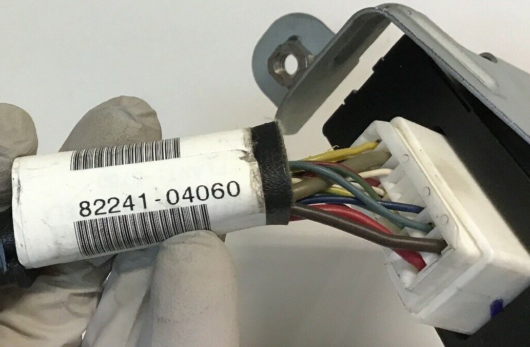

    Sorry its been time since I could get back under my dash. Its the white harness.

    @TRSAndrew you got a pic of the 18 pin relay installed? And the harness to it?
    Edit: Found the harness.

    that looks to be the harness i have too

    You know, since I posted that link of the tow harness, I got to thinking. For the people that have that 4 way harness in their truck, I wonder if that's strictly the "over the counter tow package" harness. It would make sense that if a truck doesn't come with a tow package and you want to add a 4 wire trailer light connector, plugging in those pieces shown would be an easy way to do it.

    It is...there are 2 versions from Toyota, but most dealers didn't install them.:notsure: And owners balked at the price of the "oem" ones...:facepalm:
