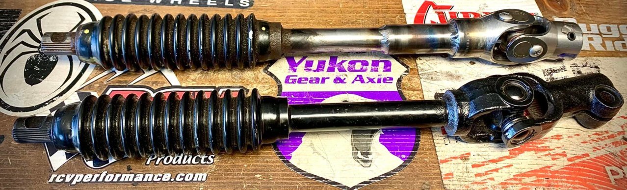

    May need this down the road
    UA108100 Woodward joint for rebuilding the intermediate steering shaft
    Thanks @AwArD

    Yeah I tend to acquire parts. The Woodward joint though may be needed to make a custom steering shaft to go to a steering box down the road.

    Will see. I have an extra steering shaft to mess with. I do like the Woodward joint since it’s designed as is. Not sure how janky that other unlint would be. Mind you shouldn’t be that much force on the joint. I don’t know. Don’t have to worry about it now.

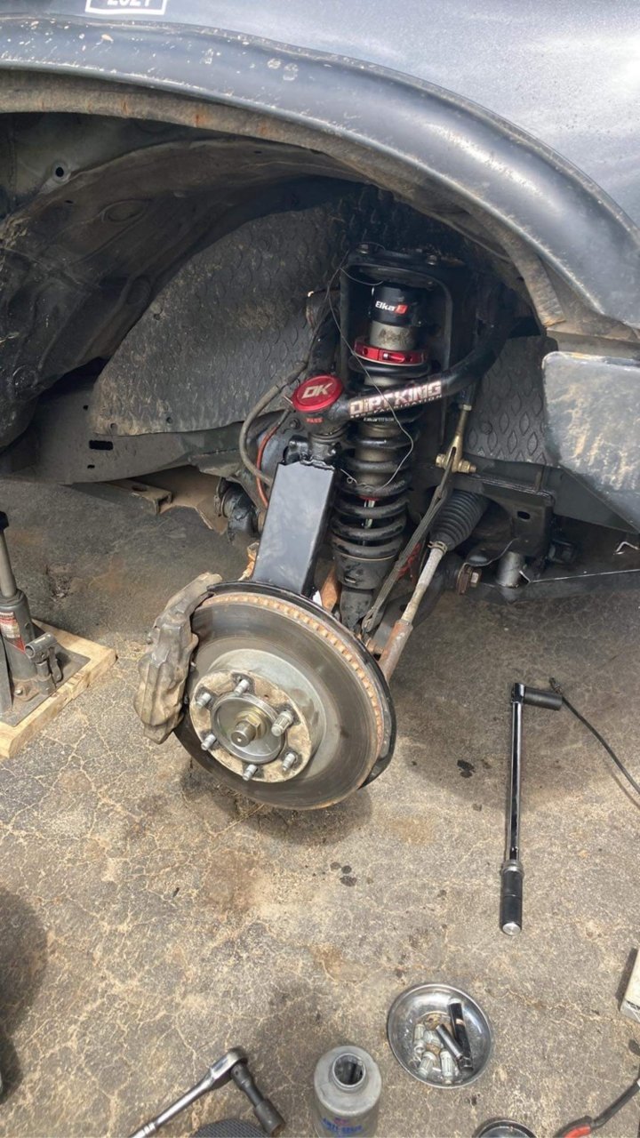

    Today I decided to finally get around to fixing my issue. Have all the parts ordered and ready to go. Was taking a toe measurement in order to match my alignment after the new rack. Noticed the front diff was locked…..super weird. Checked the locker, it was off, and checked everything. Why is the air locker engaged. Undo the hose into the electronic valve and a bunch of air comes out. My binding steering was a binding front end. The blow off valve filter was clogged which caused all the issues. Spare rack, pump and lines for now I guess.

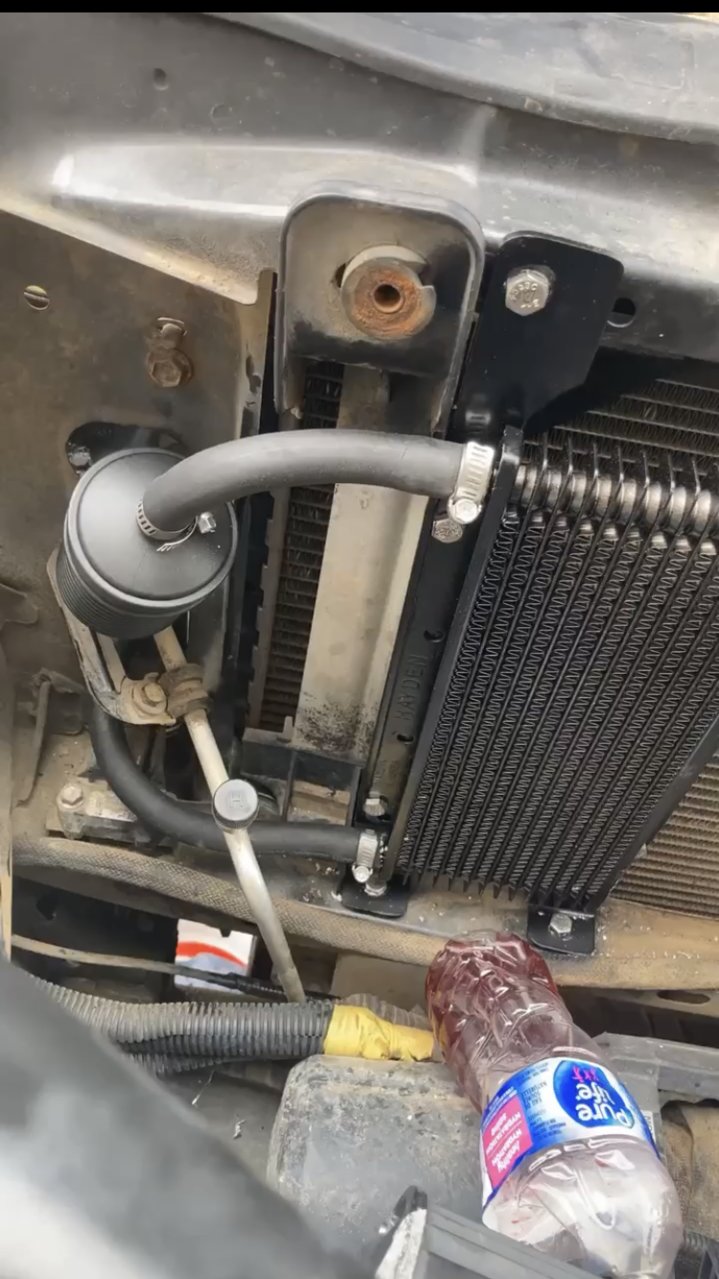

    Installed a few things since I didn’t have to replace the rack.

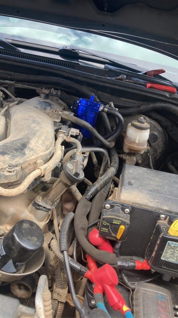

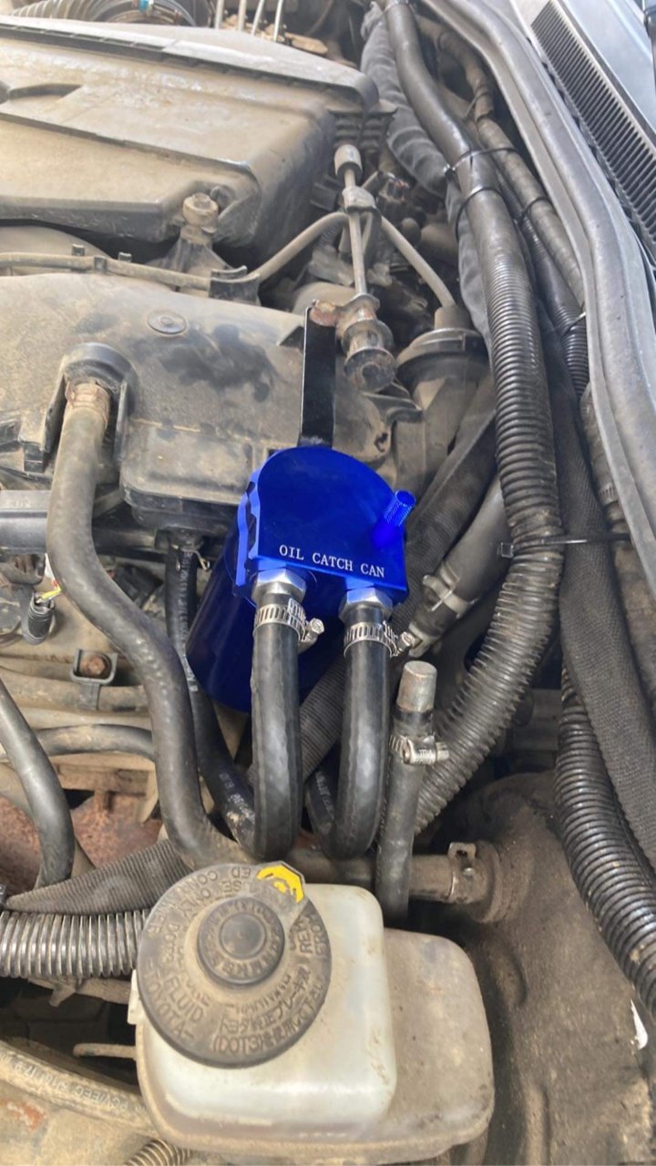

    installed a catch can. Had some gift cards so thought what the hell. At this point, there isn’t much I can get for $50 for the truck nowadays lol.
    532AB8CE-3D50-4277-89C7-3041E1CB159E.jpg CB920A54-1DEE-4D93-9599-815F7EF78487.jpg
    Just made up a bracket using some aluminum.

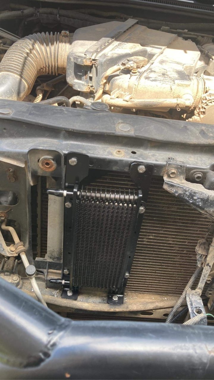

    also installed the power steering cooler and filter. Figured these couldn’t hurt anything. Will make sure it’s not obstructing line pressure on the return but I can’t imagine it doing so.
    221A41DC-5AE6-48F2-B075-8A6AE9A21C7F.jpg FBCF49DD-144A-4093-A49B-E39D3F09ED6E.jpg
    Again, brackets are out of some aluminum. I used rivnuts in the rad support to not have to mess around with nuts and washers. Just makes it easy if it ever needs to come out.

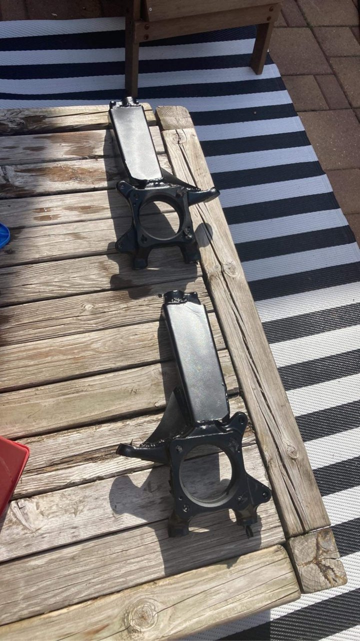

    also forgot, I welded in the new gussets. Swapped in the one side already and will do the other side to have matching new ones.
    paint baking in the sun
    And passenger side done.
