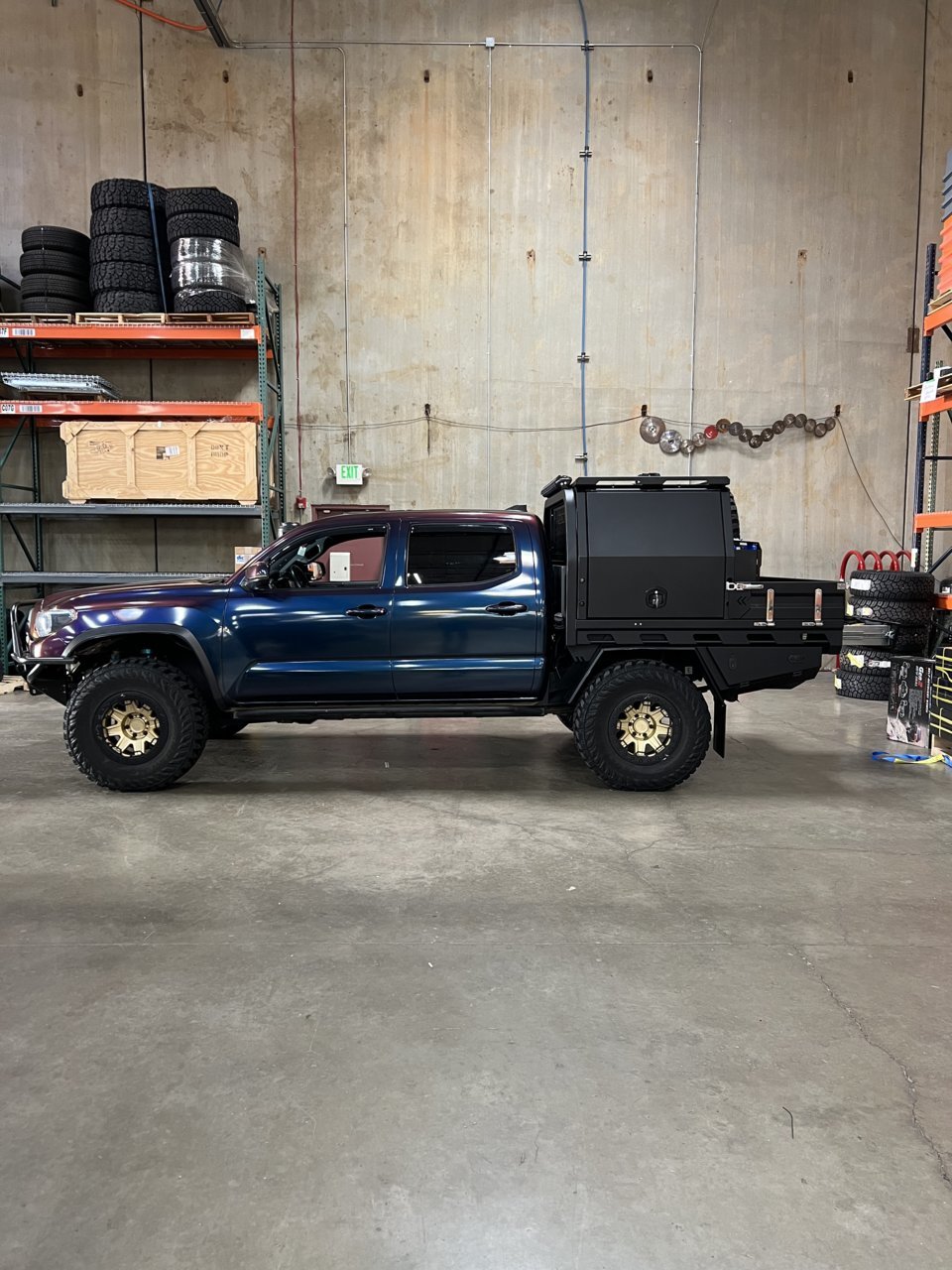

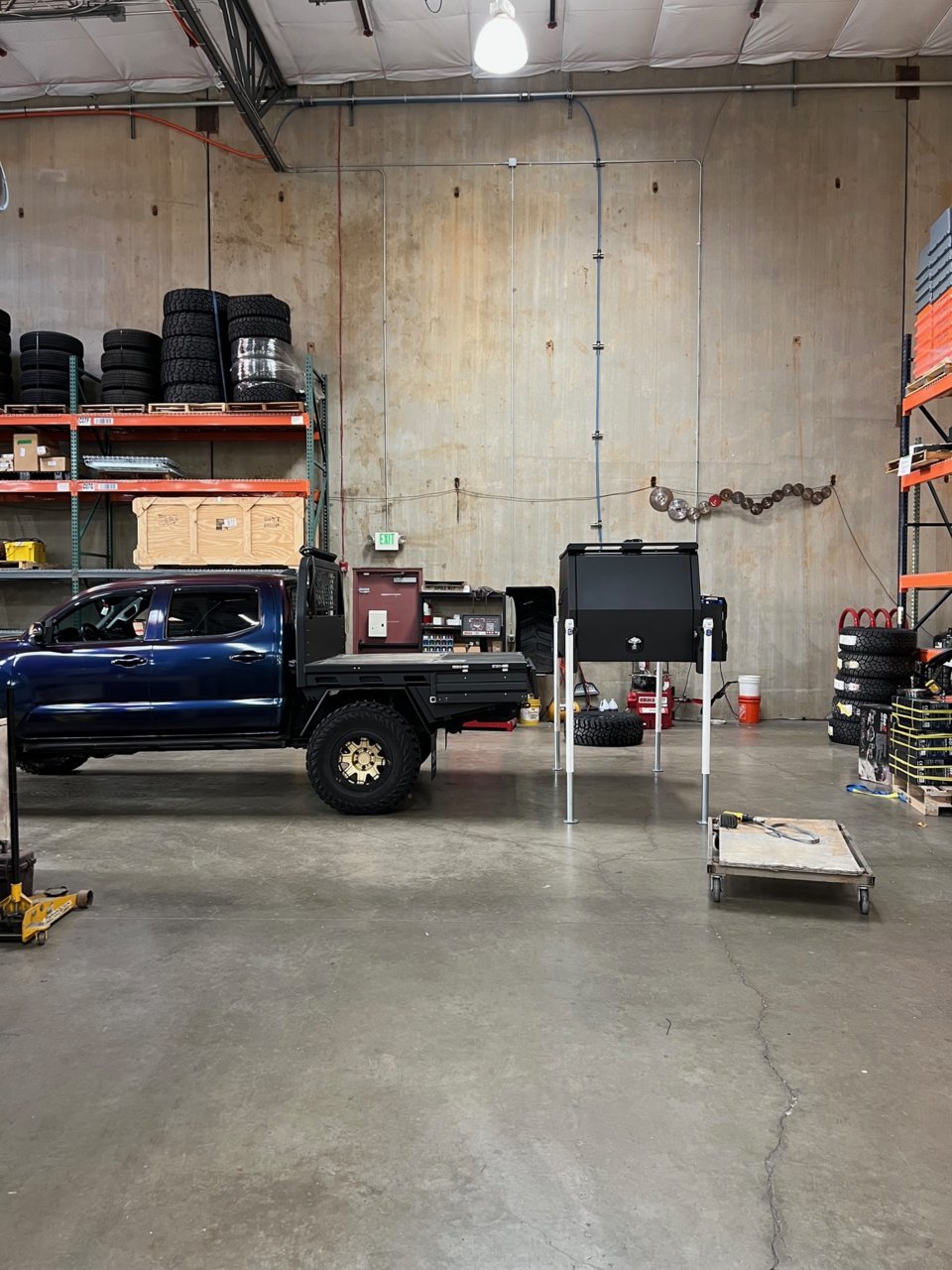

    The modularity of the Mits
    Took about 15 min to go from canopy to just a tray

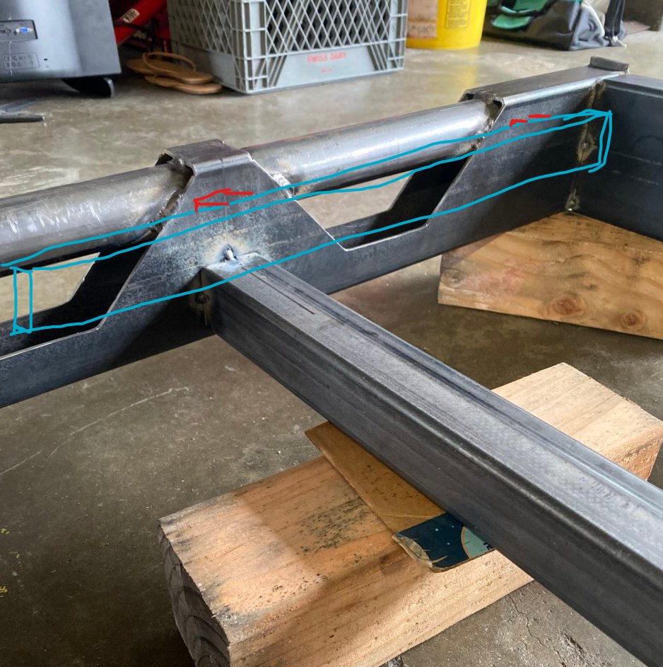

    Here is my flat bed tray build…. First fabrication project.
    materials cold rolled steel
    2X5x1/8 in sq tube
    2x2x11gauge sq tube
    1 3/4 in rnd tube
    14 gauge sheet
    Dimensions
    6ft long x 5’4” wide
    welding process FCAW and a hell of a lot of grinding lol
    Inspired by Australian style Ute trays for off-road touring and work trucks.
    I’ll be posting more pics as I get closer to finishing it. I’ve got the bumper with recovery points and toe hitch, fenders to cover the tires and powder coat the whole thing. The taillights are reproduction Toyota fj40 taillights with bulbs and I’m going to splice the original wiring harness connector to the new lights so it’s plug n play.

    Nice design.
    Looks heavy!

    man, that is super stout.
    only thing missing would be some 3" plate on the inside of the sides to be able to connect in a 2" ratchet strap with flat hooks
    with the large bend radius of the tube, you wouldn't be hurting the straps all too much.

    It’s probably gunna be 100 150 pounds over stock bed but I wanted some weight back there on my allpro expo springs the ride has been stiff since I deleted my shell and decked drawers.

    And regarding the tie down points I stick with the inner tube as a way to keep everything clean and a unique design the straps I’ll be working with work well when hooked onto themselves and around the tube.

    Nice! great work man! what is that round bushing/washer thing that you used to as part of the mount? I don't have a build of mine but check it out. I went for sturdy but also wanted to keep weight down for the camper I'm building.

    Spare body mount bushings I had
