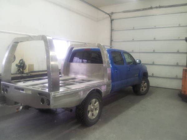

    Hey guys and gals, I am a new member and proud owner of a 05 taco sport. I was curious to see what kind of interest there is for flatdecks on tacomas. I have a very clean and light design that looks great.

    Interesting design. All aluminum??
  10. Jun 9, 2013 at 8:07 PM
    mikers
    mikers [OP] Member
    Jan 14, 2013
    #95191
    16
    mike
    kelowna bc
    05 taco
    ya. its only about three hundred pounds. the rear arch is fully removable, and has center ramp storage as well as sliding steel extentions to be able to carry my can-am commander.

    What is the function of this rack design ?

    its my work/play truck. We are a small aluminum fabricating shop, and i typically pick up all my material.

    Looks good. How did you mount it to the frame? Large U bolts?
    What would you estimate the materials cost is?

    I mean what do you use the rear rack for and what prompted it's shape / design ?

    All the x members are made to follow the frame depth. the deck bolts to the existing box mounts with a rubber isolator.
    I would put the price at around 5k for one similar.

    I wanted to follow the lines on the cab. The rear arch is just a duplicate of the front. The arches weigh about 25lbs, and have supported 1000lbs.
