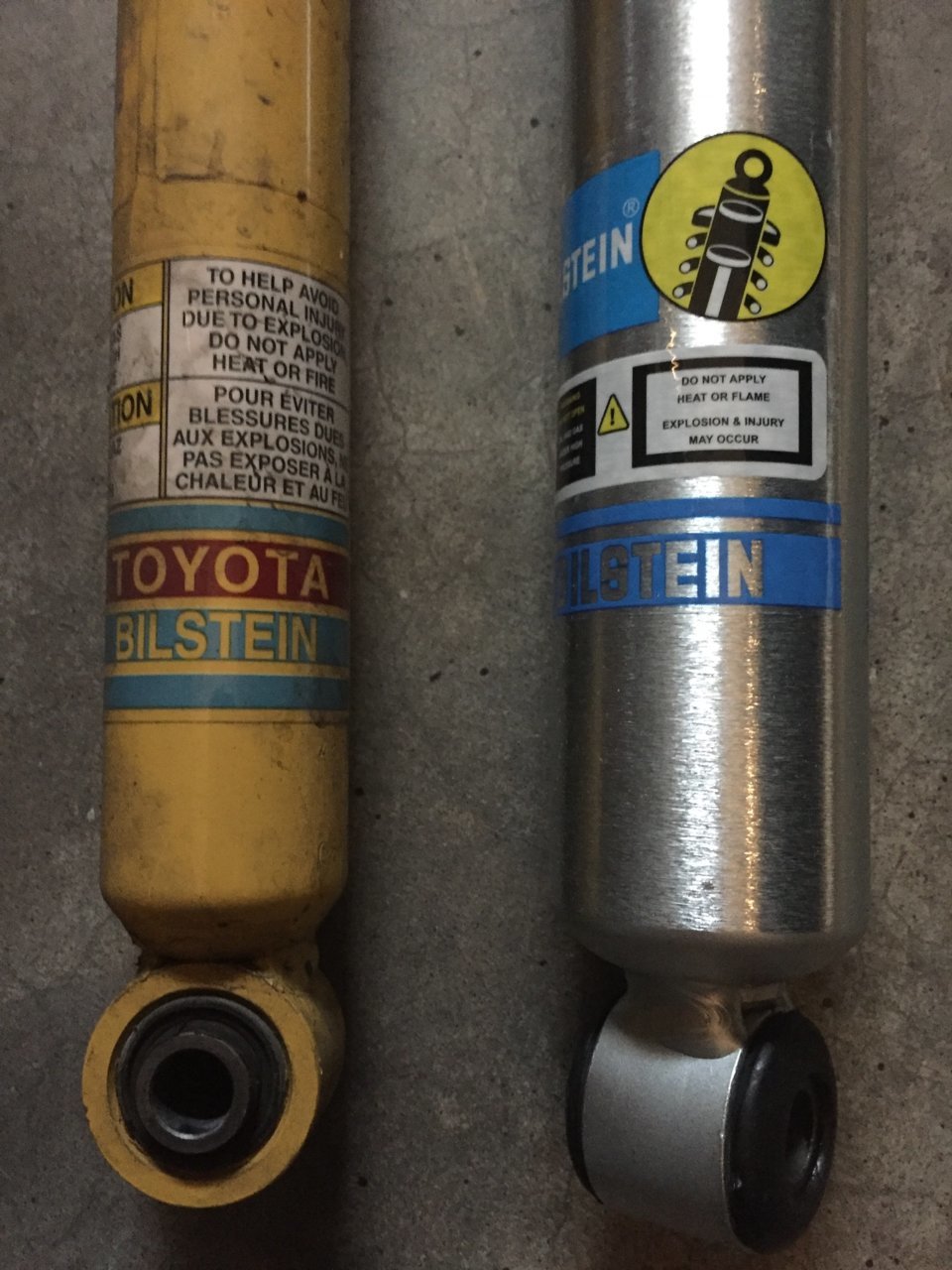

    I had stock shocks that failed on washboard desert roads many years ago and learned then that one needs to upgrade shocks if you are traveling many miles on that type of road surface.
    Some good roads with washboards are so severe that even at very low speeds it is difficult to maintain vehicle and steering control with stock shocks.
    The first improvement I made to my new Tacoma before purchasing better tires was to install improved shocks.
    The 5100s are a decent upgrade over the small stock shocks for now. If you want to be better prepared to make it back home without breakdowns, reservoirs give you increased fluid capacity and heat dissipation along with the ability to keep cooler. That provides much better peace of mind and can definitely be worth the money.
    Notice the warnings about heat and fire. Working the shock hard definitely creates a lot of heat and some increased pressure.
    Out with the new stock Bilsteins. Cleaned up and ready to get rid of.
    In with the newer 5100s.

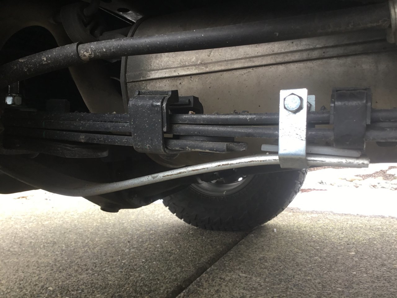

    I added a 1/2 inch block to the rear. In preparation for additional weight and to further prevent inverting the stock leafs, I installed these cheap helper springs which I found at a local auto parts store.
    The Helwigs might be better positioned and easier to properly place against the leaf pack. It would be interesting to see.
    These helpers required positioning the Teflon pad against the leaf pack keeper bracket. I used a Dremel tool to make a notch in the Teflon pad so it slides around the sides of the spring keeper rivet.
    I first tried the helpers positioned with the helper pad against and under the 2nd leaf itself, but it was moving forward, bunching up the pad against the bracket along with the spring itself resting on the rivet.
    They are working well as positioned now and are making no noise along with holding in place while keeping the 3rd leaf off of the overload spring.
    A bonus is that the clamp and spring might be helping to prevent axle wrap.
    I trimmed off the corner of the flat piece of the clamp to make sure that it doesn’t contact the shock.
    I’ll try this for awhile before looking at a single AAL, new leaf pack or airsprings.
