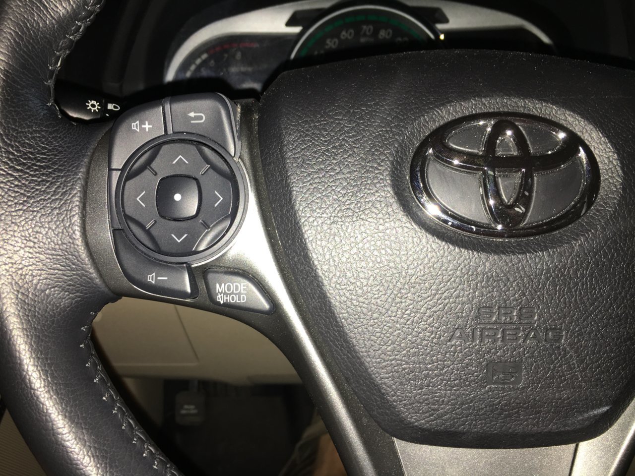

    2015 Venza is just about perfect. Thumb fits perfectly on Volume Up or Down buttoms, which are UP or DOWN. volume.jpg
