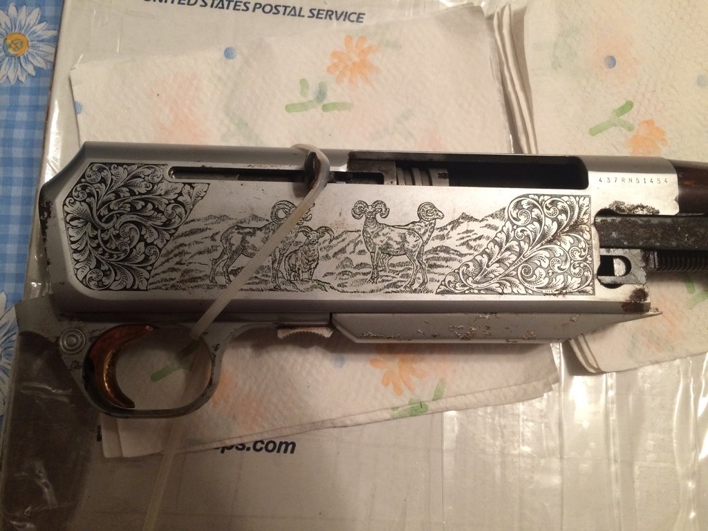

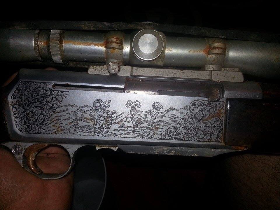

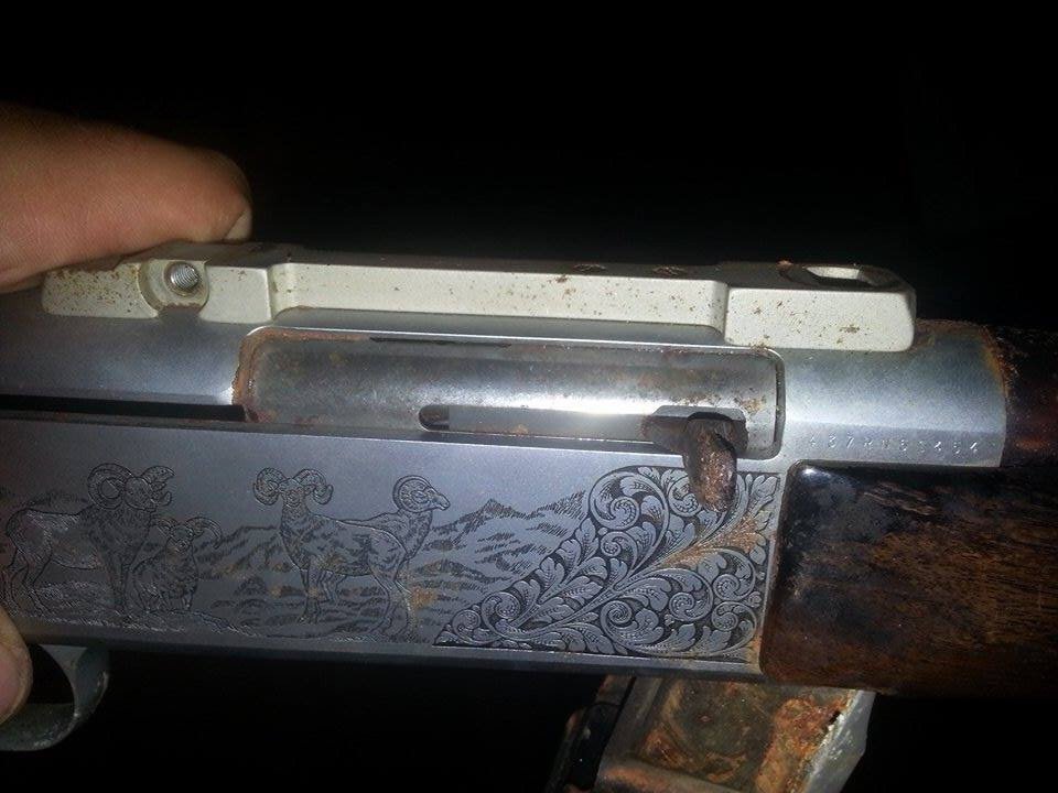

    So as some of you have seen in a couple other threads, I picked up what I believe is a Katrina gun. It is/was a grade IV Browning BAR in .270. I'll post pictures of the cleaning, restoring , shooting and anything else I think about for it. and for those who may ask, I have 270 in the gun, shipping, and transfer fees, the scope cleaned up on it so I figure I'm OK even if the gun is unsalvageable (though I think I'll be fine lol)
    please feel free to offer advice, give hints, ask questions, call me nuts for taking on this project, etc..
    The first pictures are what I got from the person selling the gun, he will hopefully provide me with a few more so that a better idea can be had of what condition the gun was actually in when I got it.
    just found out all his pictures have been deleted, oh well, I have some at least

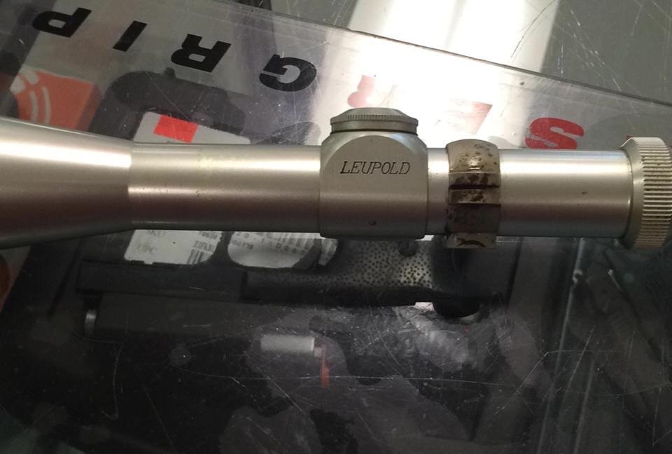

    scope cleaned up nicely, it originally had a yellow tint to the lenses and was rather nasty. After some 0000 steel wool and gun oil and a lens pen for the lenses, it cleaned up nicely. the last ring has one of the screws rusted in place and stripped out so I have not been able to get it out. if I can get the screw out the rings and scope mount should be salvageable for use if I can get new screws. would help the budget of the gun significantly.
    the scope is very clear and works great, I'd be willing to put money that this gun was submerged for at least some period of time and this scope came out fine.....and they say leupold is over priced....

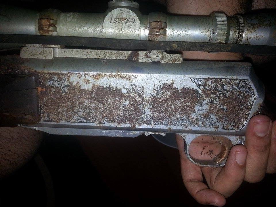

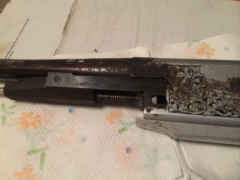

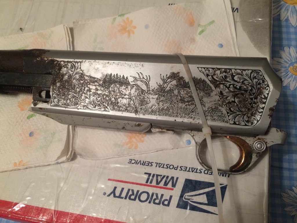

    these are pictures I took at home after scrubbing a small amount at the shop while waiting for a few things. a much better idea of the condition is seen here. I believe the gas block, gas piston, and 2 or 3 other small parts are the only things that will need to be replaced. the charging handle will also have to be replaced as we broke it while beating on it with a hammer to get the action freed up.

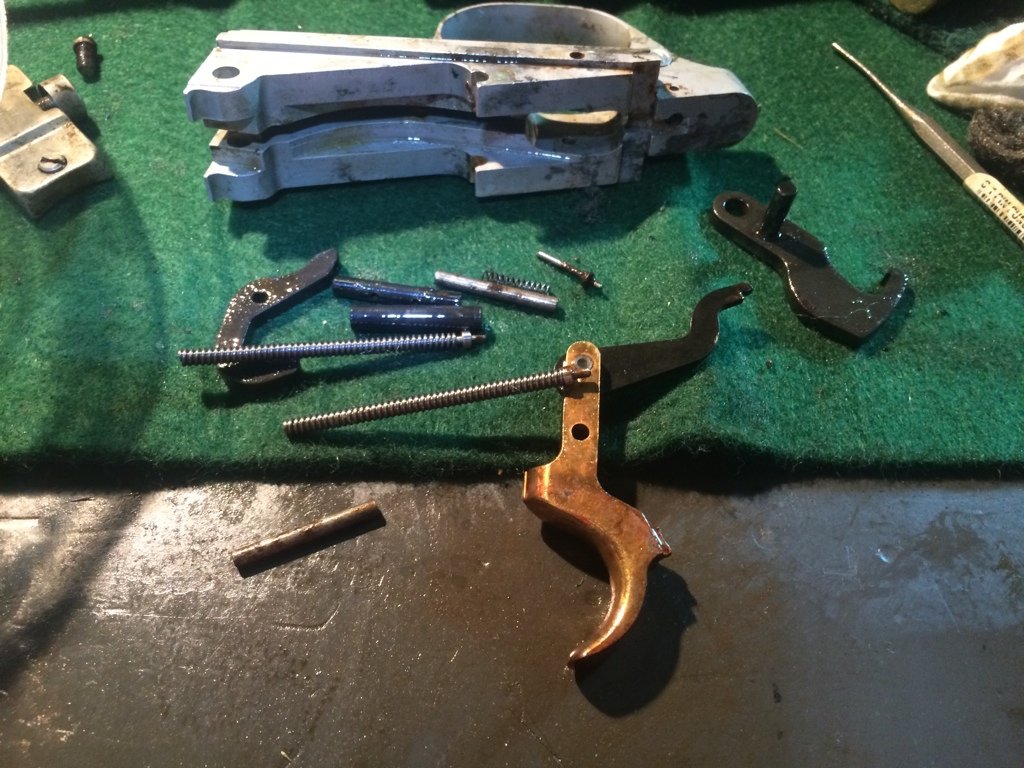

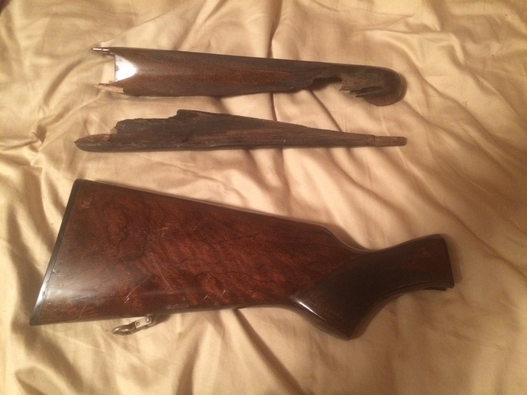

    this gives you an idea on the stocks, the salt water destroyed the fore end, but I believe that the buttstock is salvageable, so I am lucky there. I have also learned that boyd's gunstocks make stocks and forends for the BAR so I may get a set from them. I'm pretty sure it would be a lot cheaper than trying to get new ones from browning.

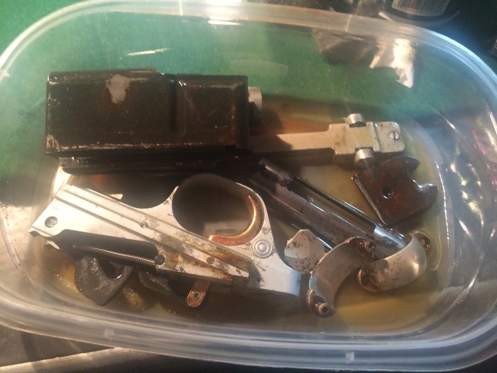

    most of the small action parts soaking in break free CLP, the entire trigger mechanism is freely moving though I may have to replace one spring.

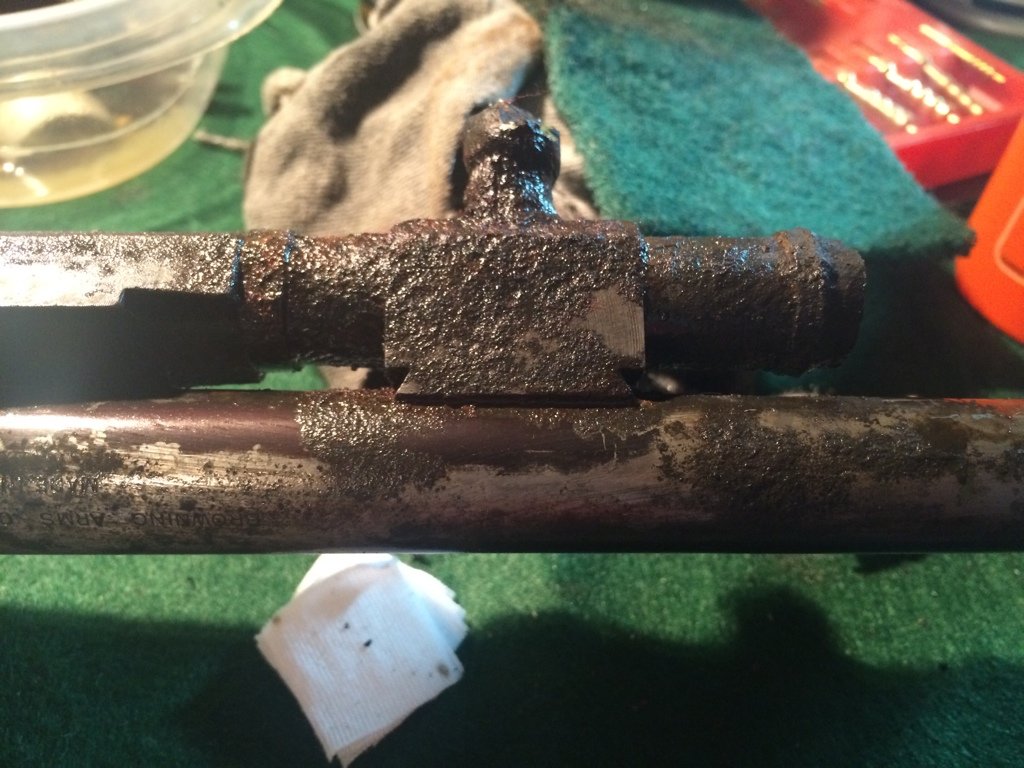

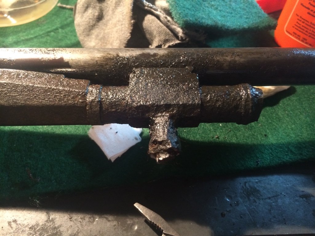

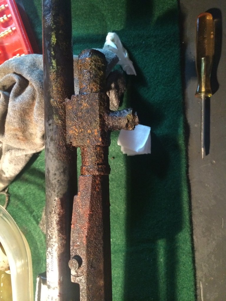

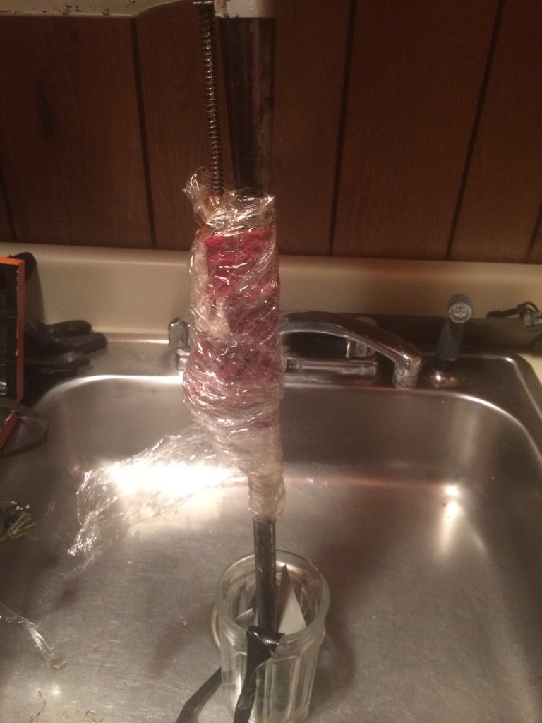

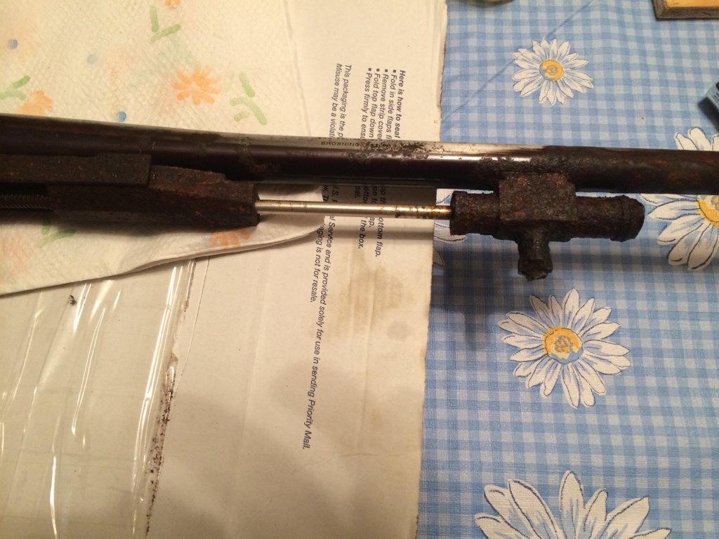

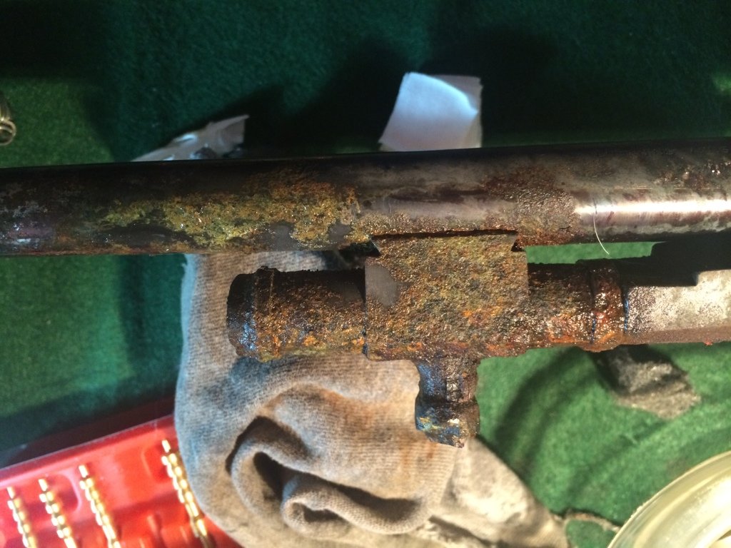

    I got some Evaporust from school today as well (in school for machining), I have it soaking on the gas block area. the red rag was soaked with it then the entire thing was wrapped in plastic wrap. if it works well, I'll get a bottle for myself and also soak the bore with it.

    option one is to bead blast the entire thing and parkerize it (lowest on personal scaled, but functional nonetheless)
    option two is to bead blast it and matte blue the entire thing.
    option three is to bead blast the barrel and matte blue it and try to leave the receiver as is
    option four is to bead blast it and then cerakote it, using stainless cerakote on the receiver and all receiver parts with the stainless cerakote and use socom blue on the barrel and all parts that were originally blued.
    option 5 is any mix of the above lol
    I'd love ya'lls opinions on it, the cerakote is winning so far in my mind. Any bead blasting I do, I will take into account the engraving and try to preserve as much as possible. if I go cerakote I may just polish and sand everything and not bead blast it.

    I'll an taking the red rag with the evaporust off this evening to see if it has done anything.

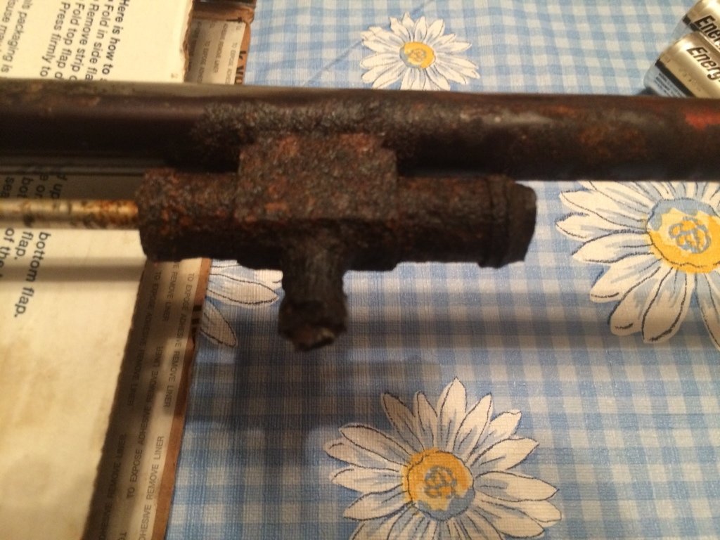

    Evaporust results before scrubbing.....I think I need to buy a bottle of it myself and figure out a way to actually soak the barrel instead of just wrapping the rag on it

    Wow. There is no way. How's the rifling look?? Gads. I bow to you in the greatest respect for even trying!!!

    And after just a couple minutes of scrubbing, I'm gonna buy some evaporust and figure out a way to soak the mechanism, it loosened a lot up

  20. Oct 8, 2014 at 2:25 PM
    #20
    crazyengineer
    crazyengineer [OP] Well-Known Member
    Feb 10, 2011
    #50948
    3,350
    patrick
    Bristol, TN
    05 Tacoma SR5 TRD Offroad
    K&N Cold Air Intake, Warn Winch and Bumper Guard, Wet Okole Seat Covers, Undercover Bed Cover, TRD Kenwood Head Unit, Infiniti Speakers, JL 13.5 inch pancake sub
    Trigger assembly is apart, I'm not going to take the safety out as it works fine and is completely free moving
