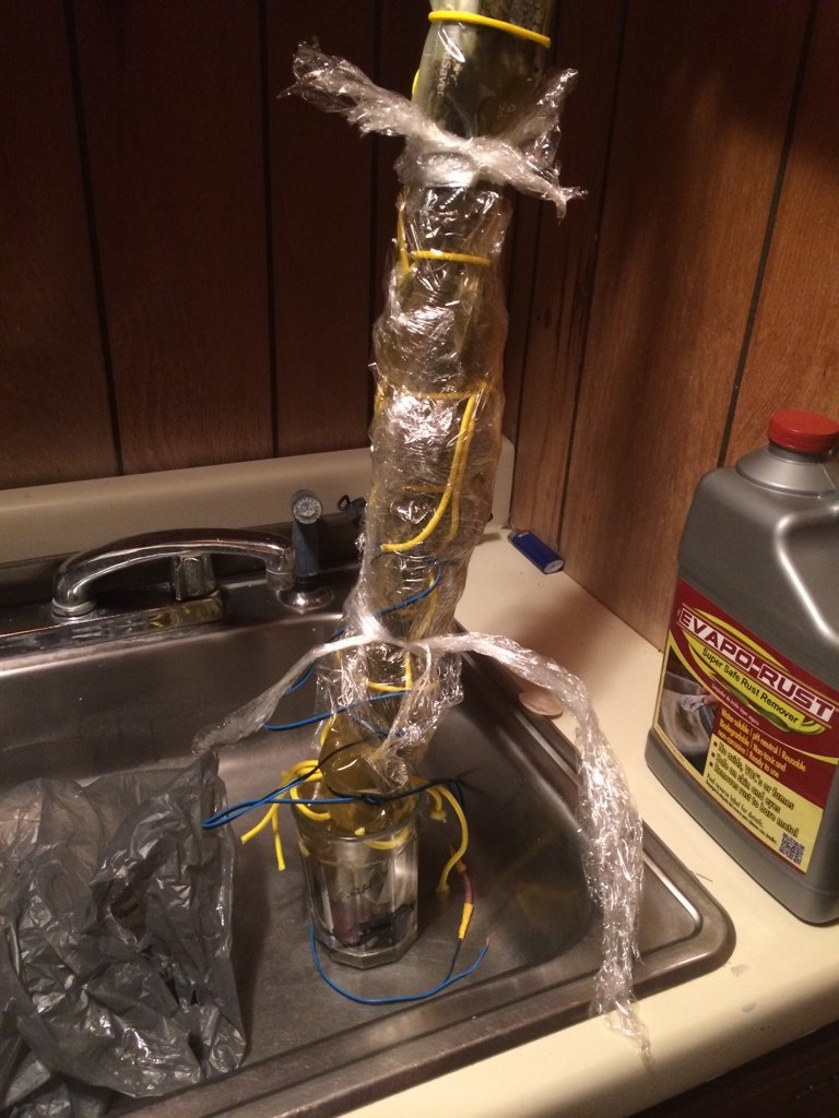

    Yay, more evaporust. I'll remove it Monday to see how it did, I'm going home for the weekend so can't check it then lol
    Had to improvise a soaking container with vacuum sealer bags and the cord to keep it around the entire gun

    Why not just get a piece of PVC and a cap?
  4. Oct 9, 2014 at 7:16 PM
    #24
    crazyengineer
    crazyengineer [OP] Well-Known Member
    Feb 10, 2011
    #50948
    3,350
    patrick
    Bristol, TN
    05 Tacoma SR5 TRD Offroad
    K&N Cold Air Intake, Warn Winch and Bumper Guard, Wet Okole Seat Covers, Undercover Bed Cover, TRD Kenwood Head Unit, Infiniti Speakers, JL 13.5 inch pancake sub
    Becaus te diameter of pipe I would have had to use would have taken too much of the evaporust....PVC pipe was my first thought. I looked for a few different options then said screw it and started improvising.

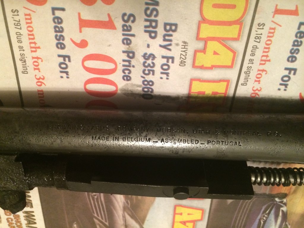

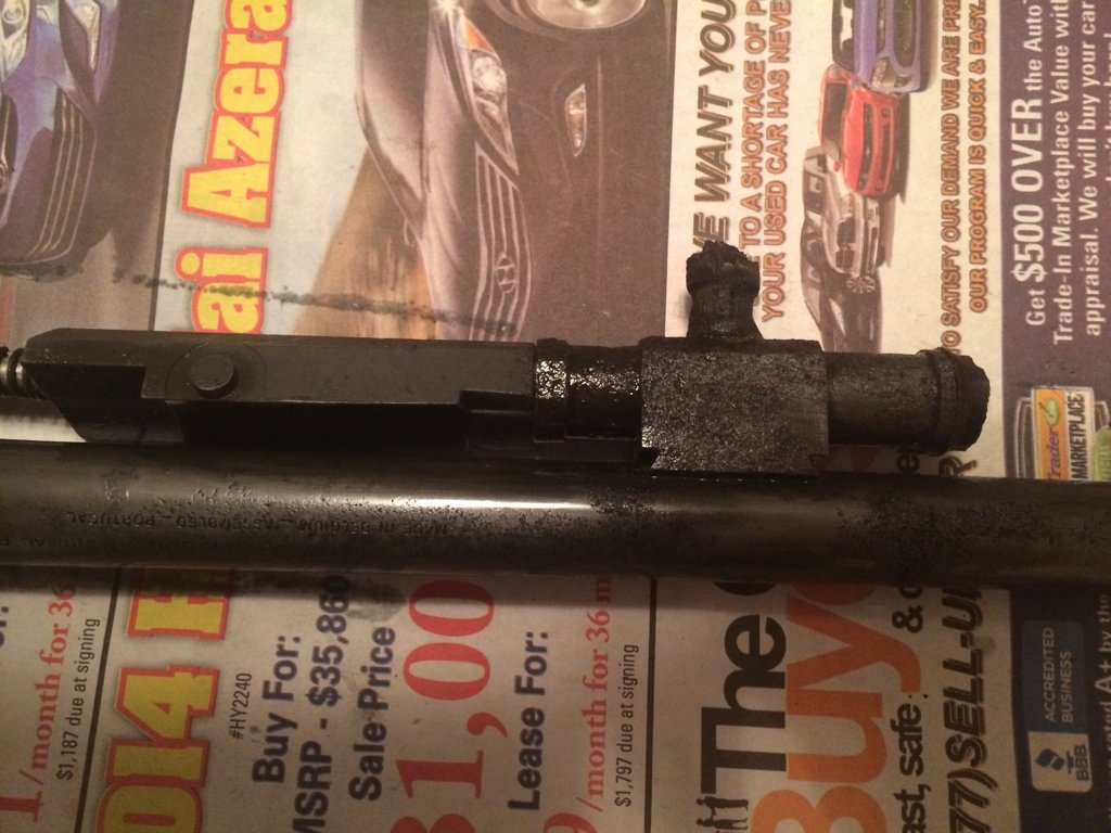

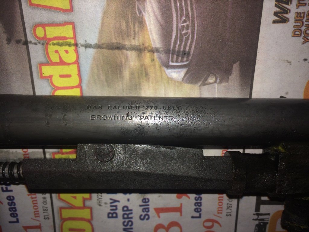

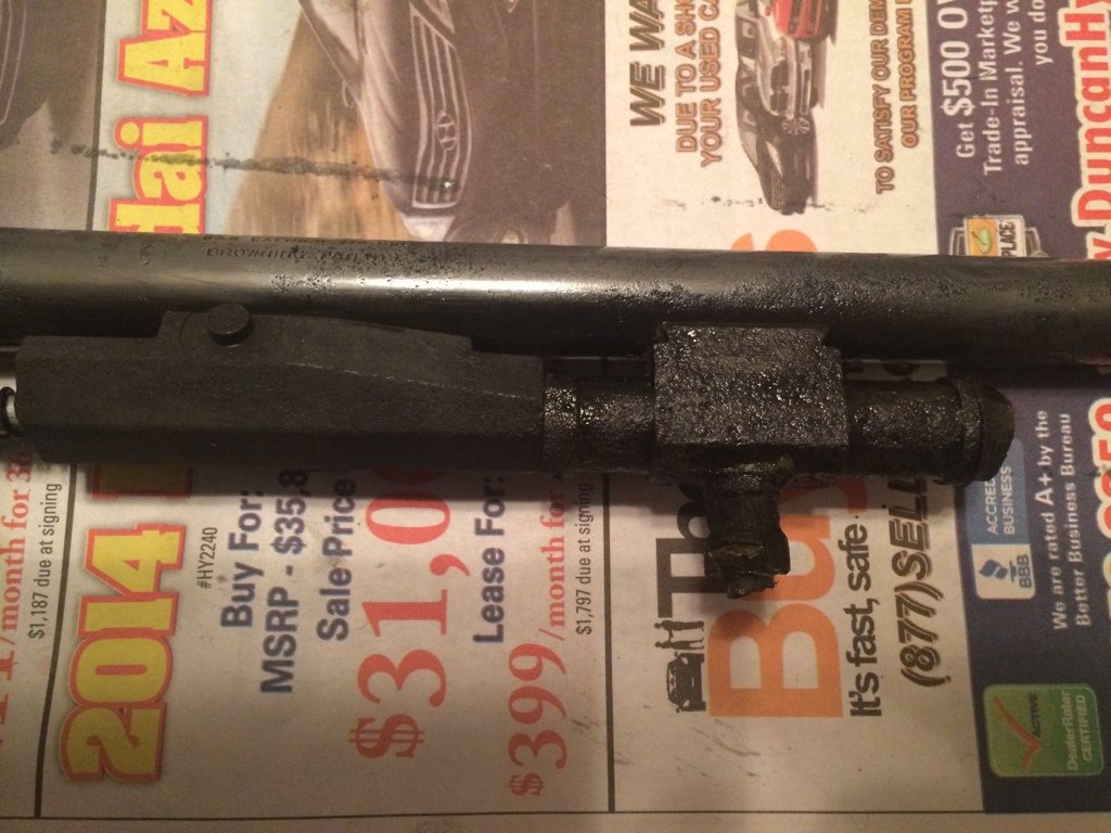

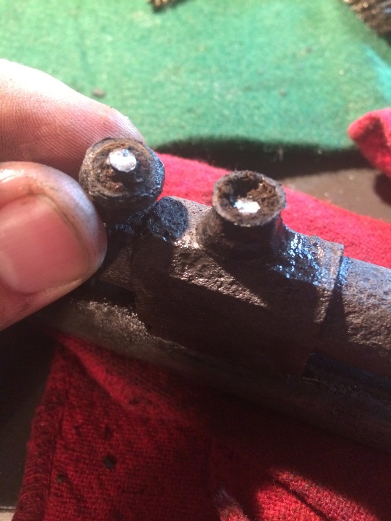

    Got some pictures for y'all, again. The pictures show what it looks like after soaking in the evaporust for a few days and a light rub down with 0000 steel wool and gun oil.
    All the markings can now be read easily. I plan on trying to unscrew some of the gas system to see if it is loose enough now

    To be honest I'm not quite sure yet, probably most of what you can see in the second picture.
    I'm a firm believer in evaporust now though.
    I'm about to see about removing some parts so we shall see how it goes

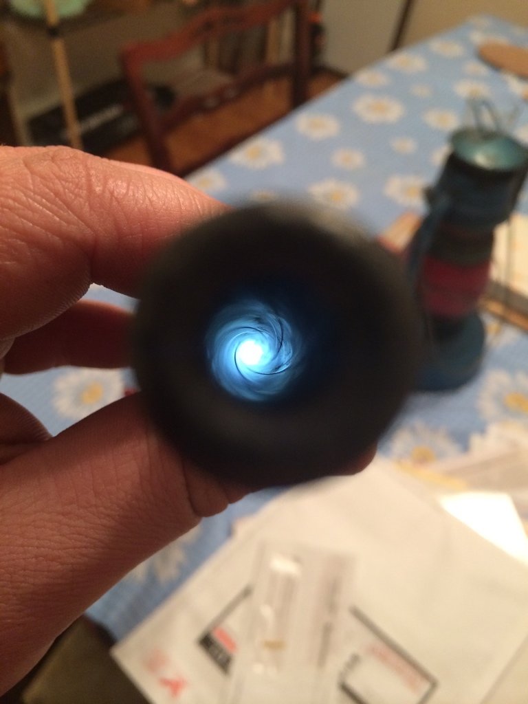

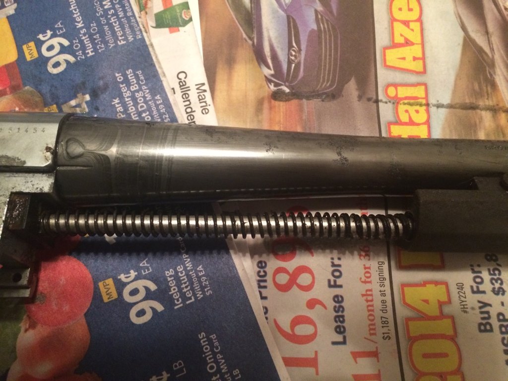

    So only thing I did tonight was pull a .30 cal bore snake through the bore (on another note a .308 bore snake will fit through a .270 if you have 2 people pulling....and it gets the bore very clean lol)
    Anyways, I tried to get a picture of the bore and this was the best I could get. After the evaporust and the bore snake it actually looks really good, especially compared to what I was expecting lol
    Oh, and do y'all think that a little bit of heat will hurt for trying to get the gas block off or at least the screws and bolts in the gas block? And I'm talking heat gun rather than torch
