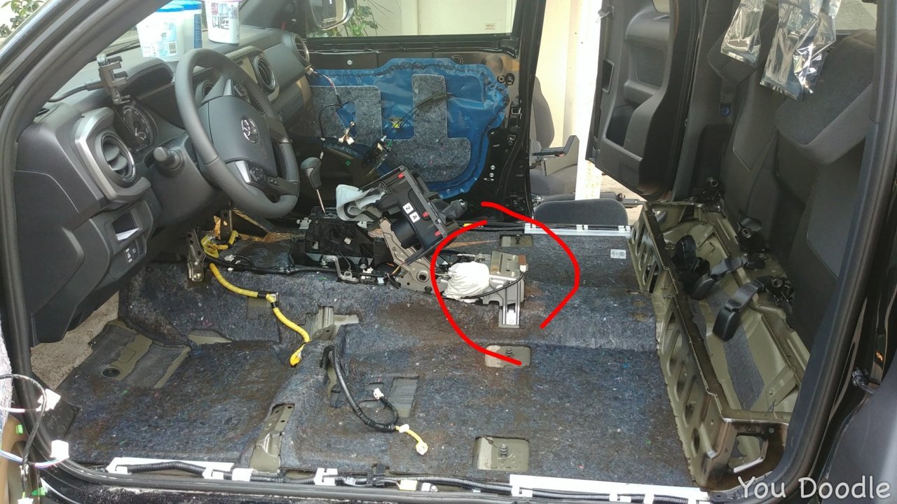

    Yesterday I got the cabin put back together miraculously without busting any of the plastic stuff or losing/gaining any screws. Also went to those off the underside again since the skid plates were off for the oil change.
    Today I got the differentials oil replaced and checked the 4WD system. 4Hi and 4Lo are working fine including the rear diff lock.
    Right now the only issue I've come across and can't troubleshoot is the AC outlet in the bed. When activating the switch in the cab the green light for 400W will illuminate only while the button is pressed but does not stay on. I've checked the fuses for the inverter and they seem fine. Does anyone know exactly which fuse(s) are part of the bed AC power system? I've scoured the web and mostly just get other people's mods posts or links to the owner manual that doesn't help.

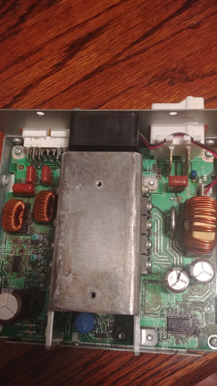

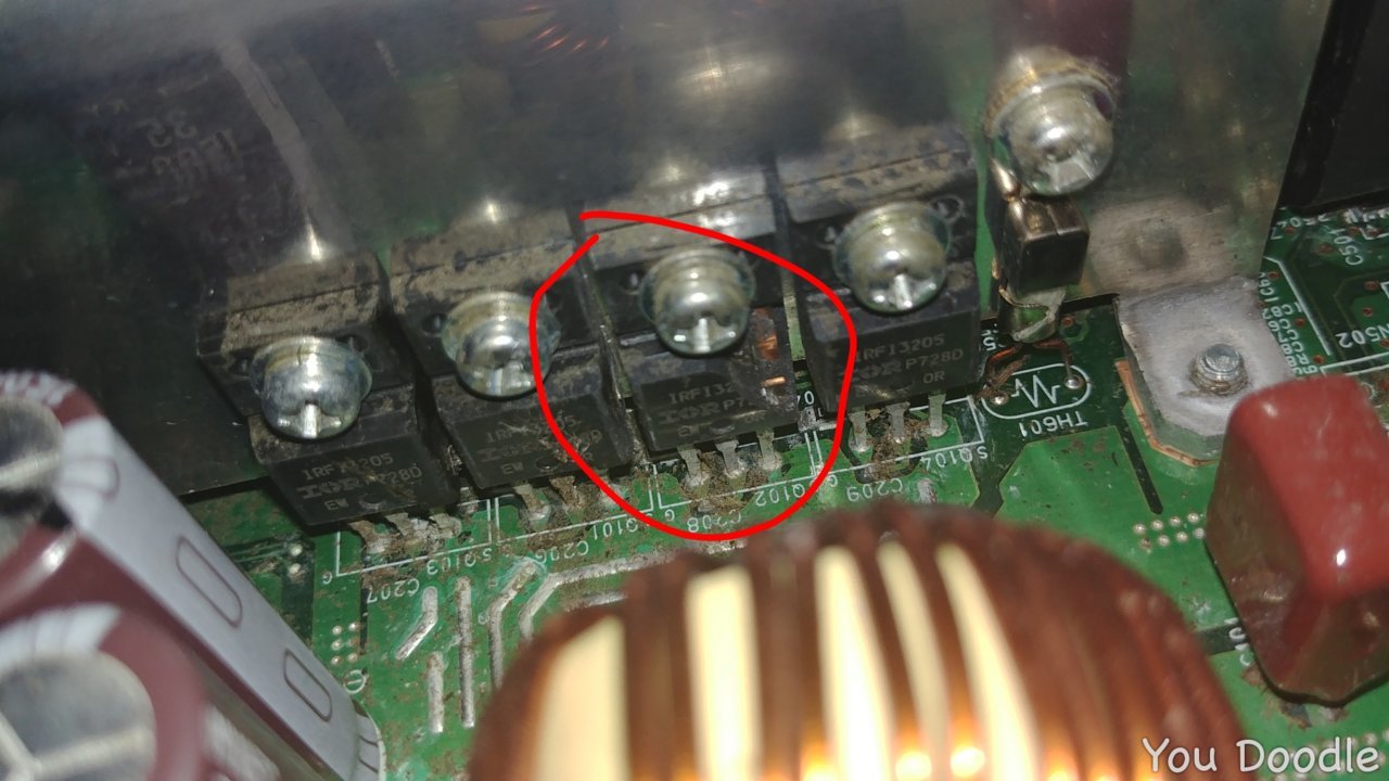

    After a little more research I discovered that the inverter is that grey box under the center consol. I know that area was submerged so I went back to retrieve it and this is what it looked like after opening. Besides the obvious scum on the chip board, I found that something blew up.
    My neighbor is a tv/electronics repairman and if it can be fixed for less than $100 I may do that, otherwise I'll put some aftermarket inverter somewhere. That's a job for next payday or later.
