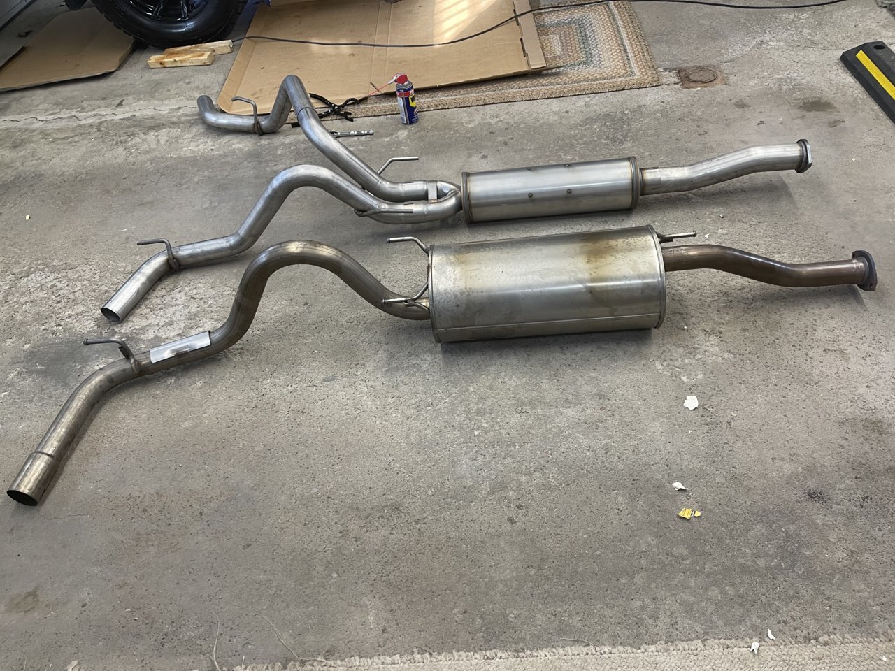

    How long does it take to install one of these yourself ?

    Catbacks now days are easy. Probably about an 1.5hrs

    Mine took about 2 hours, welded. The factory clearance between the driver's side frame rail and the spare tire is tight. The exhaust pipe will fit, but it helps to loosen the spare for extra room to mount the pipe and center between the two tailpipes.

    2hrs. Need a new socket wrench.. grrr. Could've been 1.5hr..

    Be sure to have it welded. I installed mine and she was in cabin loud. I took her to a muffler shop and had it welded in for $40. Now it's barely noticable. Super 50 series muffler sounds best on Tacomas.
