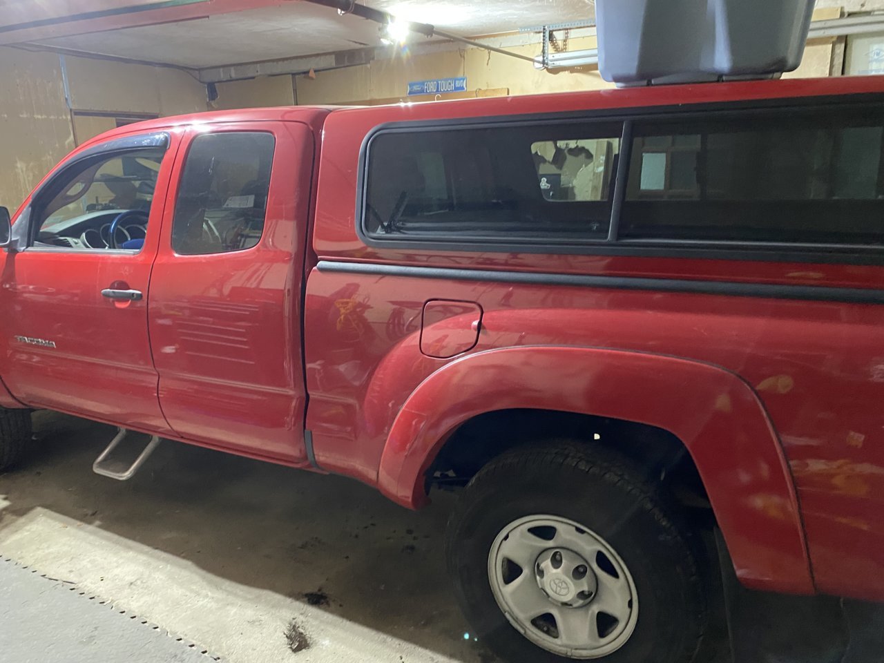

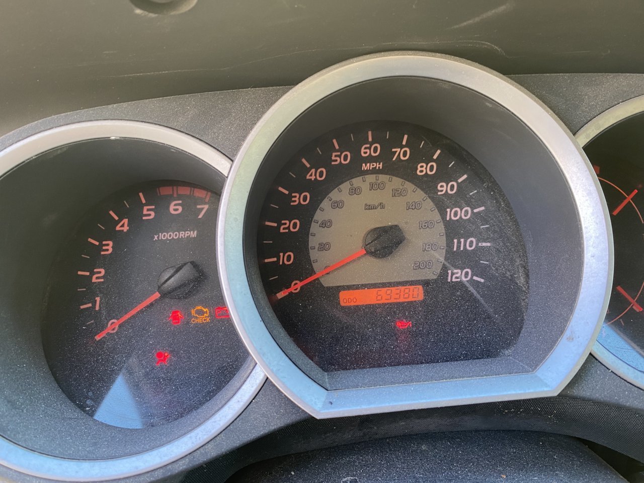

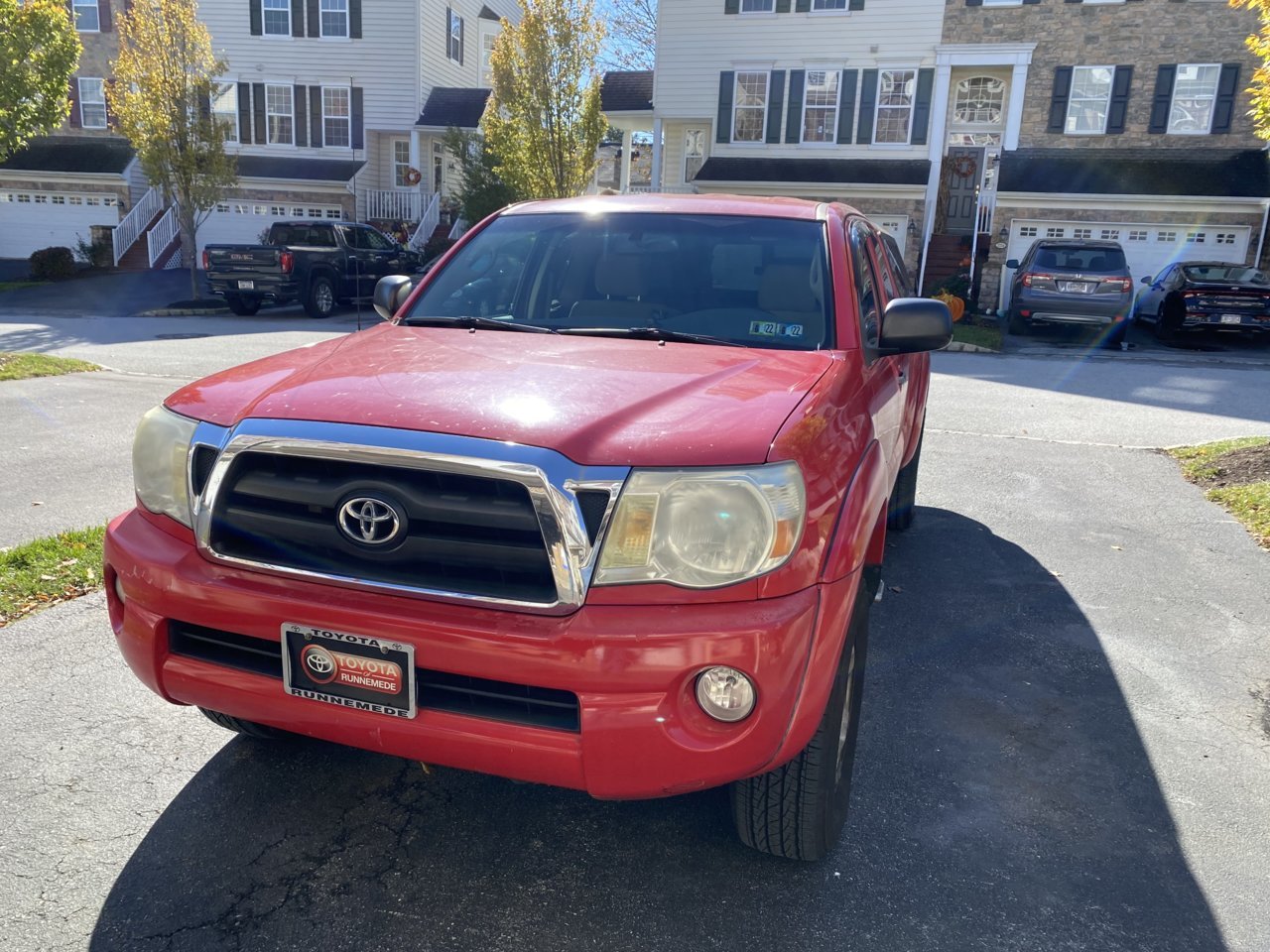

    I’ll start off with specifications
    it’s a 2007 prerunner SR5 with the 1GRFE engine and 5spd automatic transmission. Truck has only 69k original miles and all fluids I have checked appear to be very well maintained. I was not able to check the transmission fluid due to the transmission being sealed. However, I’d assume it’s up to par considering the rest of the fluids are solid. Truck also shifts very smoothly.
    Regardless, I’m changing all of the fluids and starting fresh so that I know the CI’s. I initially intended on going with amsoil for the engine oil and filter, but was essentially forced not to due to supply chain disruptions. No dealers I spoke to, nor the amsoil website, currently have the filters for the Tacoma in stock. The oil is in stock, however I don’t feel comfortable using amsoil oil without the amsoil filter. So I decided to go with pennzoil ultra platinum 5W-30 and a Napa gold filter. My question concerning this is whether or not you consider this to be the correct path of travel? My goal initially in wanting to use the amsoil was because of the cold weather protection and additive/detergents package that amsoil offers. My goal is to clean out any deposits left by other lower quality oils and then extend the OCI to 10k after the filter starts to indicate that there is no more deposits being accumulated into the filter. I believe that the pennzoil in combination with the Napa gold filter will at least do something, considering the pennzoil does have more detergents than most other leading oil brands and that the Napa gold is able to filter 99% at 30microns (although I may be wrong about this. This is just information I’ve gathered from a culmination of other forum threads. I couldn’t find any data directly from Napa or wix). I don’t want to continue to use other synthetics or Dino oils and allow more build up until I’m able to get a hold of amsoil. Do y’all think this is a good compromise?
    as far as the transmission is concerned, I’ve purchased a new transmission filter+gasket from Napa. As far as fluid is concerned, I’d like to go for a full flush and replace with either amsoil ATF or the Toyota WS. I’ve seen a few posts from people who claim that the amsoil ATF lead to better shifting and increased fuel economy, in addition to amsoil’s claims that it is better in cold weather just like their engine oils are. On the other hand, Toyota WS is cheaper and many people use this fluid for the life of their vehicle with no discernible issues. Thoughts?
    what I plan to do with the differentials is essentially a mirror of the trans. Either amsoil or OEM fluids.
    Additionally, do you believe that swapping to high end fluids like amsoil would aid in slowing engine/transmission degradation efficiently considering the truck has already had 70k miles/14yrs of normal wear from normal fluids?
    Honestly, this is the first vehicle I’ve ever had that has no fluid leaks, low mileage, no issues, and is just over all very nice and I’m trying my best to keep it that way and make sure it’s around for a long time. Sorry if the way I’ve conveyed information and questions seems unorganized and messy. I’ve been looking into this stuff for about 2 weeks. Like I said, my original plans were to go with straight amsoil for everything but that was disrupted due to current supply chain issues. So it allowed me to think a little more about the how and why. No information I’ve found has provided any semblance of certainty toward any specific product or method. Maybe this post will only stir the pot a little more. But I’m at least hoping for some sort of insight from persons more experienced than myself.
