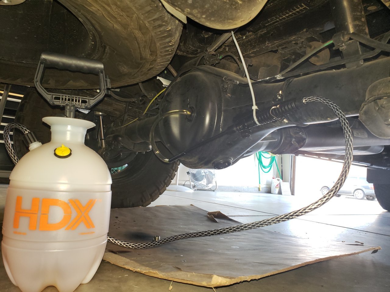

    Also for the diffs, @MtnFisher came up with this idea:
    I will be making my own for the next drain / fill.

    The mods that we are thinking about is getting rid of the trigger and just tucking the hose in the fill hole. From there, you would just dump any pressure when it starts to dribble.
    Also, installing a pull through schrader valve for a wheel. There, a very low pressure air source could drive the fluid without any pumping.
    I did mine with the handpump. It was a good workout and just took forever. Not to mention that I was refilling quart bottles for the hand pump to draw. :D I'm totally in on the sprayer.
    Also, @MtnFisher said that it worked great on the front diff.

    awesome. I’m gonna go to Lowe’s and grab a cheap gallon sprayer then. I have a spare schrader valve laying around somewhere too. I think cutting the hose before the trigger would be ideal and just release pressure as fluid starts to come out of the fill holes.
    this will save me a ton of time since I’ve got my truck and a GX to do, plus a 4th gen T4R soon too.
