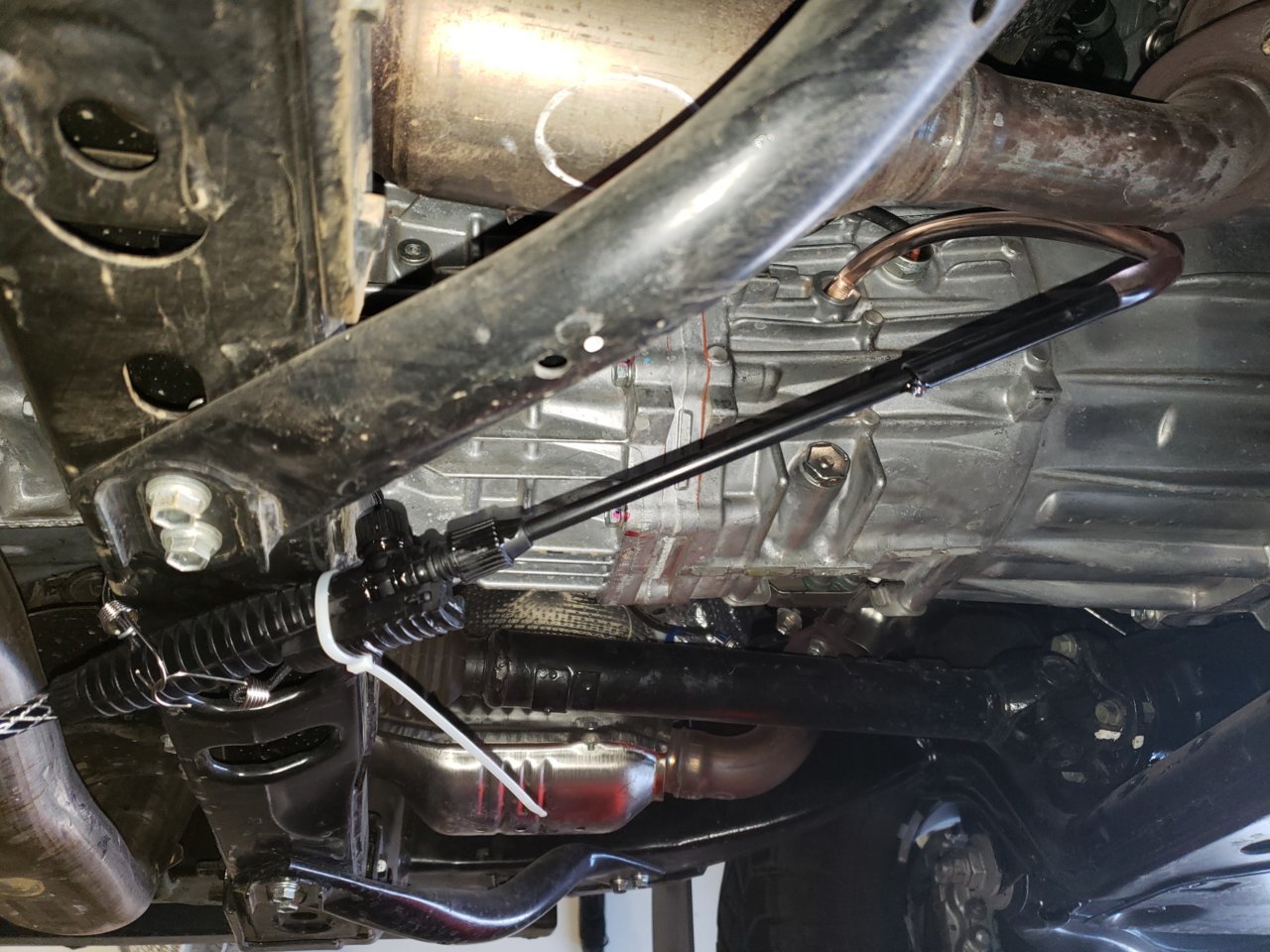

    It wasn't a waste of time or $$. I've done it many different ways since the 80s. I purchase by the gallon at considerable savings from online suppliers and don't lose any sleep either.
    I worked in fleet maintenance for over 20yrs and always had the luxury of pneumatic pumps and 55 gal drums so for home use this method works well for gallon jugs.
    Try getting your quart bottle in there wise guy:

    I've always used a pump for both differentials, the MT and transfer case. The quart pumps are more work than the weed sprayer pump. You should be okay using a quart bottle for the transfer case.
    Andrew is correct the quart bottles can clear the rear differential but you'll need some type of pump if you have a manual transmission. I use a pump for all gear oil changes since I've always had MTs and purchase gear oil by the gallon.
