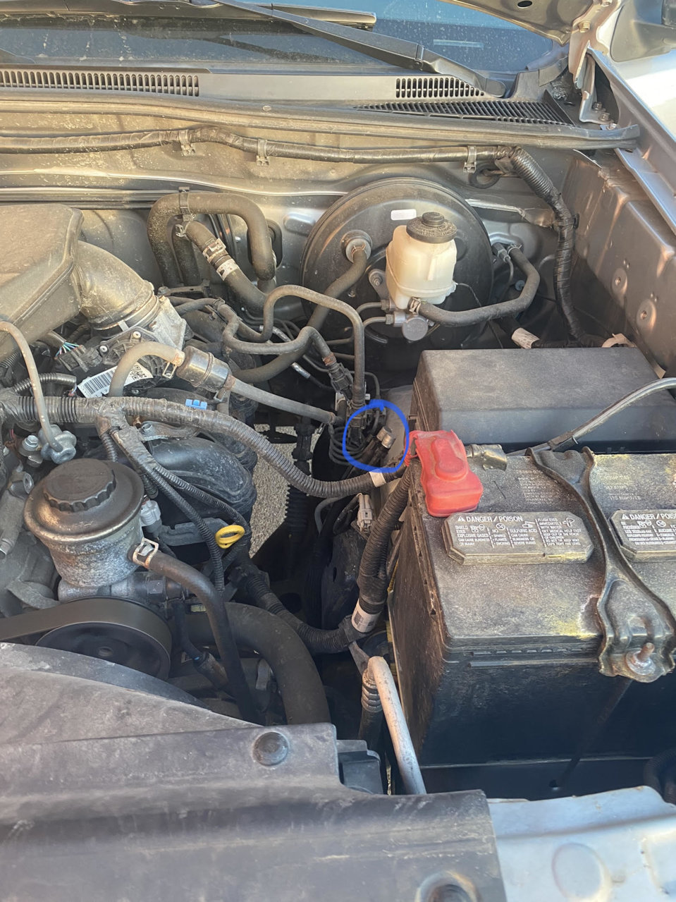

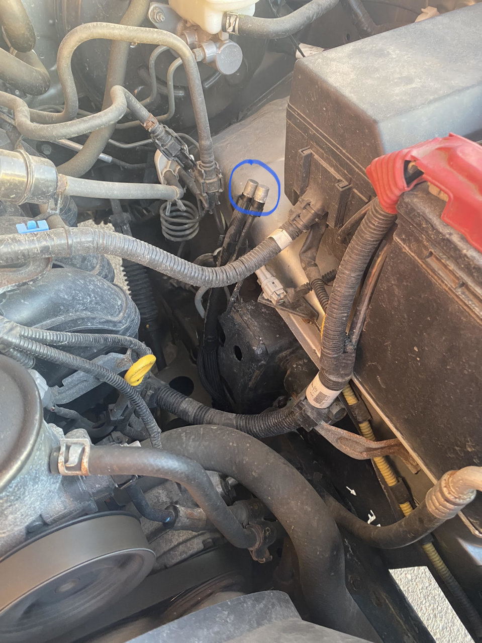

    Longtime lurker, first-time poster. Relative novice to trucks. 2014 Tacoma 2.7l 4cyl
    I was under the truck today and noticed some fluid leaking downwards from the battery area. Fluid didn't smell or feel like gas or oil. Upon closer inspection, I realized the fluid was coming from these two hoses encircled in the photos below.
    What are these? Do I have something to fix or hopefully just something to learn? Thanks.

    Those are breathers for front differential and Tcase.
    Over filling and heavy 4 wheeling can cause 75w90 to blow out on occasion.
