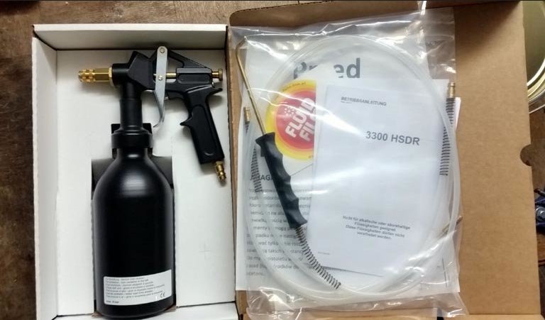

    I don't know Kellsport gun, but I'm using VAUPEL 3300 HSDR that came with wand and multi-directional spray tube.
    I still buy spray cans for "touch ups" (and hinges on the gate to my driveway :thumbsup:).
