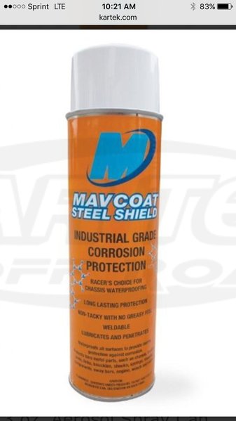

    image.jpg Has any one ever used mavcoat steel shield? It's pricey but I wanted to see if any one had a real experience with it
