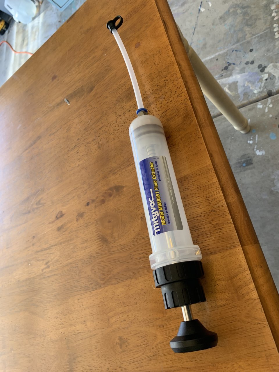

    Did my trans spill and fill today and I used this mightyvac extractor. The capacity is kinda low but what it lacks in volume it makes up in precision. Thing doesn't leak at all. Waaaay better than those shity hand pump things from the auto shop. Only thing u have to keep in mind is keeping the tip of the hose higher than the body so it doesn't drip out the end.
    Differentials would be a breeze with this thing. Power steering etc. It's able to be fully disassembled so clean up is easy and the hose on the end can be swapped out for a longer one. I love this thing. Go buy it! Just make sure to hide it from the neighbors, it looks a little suspicious.
