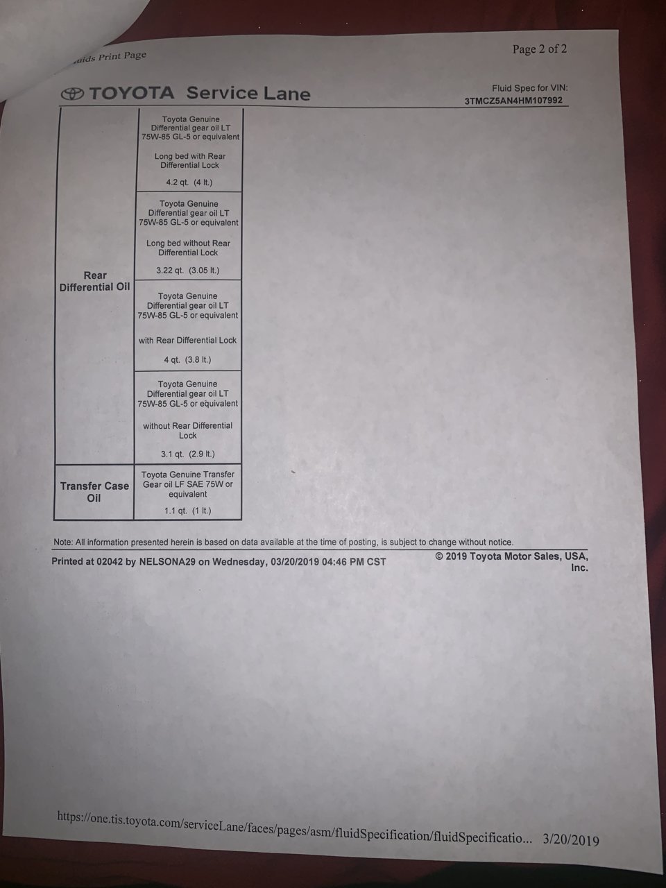

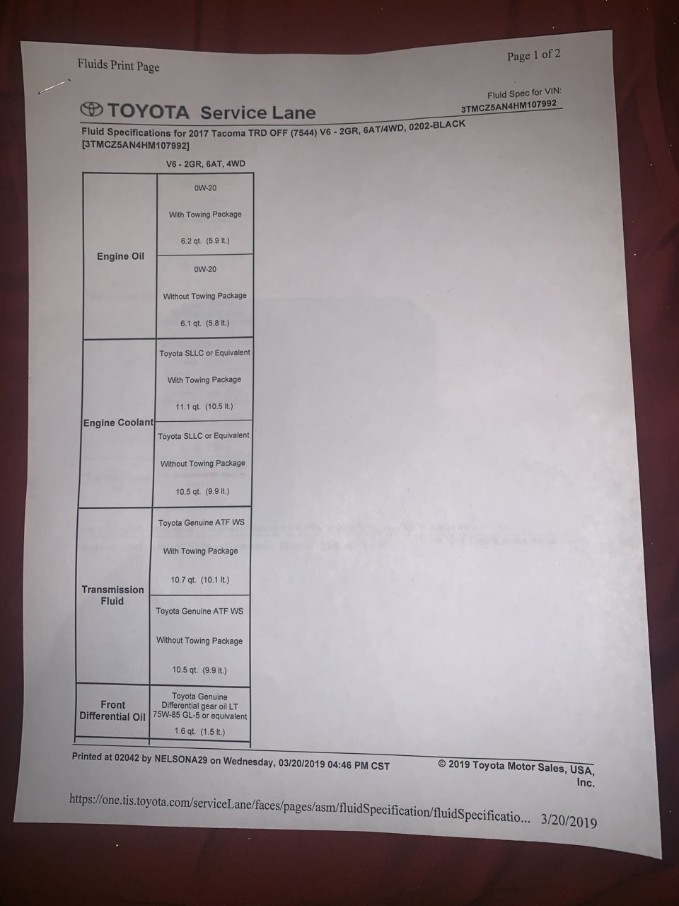

    Fluid specs for V6 AT 4X4. Might help some peeps.

    I am wondering why is the rear diff capacity different between a long bed and short bed ? Should be the same diff, right?

    I don't think it varies between beds, more like between trims. OR has the biggest diff that takes 4.2qt.

    Why would the long bed with a locker use more fluid than a short bed with a locker? It’s the same diff?

    I should have taken the time to read all 6 posts I guess. Still doesn’t make sense.

    Nope. MT vehicles, no matter the trim, have the same rear diff as the OR. AT trucks that are NOT OR or Pro have a smaller rear diff.
