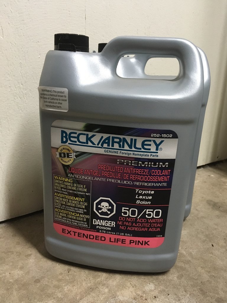

    Just remembered I have Beck/Arnley coolant in my Tacoma right now, but I was already ordering my pump from Rock Auto, and they had this for $13 per gallon so I just went ahead and ordered it too.
    Both of my Tundras have the Pentofrost A4 from Autozone I mentioned earlier though.
