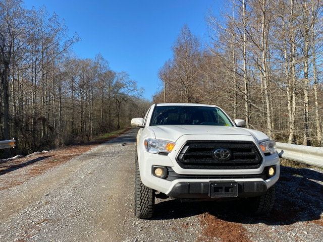

    Here's mine with 265/75/r16's on 16x8 zero offset, I'd describe it as "just a tiny bit of poke" which I like.

    Those look great, if only one could actually buy those wheels.

    0 offset is where you want to be if you want to be flush without poke. Negative offset looks much cooler though.
    My 17x8.5 -10's have a little bit of poke with 285/70's. With smaller/narrower tires they could be completely flush.
