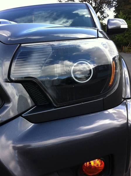

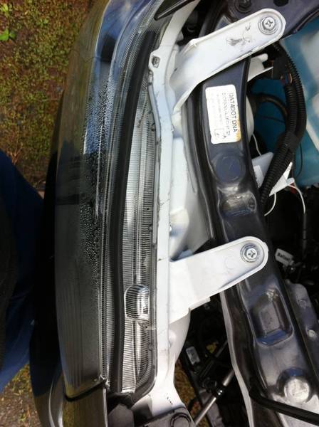

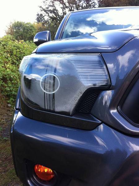

    Hey all hoping to get some help with my retrofit problem here.
    Back Story: I had these headlights retrofitted and built for me and they are awesome and have been working great no complaints. This person did an awesome job.
    I installed these about a month ago when it was still summer here in Oregon and the weather was warm outside. I washed it by hand and even took the truck through a few car washes since then and have never noticed any leaking or fogging/condensation on the lights.
    Well this week the weather has turned and for the past couple of days it has been cold and a little rainy at night and in the morning. That's when I noticed my lights have begun to fog and have condensation on the inside of the lens.
    All the seals looked good and I checked the bulbs to make sure they were in properly and everything looks fine. If it helps these are not OEM housings they are aftermarket.
    Any idea on what's going on or how to fix this solution so it stops doing that?
    also I noticed on my DTRL I have something "leaking through" it looks like gluing or adhesive thats going into the housing (couldn't get any clear pics of that though.
    Before issues:
    Currently:
    thanks for any and all input
