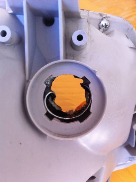

    So I took the rad lights out and when I went to take out my DTRL the bulb pop out into the housings and that's when I noticed the housing around the dtrl were melted and nowi can't get the actual bulb out any advice
    The bulb is the same from my OEM lights
    This freaking sucks starting to wish I just stayed stock

    OME Lift w/ Dakars, TRD catback exhaust, 275/70/17 with SCS Stealth 6. and much more.

    I also in order to get the drl bulbs out and to be able to put them back in I had to grind down a little bit of the housing where they rest after being placed in. Hopefully that won't happen again.
