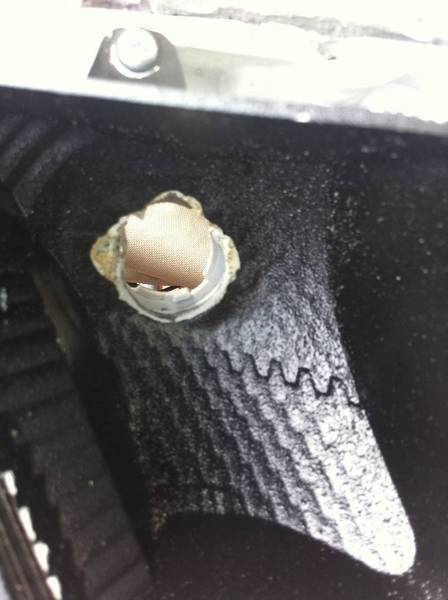

    I have angel eyes on my retros when I bake the lights are they going to be ruined?

    I baked them few times before and no problem. About your DTRL melting though it's actually the housing, not bulb. May i ask when you swap your headlight housing, was it an OEM for OEM swap or your OEM for aftermarket? Which you have now. here's what happened when i went with TYC aftermarket brand.

    No these are eagle eyes afm housing and yeah that looks like what happened to me. That's pretty crappy.
    I had to actually sand down the sides to get the bulbs out bc they pooped off
    EDIT: Here's a picture I finally pulled the Lens off today. Looks like we both have the same issue

    UPDATE:
    Okay so I finally pulled the lens off today (didn't bake them though used a hairdryer and it did the trick).
    I pulled the lens off and cleaned them up and also made sure everything was dry. I added some more sealant and closed them back up and also added more sealant around the outer part of the housing.
    On order are currently some silica gel packets and rubber housing caps from TRS.
    Hopefully maybe I will be lucky enough and not have any more fogging/condensation.
