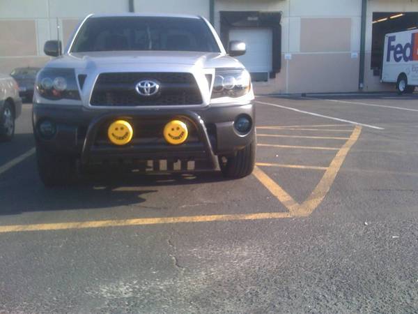

    Thanks for the reply Pugga I am trying to post a pic of it. I went through the forum looking at everyone's picture and my gap is much bigger. I am wondering if I just pull the light towards me more and just use a longer bolt as opposed to pushing to so far back as well Or just using the guard.[​IMG]

    Lol everything on dark knights truck looks amazing! were you able to see the pic I posted? This is what it looks like with the guards:

    Thanks dark knight are you able to see the pictures? Is there a way to make that look cleaner without the guard?

    I do see pics in this thread but none of them are under your posts??? The 510's are a little small without the covers on them I believe. PIAA does make a kit that includes the 540 lights which are a little larger to fill out the hole.

    Thanks for the info Dark I thought about the 540 but a lot of people said they were to big and stuck out too far. So I went with the 510's you should see the picture of the light without the guard and you can see the the huge gap that shows the whole inside of the factory whole. Is there way to tighten that up? Should I just use even longer bolt and just pull the light out further? My other idea was just leaving the guard on and move on with it.

    The whole issue with the guard off of the 510 is the stability of the light. After all, the mounting point is just plastic holding a rather heavy light acting as a heavy weight on the end of a lever. The farther the light is from the actual mounting point the less stable it will be. I had my lights mounted as far back in the hole as possible and used the guards as stabilization.

    When you put it that way, I will just keep the guards on :) thanks for the info now on to the wiring.
