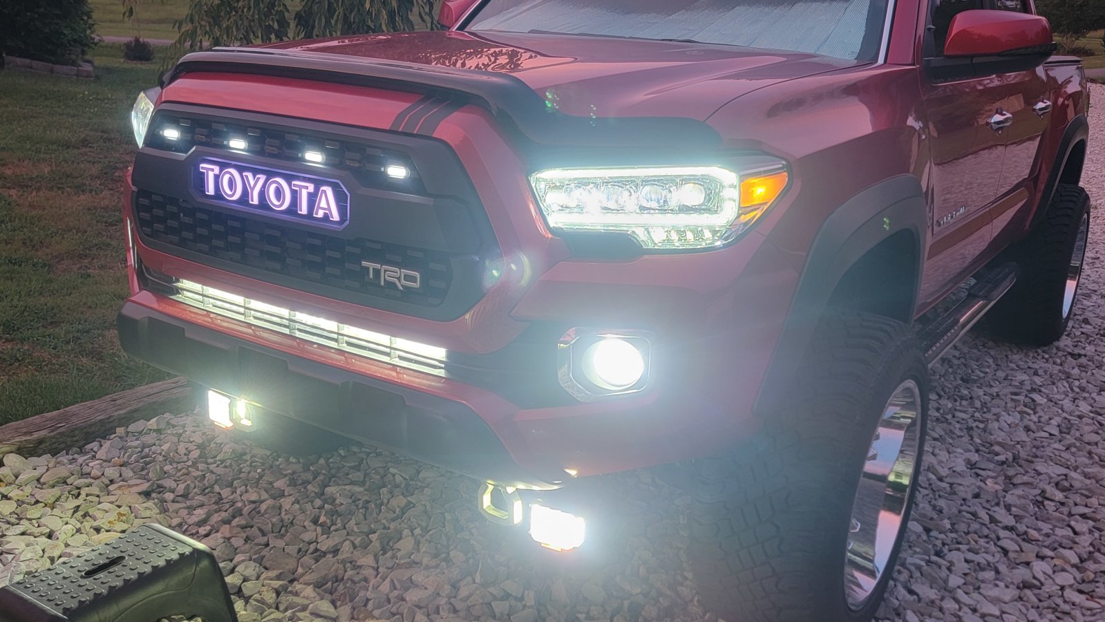

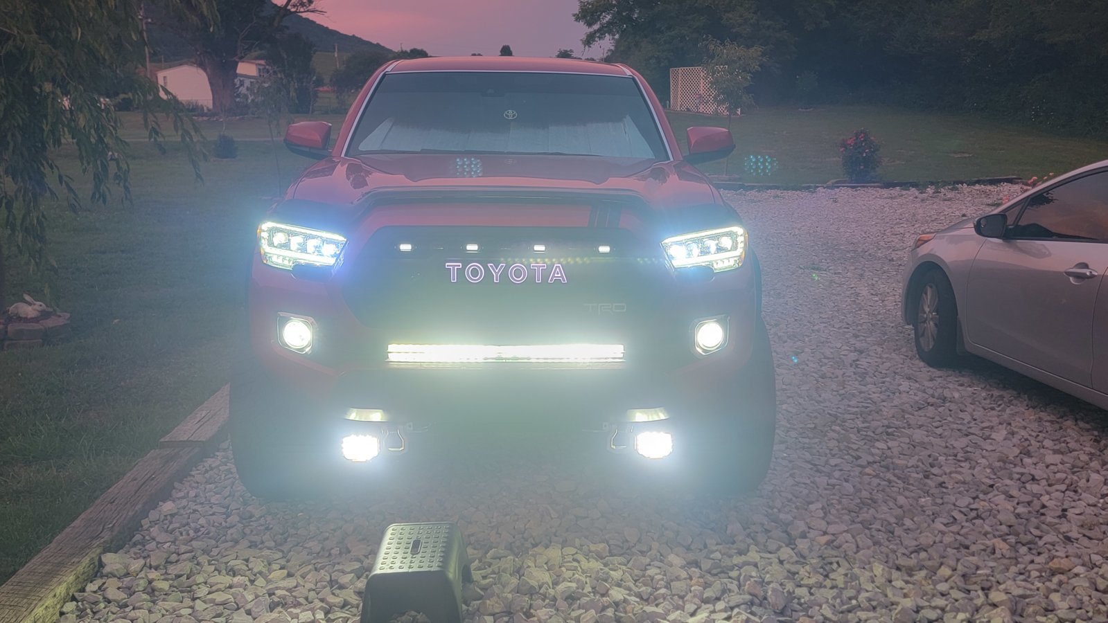

    Here's the Brights and fogs on at same time....This is the best mod I've done to my truck period...
    I also added LED LIGHTED PRO GRILL LETTERS

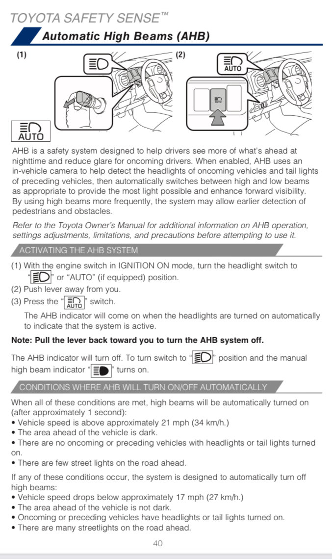

    Update:
    Short story: The anytime fog lights module was installed correctly and as it turns out, works fine on the 2023 truck.
    Long story: The TSS front camera functions weird with high beams because while driving you cant turn on the high beams at will. You can push the stalk forward for high beams but the front camera decides when no oncoming traffic is around and will turn them on or off when it wants to, so no manually engaging them. It works this way in “auto” or if you flip the headlights on manually on the stalk and push forward for high beams, the word “auto” comes on the dash so it ends up in auto mode either way you use them. I think that had something to do with him claiming they weren’t working except when parked and the vehicle off. He could get out of the car to see all the lights working at once, but while driving he wasn’t really aware of what was going on. I took everything off and popped the relays back in and the lights functioned exactly the same as far as how the high beams and “auto” setting works. Super weird that it’s designed that way but the anytime fog kit works as it should.
    I also learned that my buddy just leaves his high beams on and the stalk is set to auto, so he’s used to driving around the city at night with high beams on when no oncoming traffic is present. I don’t think he could tell when the fogs were off or on because of his high beams being used regularly at night, which were in turn disabling the fogs.
    Chalk it up to user error but nothing to see here :cheers:

    There should a button to disable to "automatic" feature of the "Auto High Beams"... at least my 23 Sport has one. "Auto" on the stalk turns my headlights on when it starts to get dark out.

    Does his model not have the switch on lower dash, left side of wheel to turn off the auto high beam function. I turned mine off the first week. Our 2016 Rav4 does not have the ability to turn it off unless you turn off Auto on the switch stalk.

    That makes sense there’s a switch to enable/ disable but I wasn’t made aware of it by him and didn’t know any better when I was there last night. I’ll ask him to check functionality with that button toggled off but at this point we know the all lights module is working. The auto feature on my 2016 doesn’t involve high beams and there’s no front camera, so his setup was unfamiliar to say the least! Thanks all for the help.
