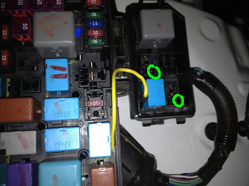

    Wait, scratch that! Someone has previously found it and took the liberty to post the pic with the highlighted pins which are hot on key on, they are both grounded with the key off.

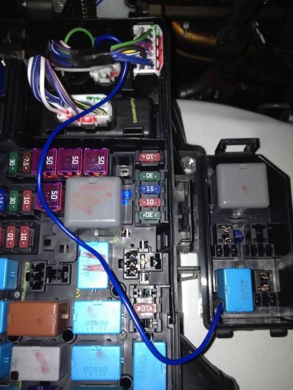

    I just did it to my 2013 with out heated seats
    I pulled the covers off both fuse panels, measured the length of wire I would need and crimped a female connector for the relay end and a blue male spade for the other end, I used side cutters to trim the width of the blade in half.
    Pulled relay out and bent the connector as described and slipped connector on & ran the wire to the other fuse box and pushed trimmed connector into green wire as described in other threads.
    I used a round file to file down half circles in the edge of the fuse panel lids for the wire to exit and enter the panels.
    Fog lights work at all times with or with out lights on and if left on they turn off when engine is shut down.
    I think I'll go put an in line fuse in the wire to be on the safe side w/a 10 amp fuse.
    Like this, this isnt my picture it was taken from another thread http://www.tacomaworld.com/forum/lighting/132862-fog-lights-w-parking-low-beam-high-beam-14.html
