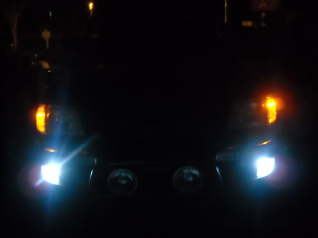

    i certainly did. but fyi you need the resistors even if you use normal 194/164 bulbs because they still pull less resistance than the original 1157 blinker bulbs.
    heres pics of them on

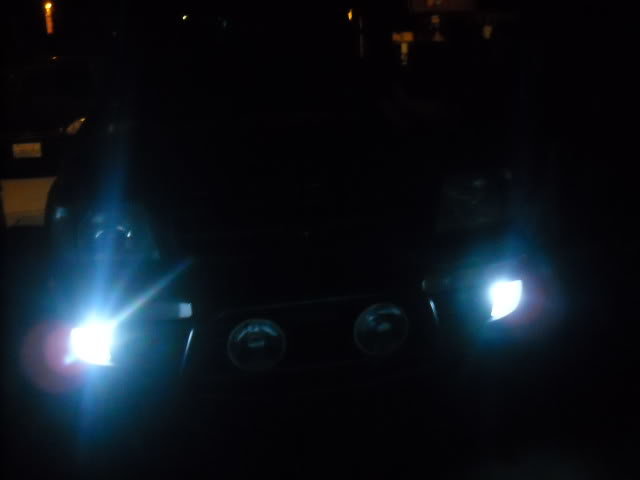

    headlights/ fogs on
    then jus fogs
    and with blinkers on..
