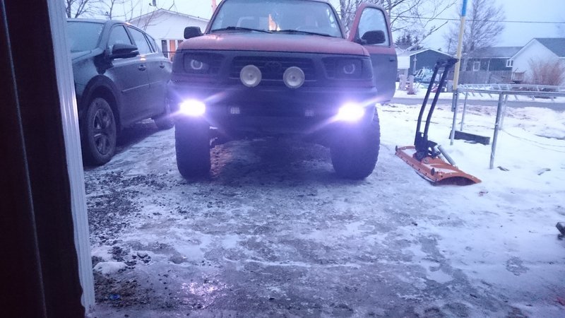

    Any pics of the lights shining on something?
  8. Dec 10, 2016 at 6:44 AM
    #68
    devinzz1
    devinzz1 Well-Known Member
    Jun 28, 2014
    #132892
    6,975
    devin
    lewisporte Newfoundland
    2023 aclb trd or mt
    icon stage 10 kit, toytec 1" bl, 35" general x3s, 17x9.5 procomp wheels, locker anytime mod, s&b intake, blackhawk 2.1 tune,
    NOTE: this is using some super bright leds. and cell phone camer makes them look alot bluer than what they are.

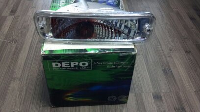

    did you end up swapping bulbs to something different? Read another thread where you were talking about getting something else, even different lenses.
  10. Nov 14, 2019 at 5:31 PM
    #70
    devinzz1
    Jun 28, 2014
    #132892
    6,975
    devin
    2023 aclb trd or mt
    theyre EXTREMELY hard to find but they did make clear lens signals with a nice reflector for 95-97 trucks. I was gona put some h4 projector bulbs in them. i got rid of the stock bumper before doing this though
