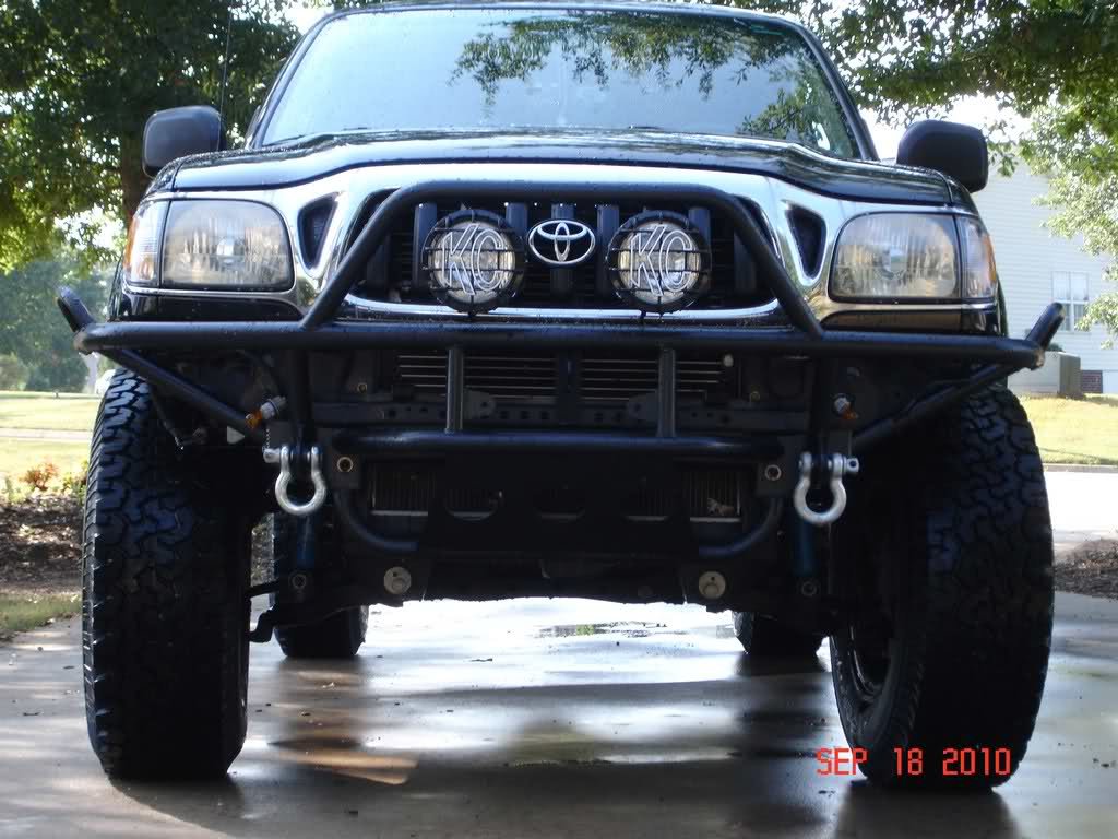

    I am interested in trying this mod today. However I am going to eliminate the fog lights all together and go with an aftermarket.
    As you can see in the pic since installing my all pro bumper, I have to housing for the turn signals. I dont care to weld and tabs to the bumper and mount the original turn signals as I would rather just mount aftermarkets in a spot where I like instead of being restricted to how long the turn signal wiring is.
    Does anyone know if the side marker socket and the turn signal socket are the same housings? Looks like there is enough length in the turn signal wiring to just pull it up a little bit and screw the housing directly into where the side marker light housing is. That way I womt have to worry about buying the resistor to slow the signal down.

    TRD S/C 3" sky jacker suspension lift,33" kumho road venture mt kl71's 16" 320c pacer wheels,billet grill,EBC slotted and dimpled rotors,super 44 muffler with gutted cat,smoked l.e.d. tail lights, deck plate mod with K&N filter,fog/blinker mod,cobra cb with 4' firestick antenna/100W PA,clear corners with l.e.d bulbs,55w back up lights,urd O2 sim., blue l.e.d bulbs behind gauge cluster.
    the housings are not the same so the only options would be to mod your existing corner light housing or do the mod and get the resistors that you can get from advance auto for $12 dollars. And the install only takes a few mins.
    Im wondering if you could use the (fog/Blinker) wiring to power your aftermarket lights so they would act like the fog light mod that every one else is doing but for your off-road lights instead. Not sure if it would be enough power though.
