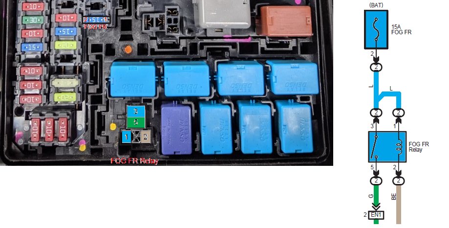

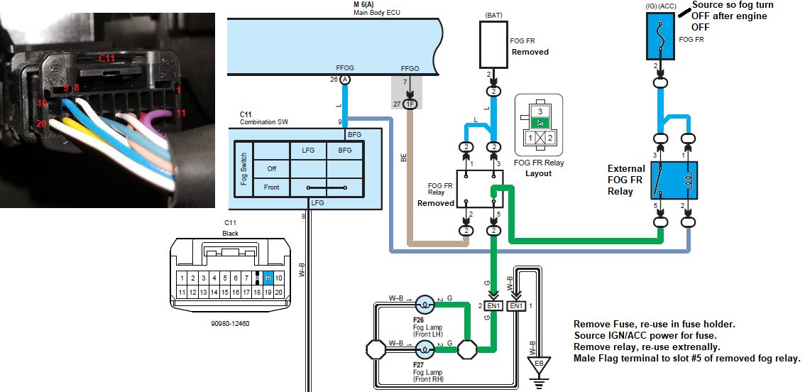

  7. Jan 29, 2021 at 6:19 PM
    caribe makaira
    caribe makaira Well-Known Member
    Feb 13, 2011
    #51121
    11,785
    Caribbean, Puerto Rico
    05 PreRunner TRD Offroad AutoTrans
    Hood Struts, My version Fogs always ON, Map & Overhead Light Mod,
    ACC/IGN source can be the Battery Charger Relay Output located inside the smaller relay box next to the Main Relay/Fuse box in the engine bay.
    One wire to the cab for switch.
