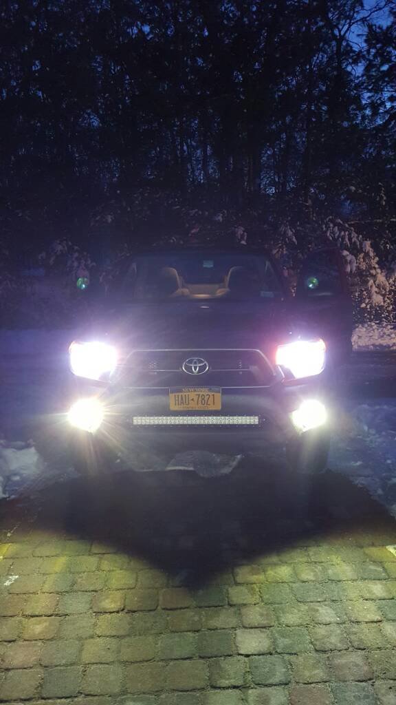

    I used this kit (http://www.amazon.com/gp/product/B00CQ8JSCK?psc=1&redirect=true&ref_=oh_aui_detailpage_o03_s00) on my 2013 2.7l AC. I didn't have any of the prewiring done, so I used the included harness. All I did was tap into ignition for signal, this way I could run them without the headlights on, but they shut off when the key is off. Super simple installation, and if you go with HIDs (I did 3000k yellow) you can actually discard half the wiring that comes with the HID kit.

    I got mine for Christmas, installed them that day. I swapped the bulbs for 3000k HIDs, but that was purely cosmetic. 68bb0931ca684f53a2be30b9c28eff4d_3b3e353b8b641f7e61064cf65d1f9f468af3e86d.jpg
