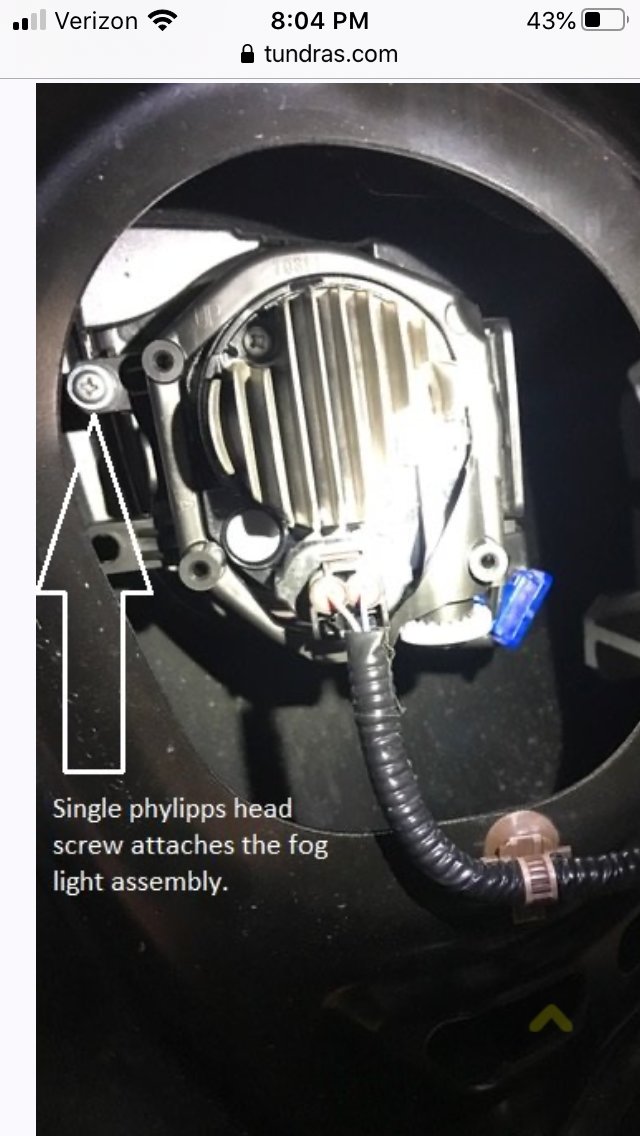

    I installed fogs on my sr, the hardest part was putting the screw in because it screws in from the inside.

    I think there are 2 holes for screws, but only the inside one for each fog light has it.

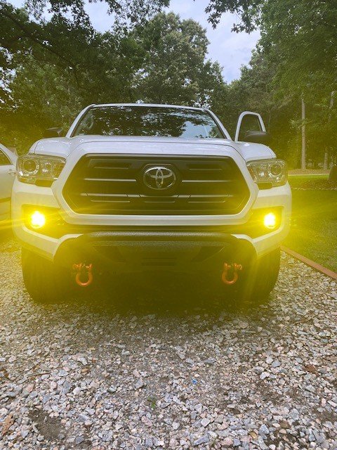

    My 2019 SR did not have screws also. I have a million screws around this house and I need a million and two. I will use nut and bolt with washers to secure the fog lights. Don't want to risk cracking the plastic with a wood type screw.

    I went to oreillys and used a license plate screw in each side.

    Thanks finally installed and after a trip to get some bolts I realized I already had some that I could not find earlier. Spent the last hour organizing nuts and bolts.
