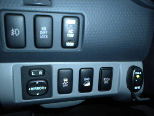

    Go look at my picks, they are from Painless , & a dremmell....LOL

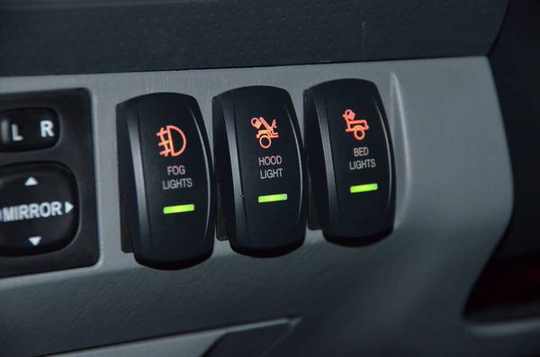

    OTRATTW Switches. I called and told him what I wanted on the switch and how it should work. He did the rest. Went amber when truck lights are on and green slit when activated so lights aren't accidently left on.
