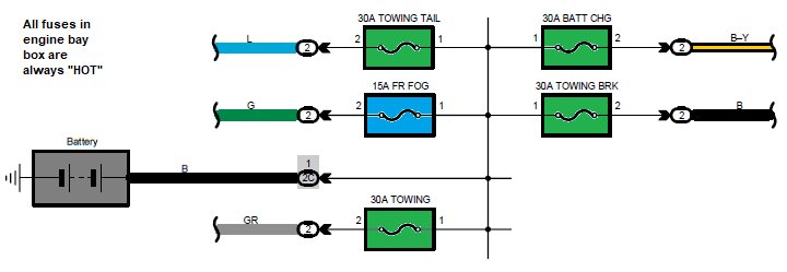

  16. Dec 13, 2018 at 11:56 AM
    #216
    caribe makaira
    caribe makaira Well-Known Member
    Feb 13, 2011
    #51121
    11,811
    Caribbean, Puerto Rico
    05 PreRunner TRD Offroad AutoTrans
    Hood Struts, My version Fogs always ON, Map & Overhead Light Mod,
    Towing Fuse is always HOT...
    txtaco87[QUOTED] likes this.
  17. Dec 13, 2018 at 12:33 PM
    #217
    txtaco87
    txtaco87 Budget Travel Hard AF
    Apr 21, 2015
    #153640
    4,291
    Nik
    Houston, Tx
    08 PreRunner DCSB
    PreRun hard AF
    yep which means anytime on, my Prerunner didn’t have factory tow package, so I just used that spot

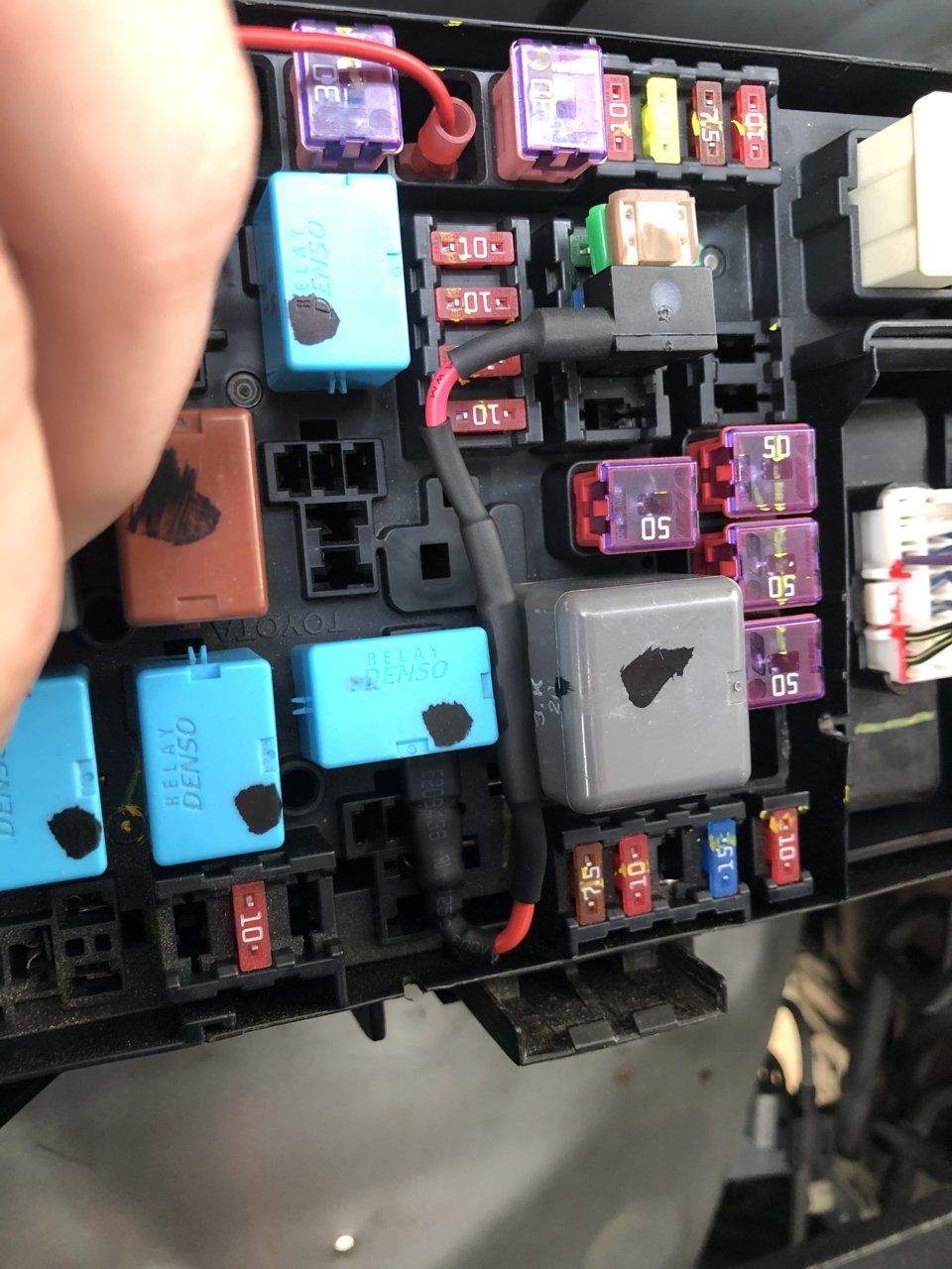

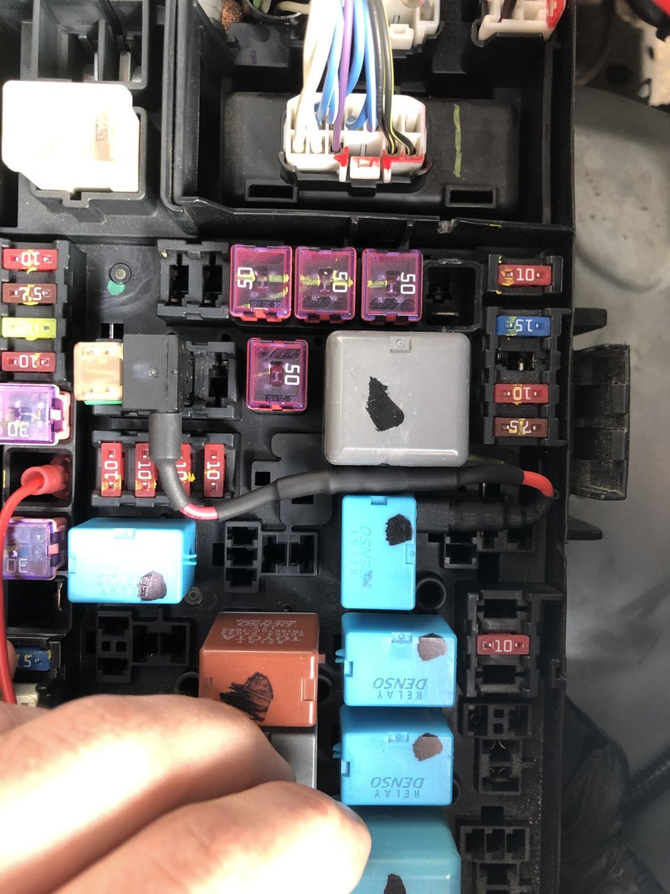

    Here’s mine
    36390232-CBC5-42CB-9444-E1213AC70FE3.jpg 897EAE8F-6D11-4272-A3AF-C798A087364C.jpg
    I’ve been using it in the factory tow package slot for a while, and so have others. Zero issue.
