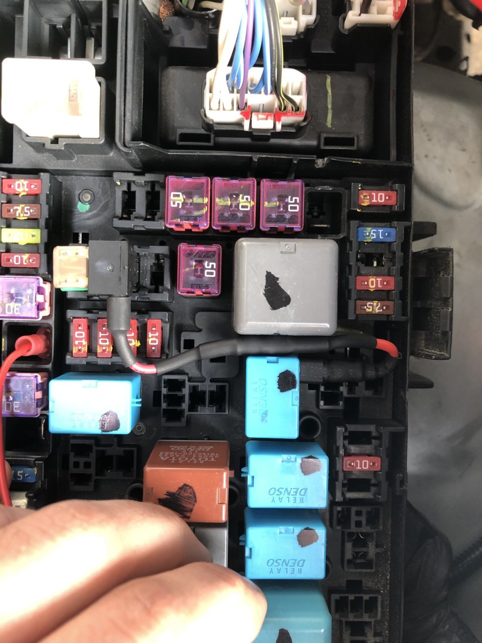

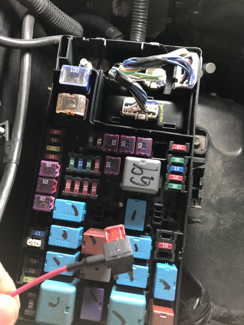

    I'm 99.5% sure from memory I tapped this one for my switchpro that needed an ignition on fuse. Should be EFI 1 or 2 if I remember.
    txtaco87 likes this.

    Well I tried to discourage the use of that one like the crucified n killed a post I had due to it tied into the fuel pump check after off. So if you leave the switch on to the modification, it'll energize and have the neighbors and what not calling you that the lights came on by themselves and many other stories...so go for it.

    This is true. All who mod be warned. My switchpro interior panel backlights every so often because of that.

    Not bad from a year ago when I did it!

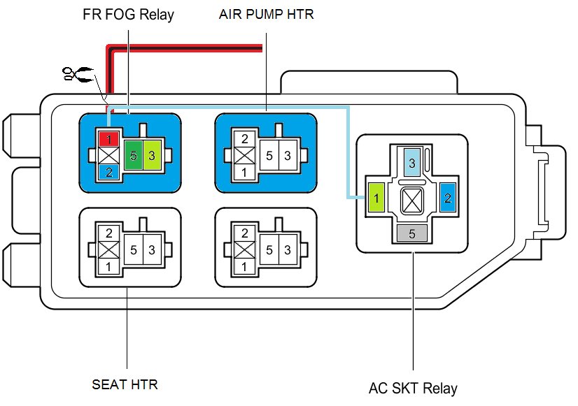

    I think the relay will be in the way for the add-a-circuit, the other way might not allow the cover to close...

    I believe most are using the add a circuit in the fuse panel under the steering wheel.

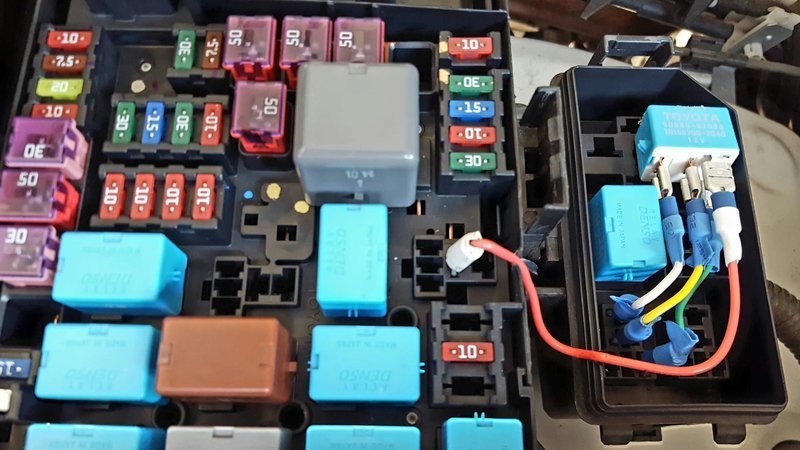

    Just throwing this out there for anyone, but I just added a separate wire harness to the fogs since I needed a relay for my lighted switch to work property. It was pretty cheap. Now they can come on even with out the keys in the ignition.

    My truck is a '13, so my fog light relay is in the separate smaller fuse box mounted next to the main one. I found two empty spots that do have 12v clips but they're hot all the time. While I'm sure I wouldn't forget the fogs were on, I like the idea that once the key is off they are as well.

    Yes, that was one of the 12v spots I have as well but it's not keyed. If all else fails, I'll use it. I'm curious why you didn't just depin the oem wire out of the relay, instead of having to add all those spades?
    txtaco87[QUOTED] likes this.

    That picture is from @ChadsPride anytime fog mod, he has a newer truck and has that smaller relay box that I don’t on my 08.
    This is mine, I bent the one tab over and used an add a circuit. No permanent changes made, if you want to reverse it just put another relay in
    And I didn’t de-pin the terminal since I didn’t feel like opening up my fuse box to do it. This was easier
    Slowly bent the silver pin out 90*

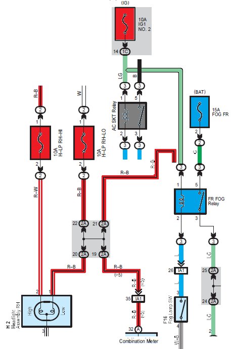

    You forgot to cut the wire going to the fog relay terminal that you joined to the inverter ign source. Do not forget to insulate the cut ends.
    VHiN[QUOTED] likes this.

    yes I didn’t disconnect that one. I have to try it again tomorrow. Thanks

    Now she’s lit. So happy about this, thanks for the help!
