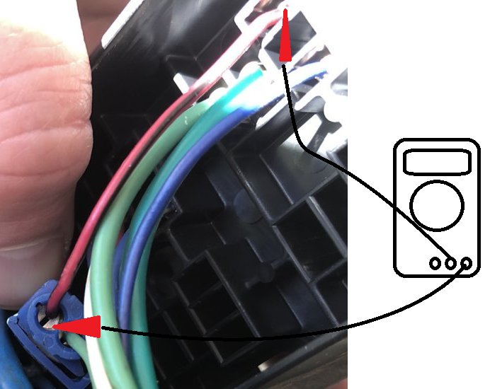

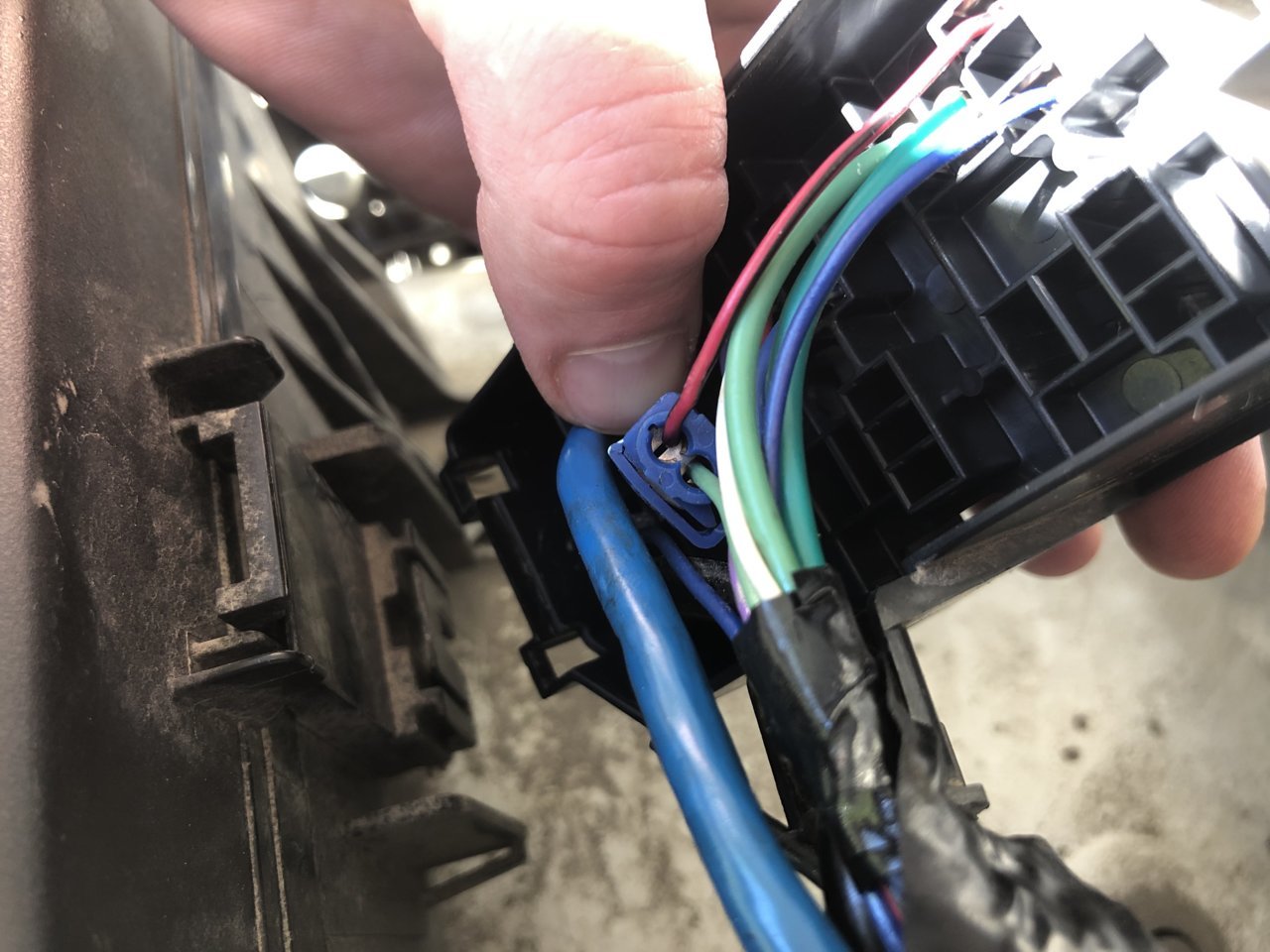

    Can anyone help me out here, quick tap into ac inverter, looks and feels like a good connection. Fogs won’t come on, yikes.

    With a multimeter, verify continuity from metal of Tap to terminal.
    Maybe the tap did not cut into the wire.

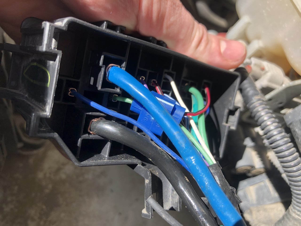

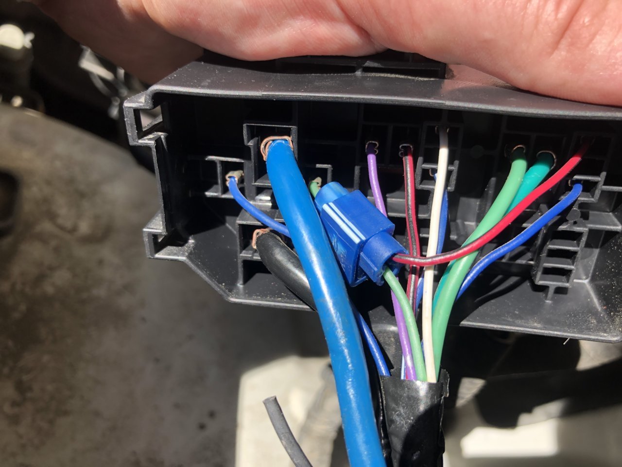

    Yup, when I find the time today/tomorrow I am going to test. Given I used a 14-18awg tap, someone else mentioned stock wire gauge is 20-22awg so I have some smaller taps ready to go. Possible the larger tap did not strip the insulation completely.

    ya nailed it as per usual, Caribe. I got it sorted.

    Excellent! Tape the tap in place so it wiggles less.

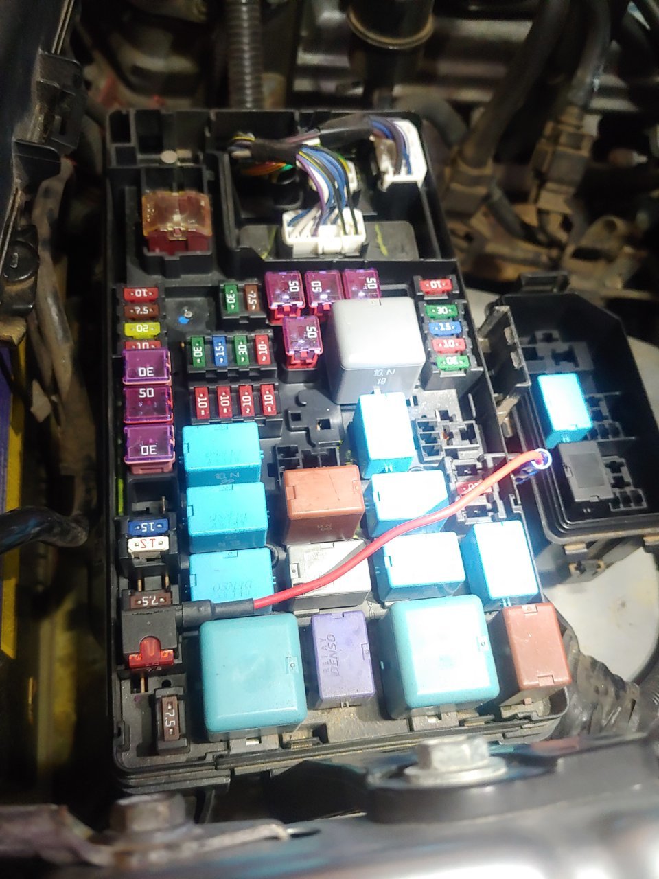

    Thanks for the write up! Since I didn't have the extra wiring from the seat heaters I used an add a circuit from the dome light fuse. If I can't remember to turn them off, I'll just use my jump pack.
