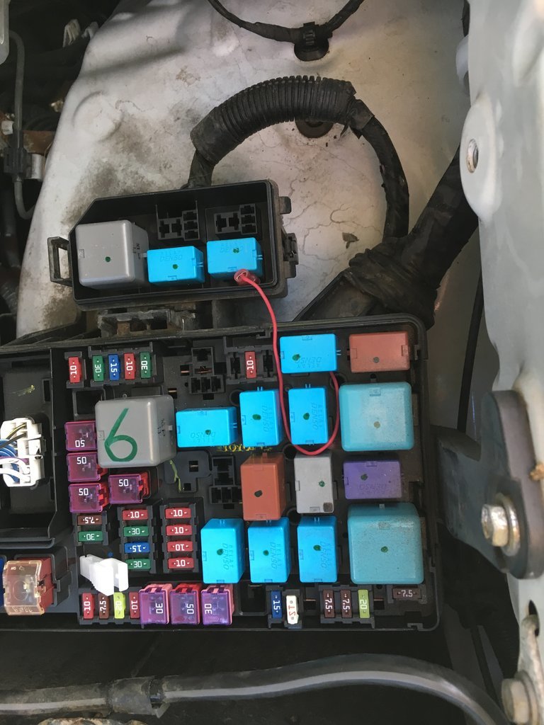

    Well boys, I did this on my '13 SR5. Of course I didn't read the entire thread and powered the air pump relay that's in the location where the fogs were up to '11. Now the check engine and trac off lights are on... On the plus side, I read the entire thread and wired it correctly. I'll scan for codes and check fuses to see what went wrong. Hopefully just clearing the codes will do the trick... I'll post what I find.
  5. Jun 12, 2017 at 3:10 PM
    #405
    vssman
    vssman Rocket Engineer
    Jun 17, 2013
    #106440
    10,566
    Paul
    Naugatuck, CT
    2013 SR5 double cab
    No issue, after the third restart, the light went out. Didn't get to have the codes read prior to the lights going out. All is good...

    I did the same thing, then put everything back, ran the truck, and then did it the right way, all lights cleared, works as it should from the factory now in my opinion. But now, just to route the jumper a bit nicer, And thank you guys for the tip! IMG_2375.jpg

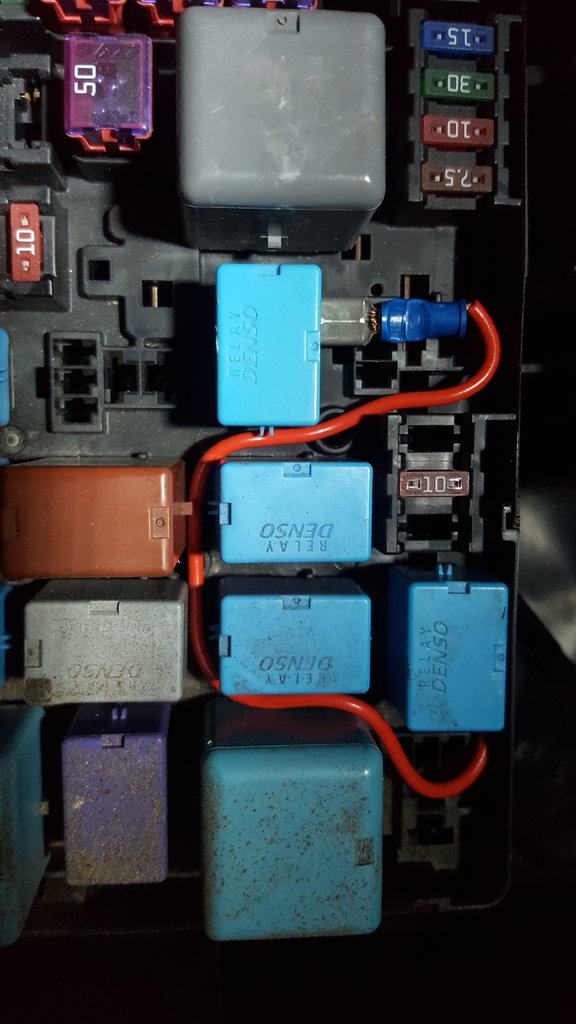

    I have just purchased a used 2011 Tacoma SR5 V6 4X4. I did the fog light mod, and yes I have read almost all 21 pages of this thread. The mod mostly works. I can now turn my fog lights on with parking and high beam, but I can also turn them on with no lights on at all. What did I do wrong?
    Edit:
    So I just checked again and I can turn on my fogs or headlights without the key in the ignition. Is it supposed to be this way? I would like my fogs to only come on when I turn on the parking lights, then the headlights.
    Any help appreciated. Attached pic. I think I did it correctly.
